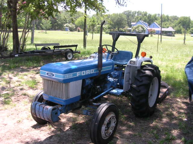

Guy at work just put this one up for sale today pauls 1910.JPG Im pretty sure he said $4500....
I have more pics if interested just got them uploaded. It has(1600hrs)
   / Bought 9ac; What size used tractor do I need? #7
I have a JD870 for my 9 acres. Similar to the Ford 1910. You do not pull cedar stumps with a tractor this size unless the stump were cut 10 years ago. I grub out roots and it takes me a 1/2 hour or so to get a cedar root ball out. As others mentioned either Mother Time or bigger equipment to dig out a lot of cedar stumps. My land is relatively flat so 2wd is ok. Occasionally I want to see 4wd when moving compost.
