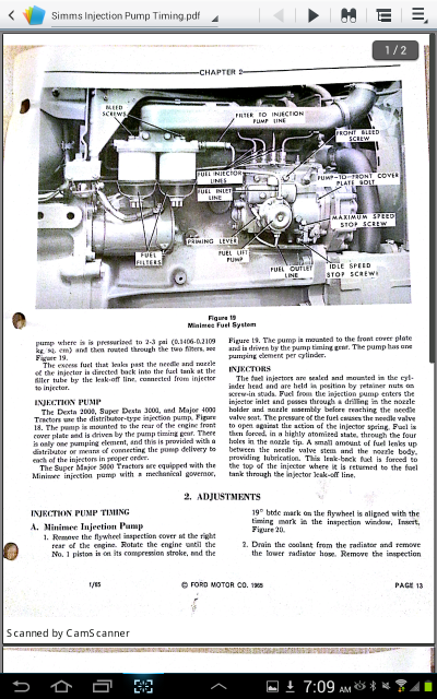

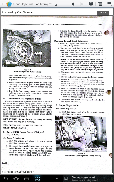

Got the pump put back together but not sure on the timing could anybody explain it ti me.
   / Bought a Ford 3500 #10
Timing for Simms pump
