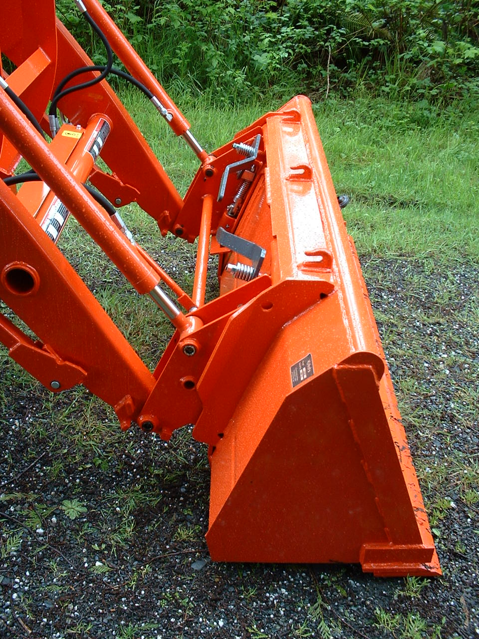

Does anyone have any pictures of a bucket with a bolt on edge? Thanks
   / Bought a new Kubota bucket today, bolt on edge or not #10
Here are a couple of pictures of a bucket with bolt on cutting edge. This is members herefromthere bucket. Don't know if they are close up enough for what you want to see.
