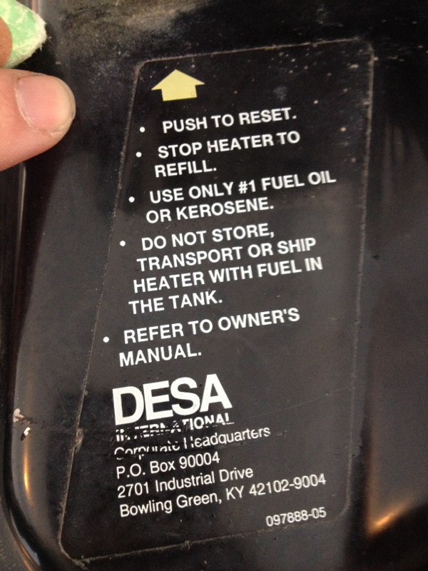

The fuel is red?? Says can use no 1 fuel oil or kerosene only. I have never seen dyed kerosene in this entire state. I know it exists. Is it possible someone filled it with off road diesel or fuel oil? Is that why the fumes are slightly stronger than kerosene should be? It's not too bad overall. I know the newer kerosene units burn cleaner than the older.
I plan to remove all the fuel and replace it with fresh kerosene. Than I will test it again and let you guys know
   / Bought a used forced air/ salamander heater
Wow!!! I changed it to kerosene from the pump!! Smell and headaches are gone. It had nothing but number 2 fuel oil or dyed diesel fuel. What a change

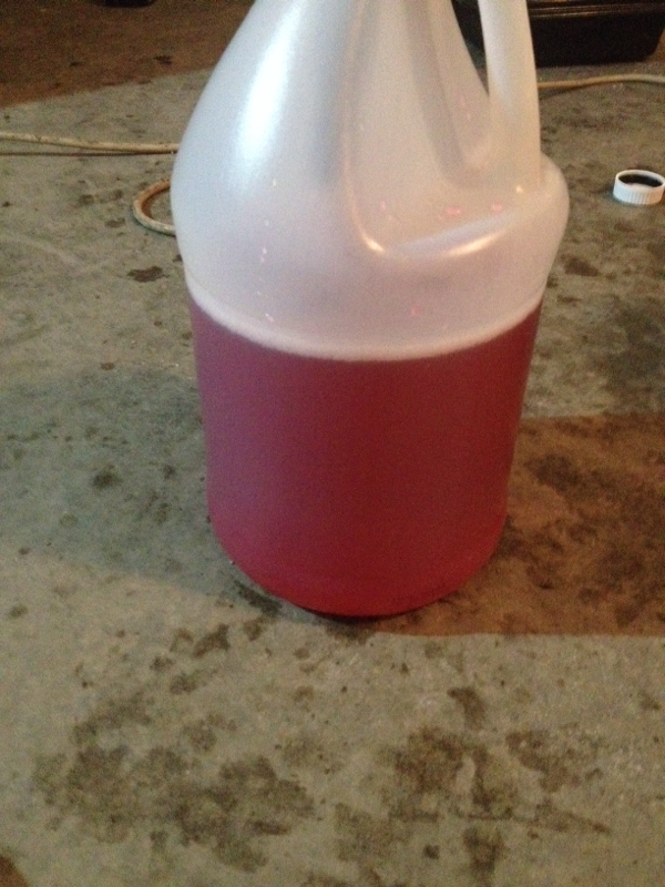

This is the mystery fluid I removed from the salamander I bought !! I have a feeling it's HHO or off road diesel. I never have seen dyed kerosene in this state.

Here in Michigan Off road diesel is red. On-road is greenish yellow and store bought kerosene can be clear or yellow. If you don't like the smell, go to lamp oil (gardenia, rose, banana, cherry blossom or dog butt).
