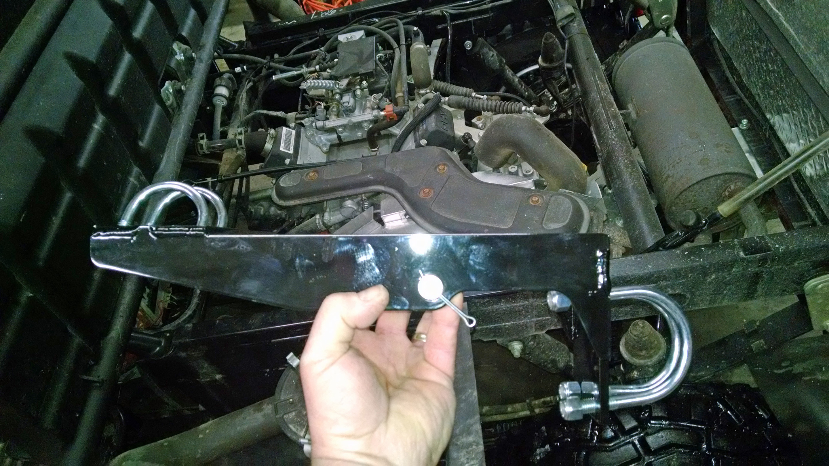

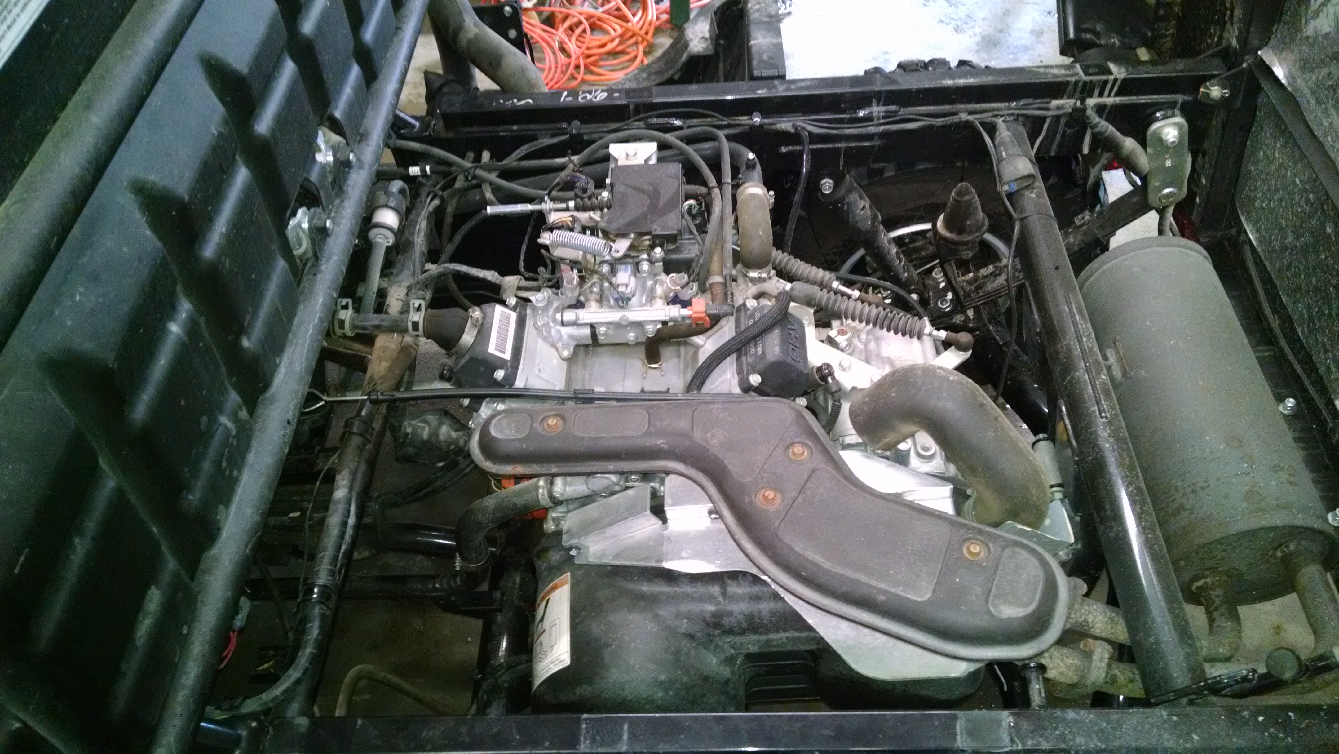

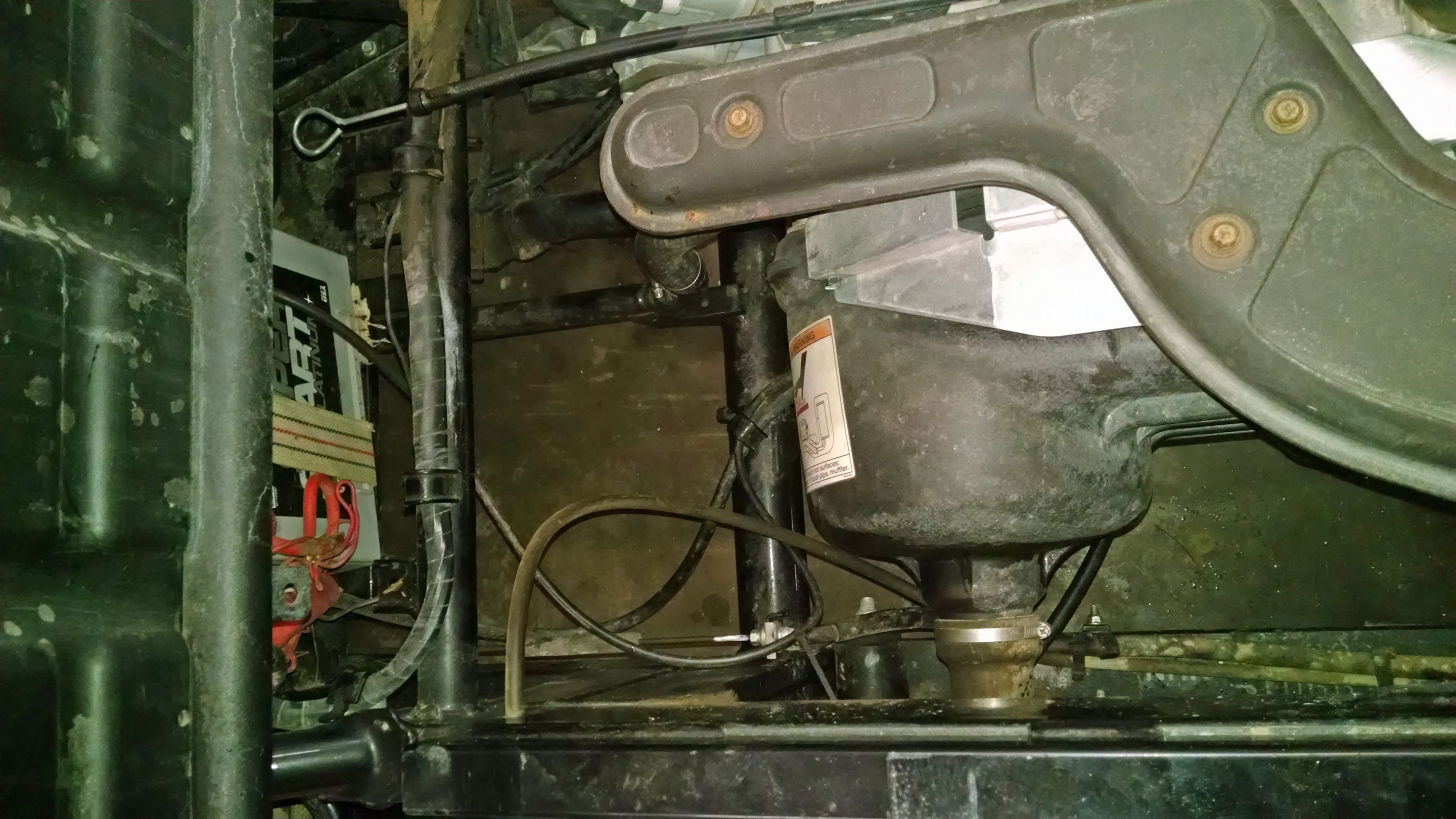

Heres a few pics of lift install if anyone else is wondering about these lifts.

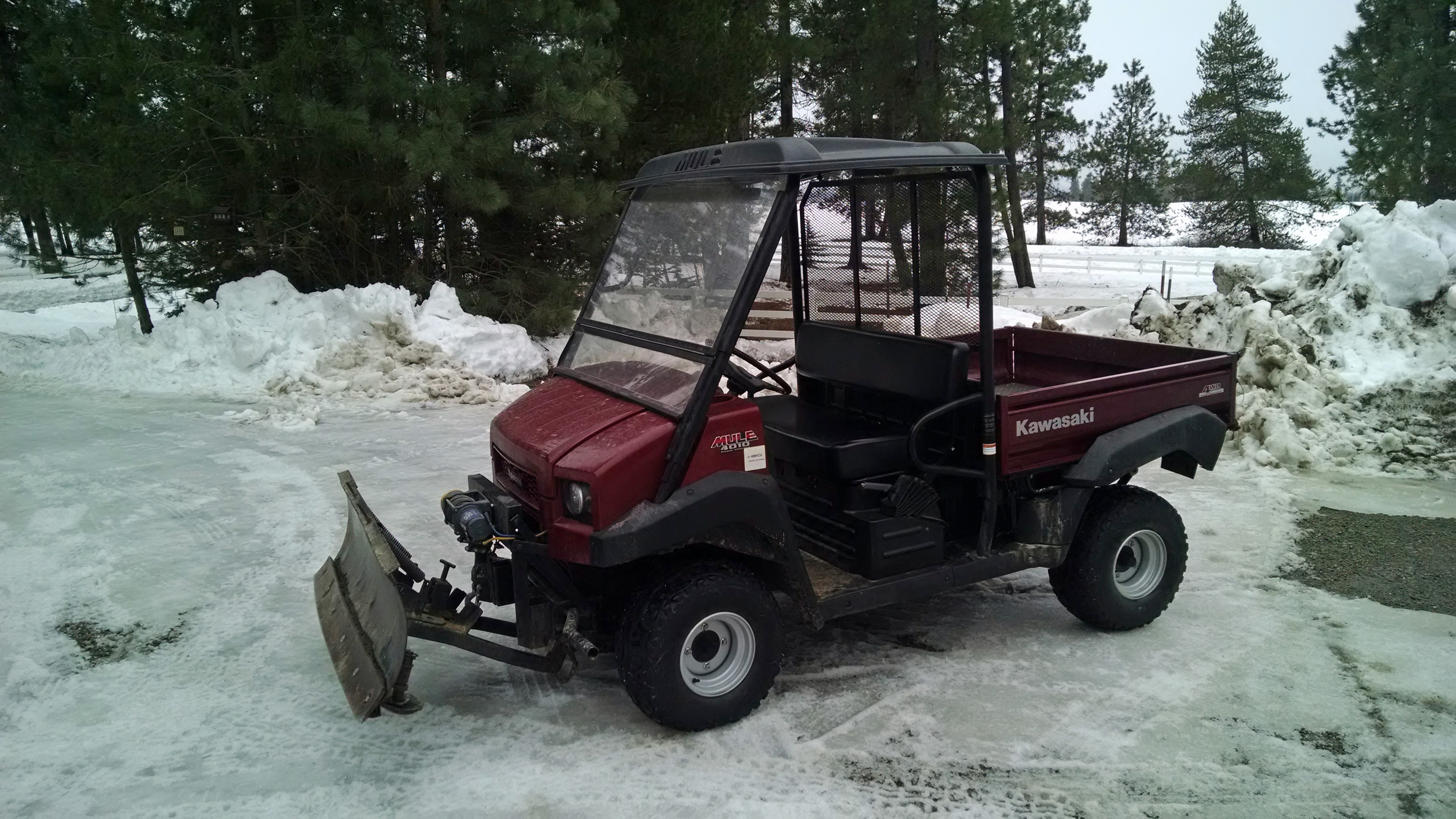

mule.jpg Heres the cart. Was real clean when i went to look at it, boy its dirty now. wet snow and dirt mixed. Body is clean. Engine taken care of by mechanic. Very low hours.

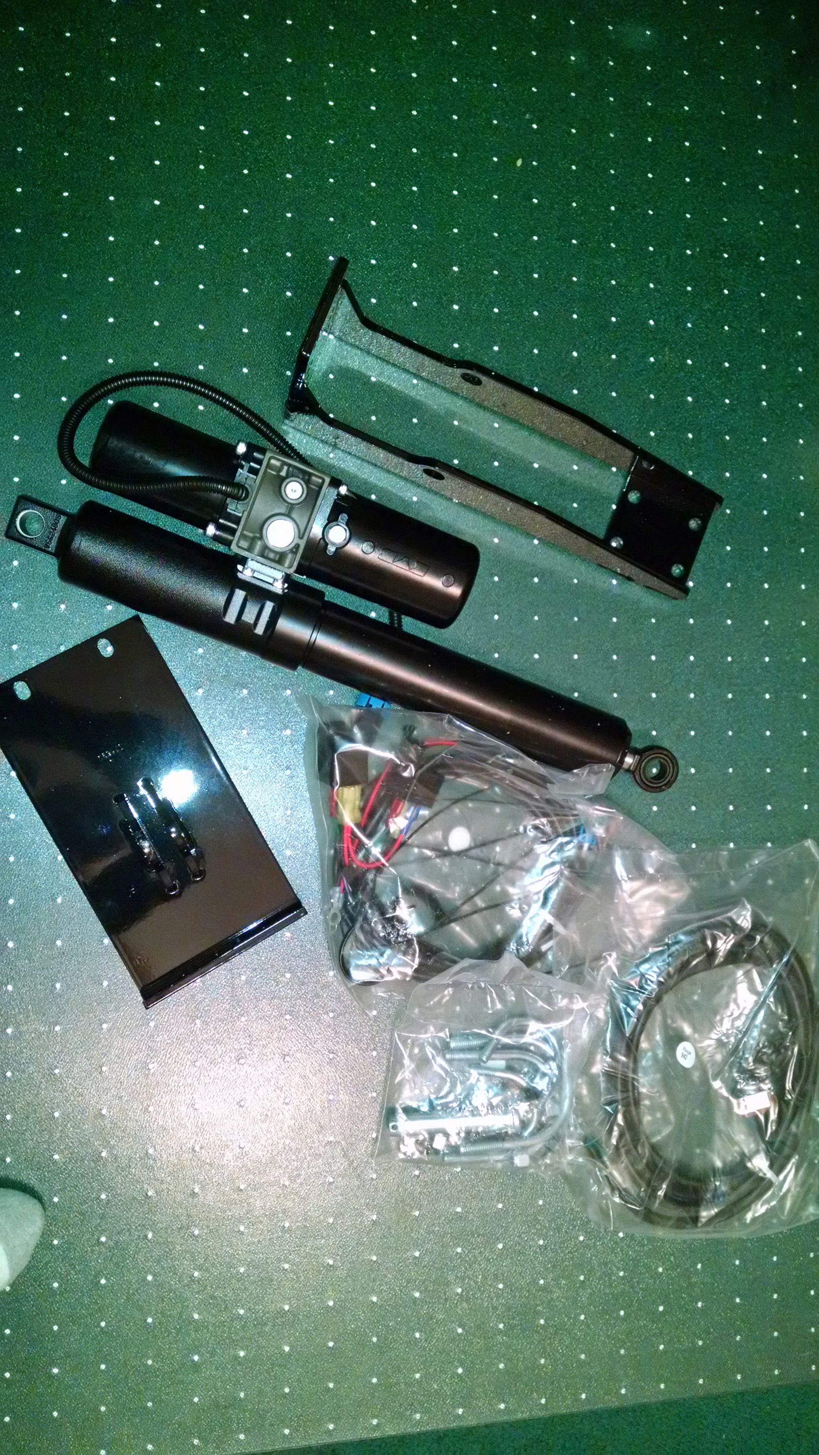

lift kit 1.jpg This is the kit. i got it thru amizon
IMG_20170220_132941629.jpg Theres alot of parts to this thing. The club car its replacing was empty compared to this
   / Bought a used Kawasaki Mule 4010 and added a bed lift kit
#2

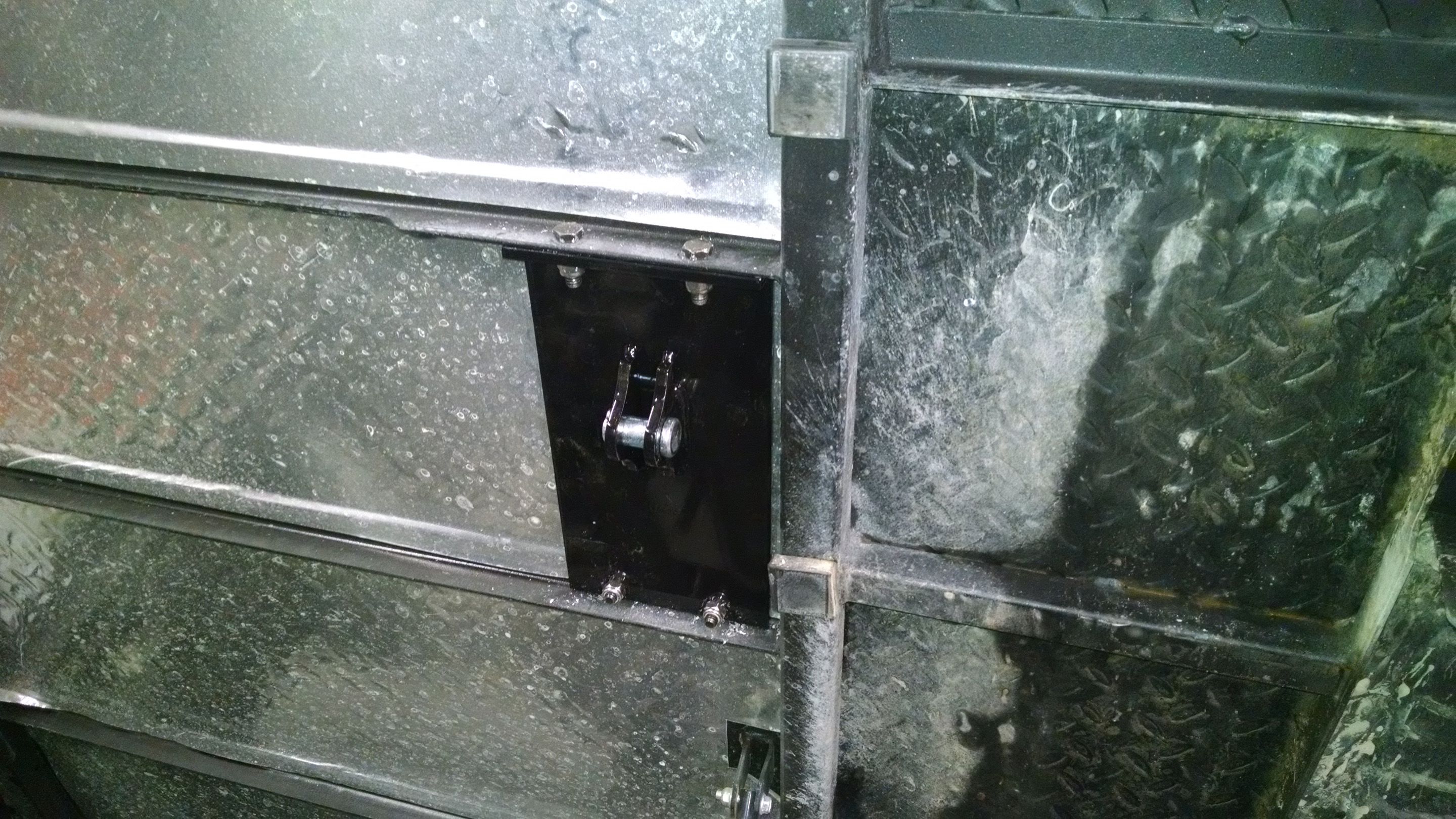

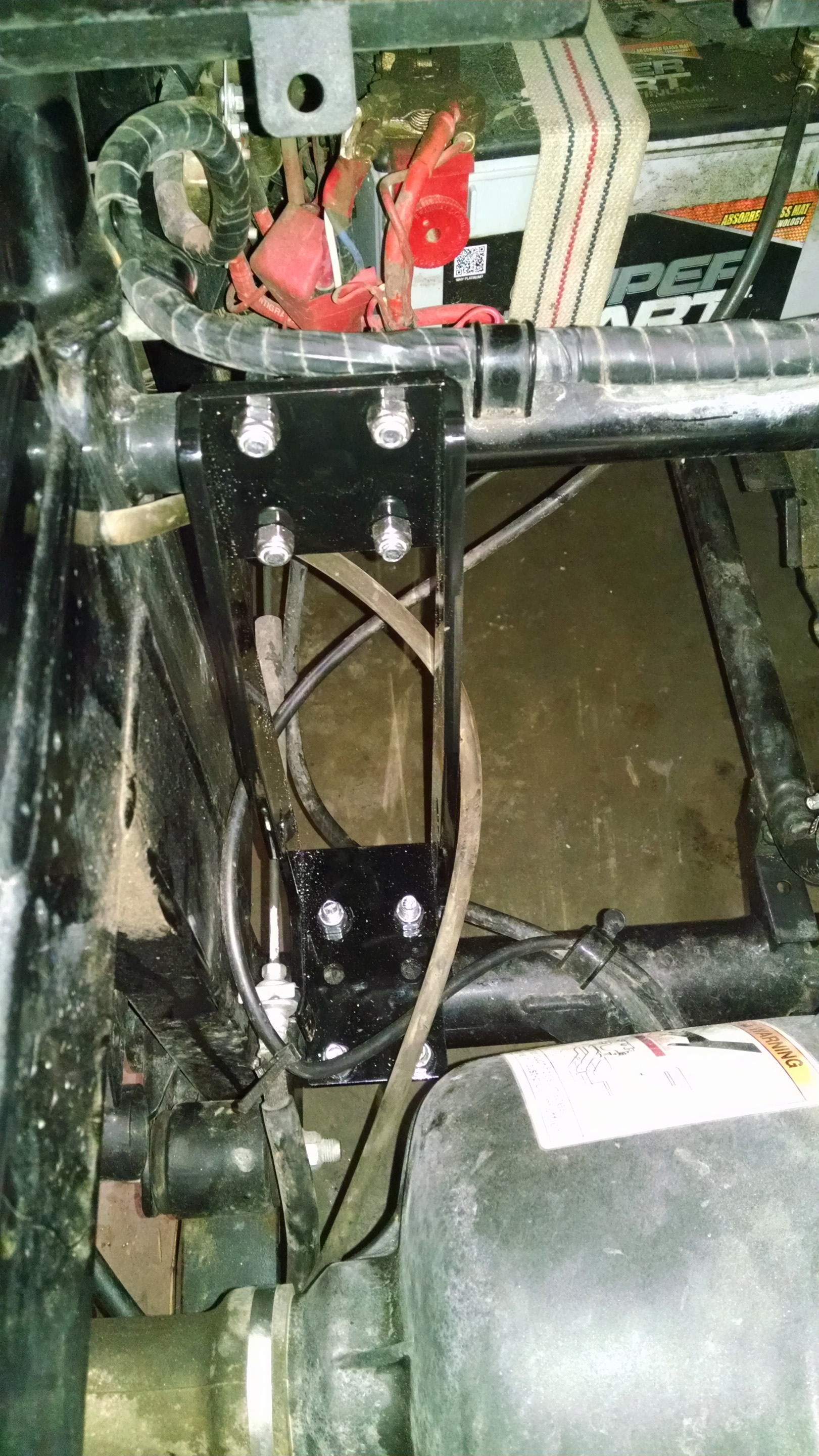

top plate.jpg This is the top plate mounted. 4 bolts.
where it will mount.jpg Where it will mount
mount bracket.jpg This is the bolting assembly prior to install
bracket mounted.jpg This is the bottom plate. easily mounted with 4 u bolts

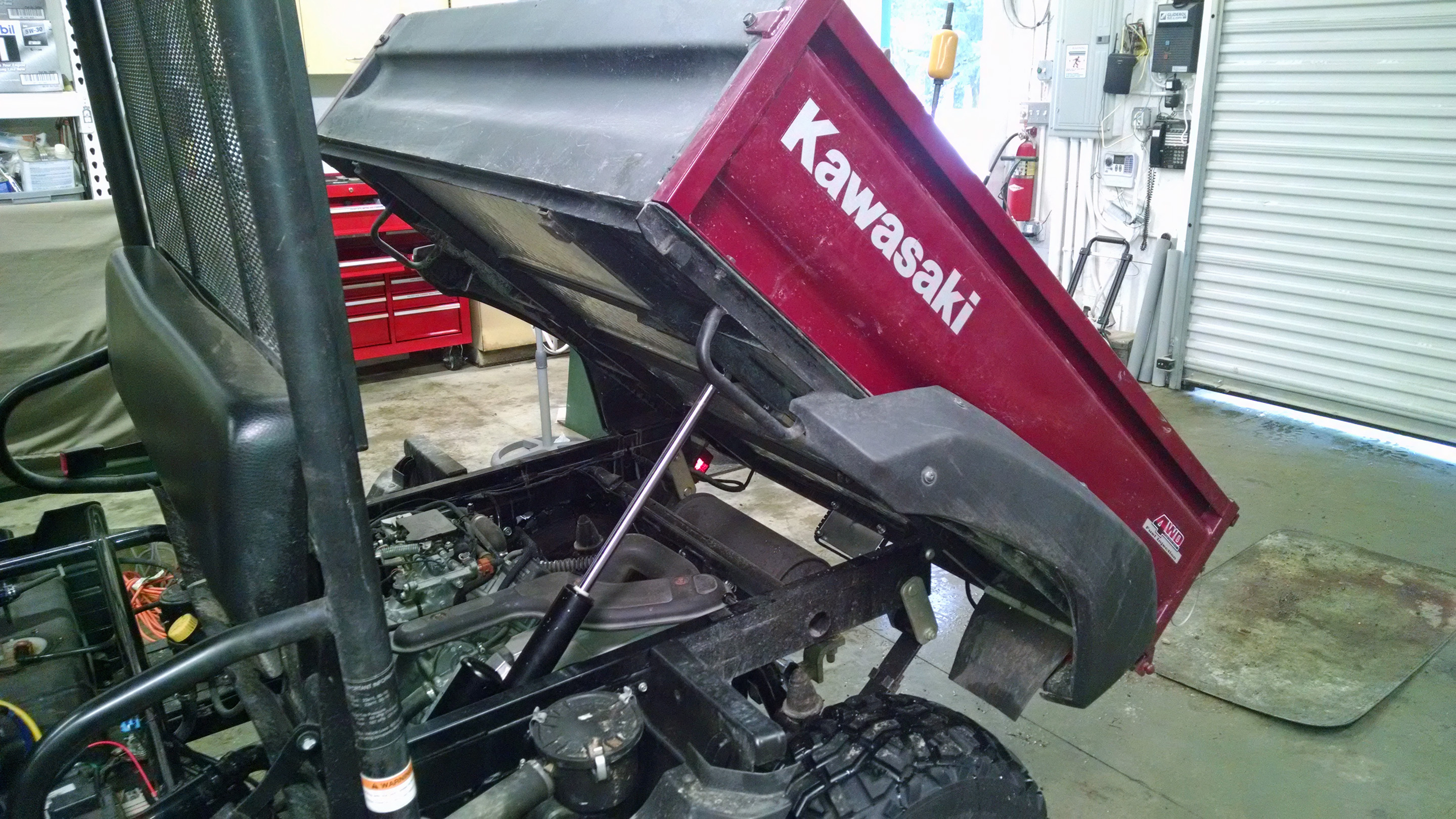

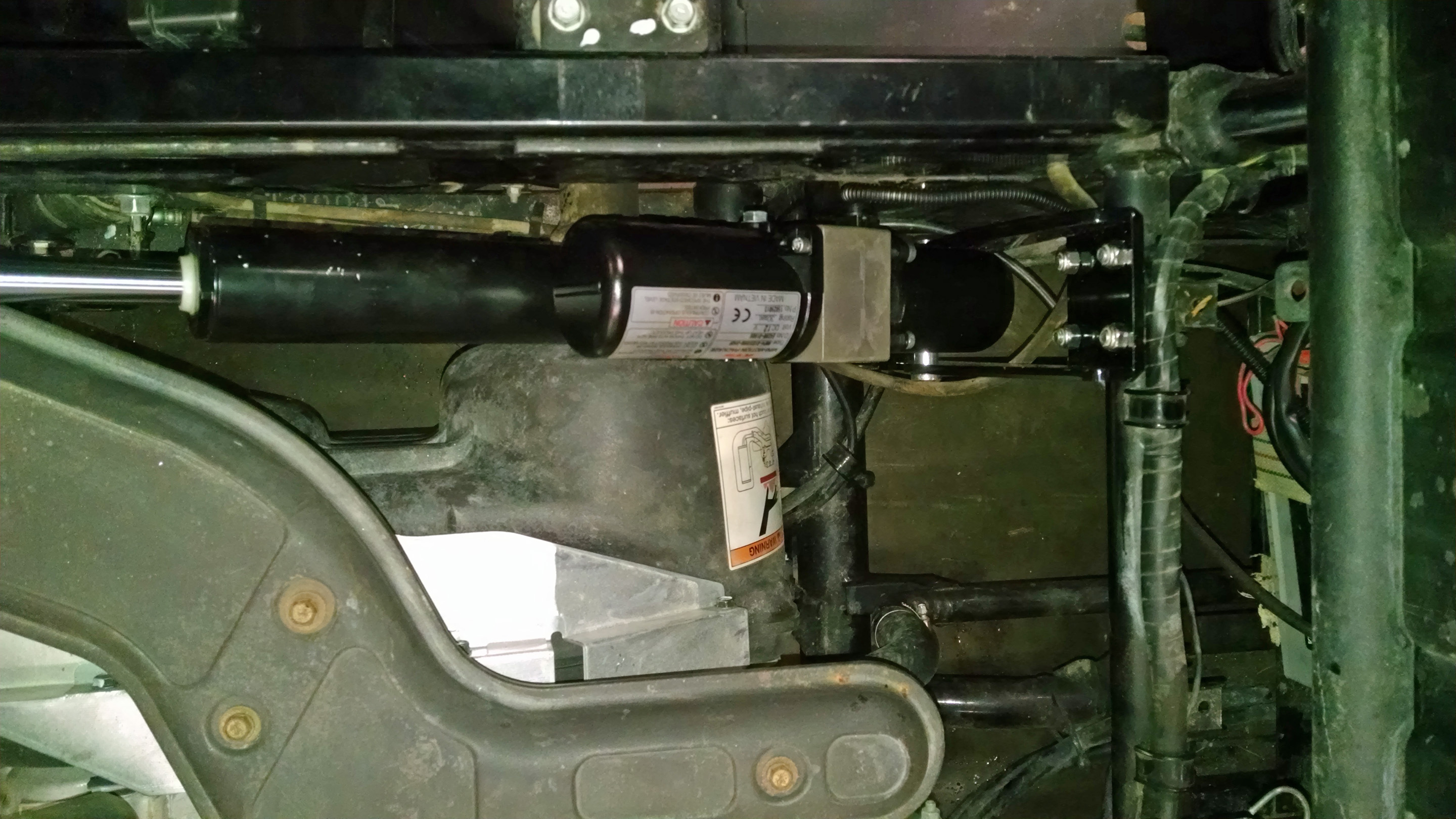

ram 1.jpg This is the ram installed
bed lifted.jpg All done. The electrical was real easy. they gave relays with rack mount plates. the floorboard is removable and Kawasaki already had a harness under the dash to power up the switch. The battery has screw ports to add the circuits. It came with dash switch. Was a breeze to install.

I hope you did OK. I would never buy a truck that had been used for plowing and certainly not a UTV unless it was hydro.
I too installed the lift on my 2510. Kind of a fun job when everything is engineered and all the parts are included.
But it won't lift squat. Not a good load of elm firewood, and that's not piled high and tied down, as there is only so much you can pile on before you start loosing pieces.
How is your for lifting capacity?
I filled entire box with wet manure, and it dumped fine. I checked entire frame for damage. Theres none. Unit starts and runs great. Compression test perfect. Oil is clean. He had all maint records. Unit is a gem. I ran it thru my woods which were covered in snow before i blew out a path. Never got stuck. Im real impressed with this machine
