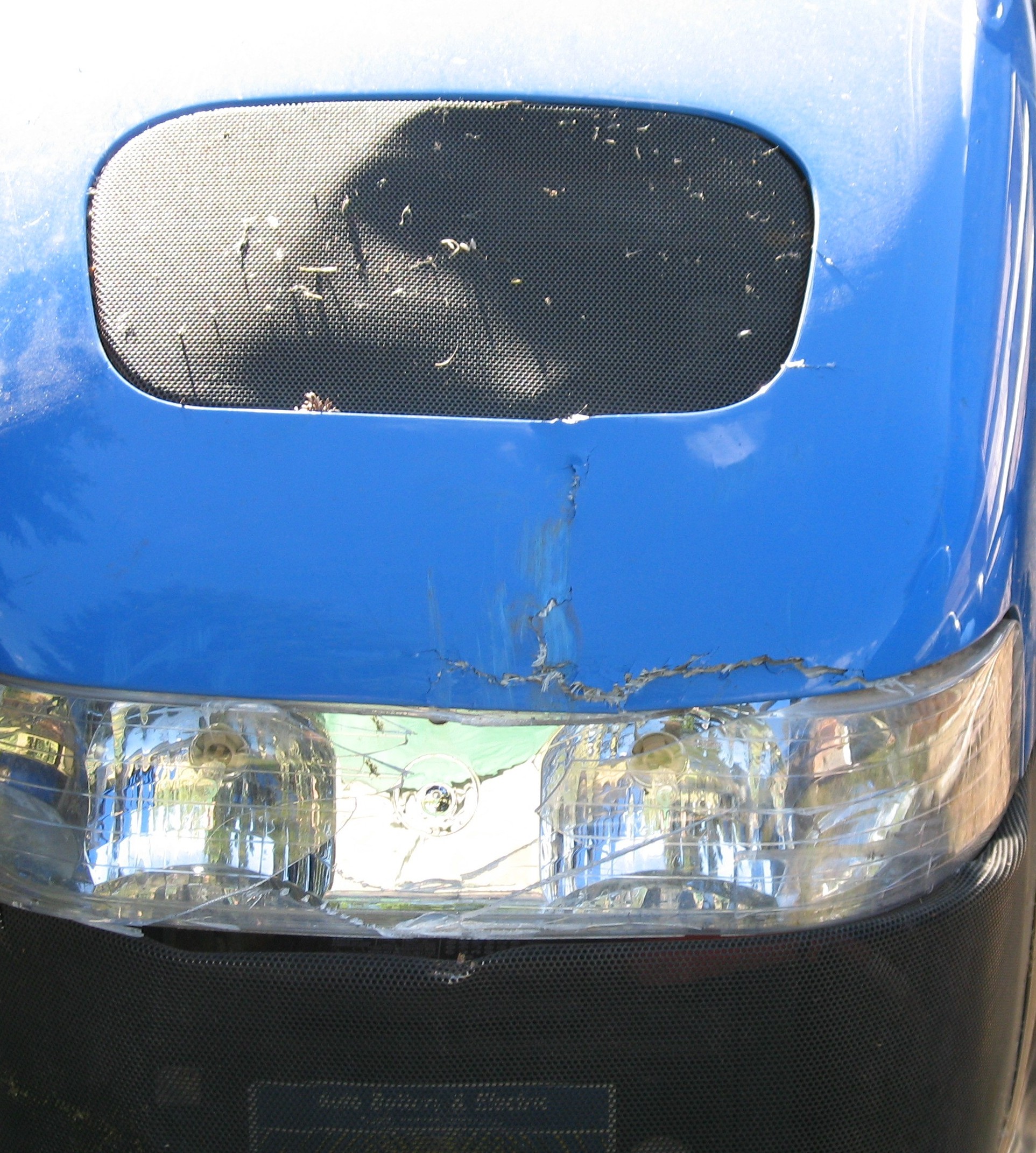

I was finishing up the day today and lost a little focus...a stump twisted out of my grapple, landed on a root and fell right into my hood/headlight assembly.
I have about a 4" cut in the fiberglass, both screens are bent, and the headlight cover is shattered. I beat thing back into shape, and figure I'll fix it after I complete my clean-up/land clearing project.
Any ideas on how much a hood costs? For some reason, the pictures won't upload....

close-up picture of the damage...
Ouch! I think that hood assembly will set you back $600 or more. For that kind of money, I think I'd just take the hood by a body shop and see if they might be able to repair it for less. Good luck...stuff happens.
   / Bound to Happen... #6
The FG is deffinately repairable.. I'd try to form the screens back out.. trim up the damaged FG.. and then re glass it.. sand it.. contour glaze / putty if needed.. then prime/paint. If you take a bit of time you can get the hood looking OEm again... at least from the outside. Just add a new lamp lense and formt he screens as best you can.. and go... She is a tractor after all.
I didn't have a chance to call the dealer today, but will tomorrow afternoon. I know a couple folks in the body repair industry...I'll give them a holler too...didn't think of it!
Thanks

Nasty hood hit :(! The hood and the headlight lensecover will definately set you back some $ :eek: :( :(. I do not remember your model except that it is bigger than mine- there was a NH grill cover option for the "29" that I installed and so far it has saved my grill once :). After pulling some dying mini-dwarf fruit trees this weekend I am going to modify my grill with some kind of mesh in order to minimize branch "kickback". Sorry about your damage. Good luck on the repair. Jay
I got some mashed up screens, crumpled fenders and canopy lip on my 7610s... just adds character!
Soundguy
I've reformed the screens...pretty well for not removing....I think that I'll get them pretty darn close w/ a little time. The hood is different than anything I've attempted, but may give it a shot..it'll depend on the body shop estimate.
