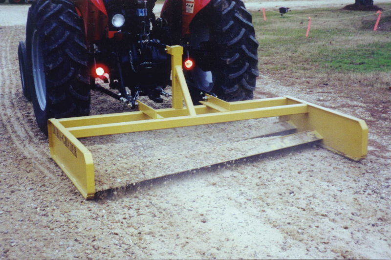

I am sure most of you are getting sick of answering this question, but I will ask it anyway. I have decided that I want to remove my sub frame backhoe when it is not needed and know that i want and need to replace tha rear counter weight that it provided me.
I could construct or buy a weight box, but common sense and yankee frugality tells me to have a rear weight that servers a multiple purpose. So, I am thinking box blade or a rear blade, in the 6' range for my JD 950, 27 HP. to be replaced someday with a TC35D.
What have all of you found th be the better choice of the two, for general grading use and for it's counter weight abilitys ?
In the area of Box Blades, I am aware of the most common design that I seem to see everywhere, but I stumbled accross this design in the recent copy of the "Equipment Today" magazine. It is made by a company called Roadrunner at www.roadrunner.com. (Photo Attached ) It's design is interesting and I have sent for there FREE video. The one downside I can see is it's length compared to a normal box blade would make it less manuverable in tight quarters.
Any ideas, advice or suggestion would be most appreciated.

Here is another picture of it from there website, being used.
I know nothing yet about it's weight or cost.

I've seen those and think they'd be great for grading / smoothing a drive - but seems limited to just that - I do a lot more heavy stuff with my box blade so this just wouldn't do.

mikim, I rather like the design of this in the respect that it appears very easy to modify if one wanted to increase the weight. But I do have to agree with you. Although I have Never used a box blade, I can see from there designs that a regular style would be more versatile.
Other then smoothing my own driveway and possibly a little light work on some of the dirt roads in the development that I do work for. I don't really know what all I would want / need one for at this stage in my life / business.
Please keep the reply's comming, my ears and eyes are open and in need of an education. "Feed Me"

   / Box Blade Choices #8
Mark,
The Roadrunner has been mentioned in the past on the forum and is designed to grade and pull gravel back to the surface in the process. I also remember it being pretty pricey. A box blade has the ability to hold dirt----in the box----and release it where you want. This allows you to cut down the high points and fill the low points as you work a piece of ground. The other advantage to the traditional box blade is the scarifiers that let you break up harder soil to make it workable. The general consensus is to buy the heaviest one you can afford. This not only makes for durability but also the extra weight makes the box blade more affective at cutting the surface. You may want to consider a 5’ model for your size tractor. When a box is full of soil or stone it can get pretty heavy to pull. A search for box blades will give you tons of reading.
