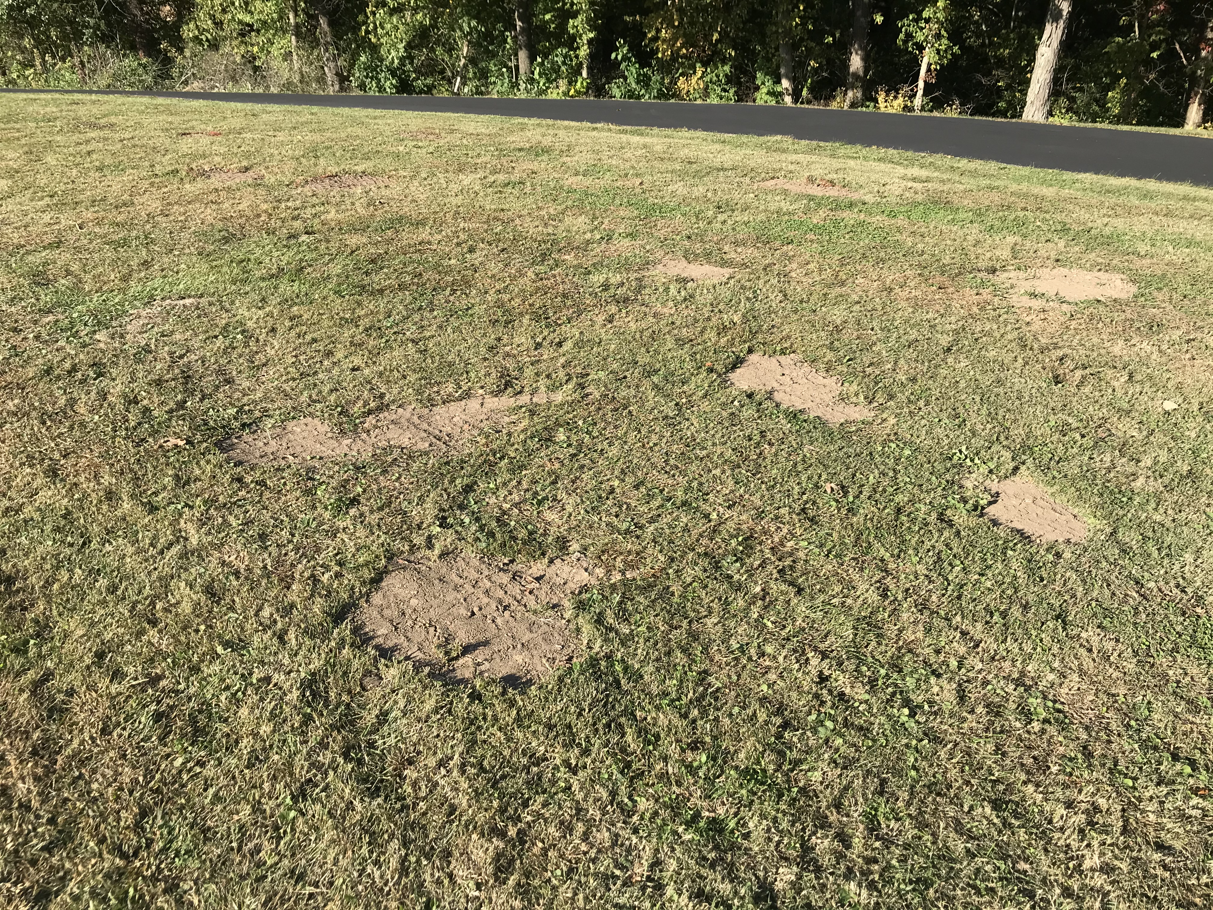

I started filling in some of the low spots, they are pretty hard to identify. I cut the grass short and rolled the area also. I am probably not going to be happy with it but do not really want to till it up and start over. In the pic the bare spots are what I filled in low areas. They look high in the pics but aren’t. The problem is I will probably only fix about half of the bumps if I am lucky.
