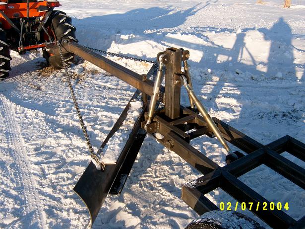

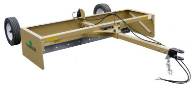

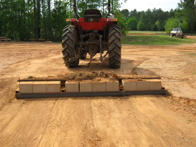

Have the 6 other residences pitch in and buy one of these or similar if you don't like KK stuff. I don't think you can angle your box blade the way you mentioned (of course, somebody on here has probably managed to do that somehow)...
   / ?Box Blade Mod? #4
