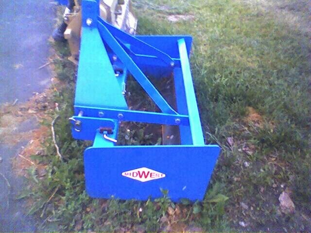

The first Box Blade is one of my MIDWEST EQUIPMENT blade. This photo shows the side. Midwest is the only company I know that makes
a trapazoid shaped side plate with the bottom edge sloping upward from the back to the front. I like this feature as it allows for the blade to be tilted forward without the side plate digging into the ground, most other brands just have the corner cut back about 2" or 3".

Here is another view of the Midwest blade. Notice how many attachment points hold the "A" frame to the blade (8 points), also notice that the lower link pins are the captured type.
The rear of the blade is CURVED. Several brands had straight back panels.
Midwest makes blades for several implement dealers under their private name (Corrihier is one of those) and they also make blades for Kioti.

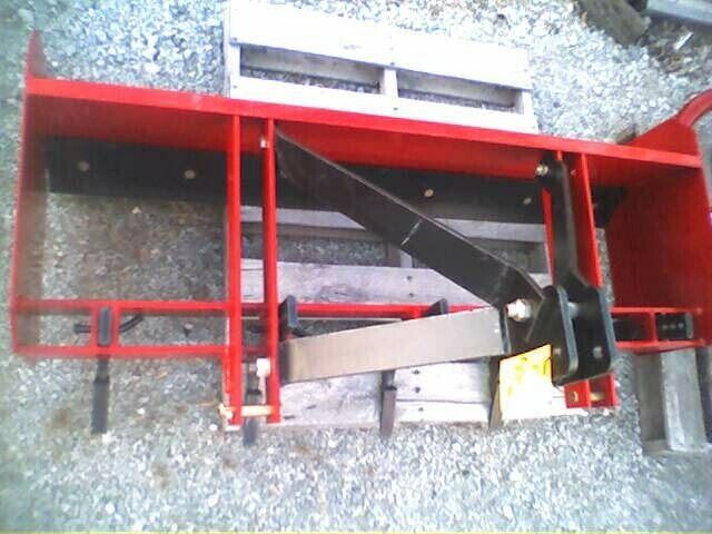

Here is a BUHLER blade. This is a nice heavy blade. Side plates are rectangles with cut leading corners. The scarifiers are held between 2 pieces of flat steel instead of in a square tube. Scarifier adjustments are easy to do without tools with gloves. One nice thing is that the lower link pins are the captured type and the reinforcement goes all the way to the back of the blade.

   / BOX BLADE :: PHOTO comparision of brands

This is a very well made blade and was priced lower than some of the other brands. The A frame assembly was VERY heavy steel. The back plate was a flat plate.

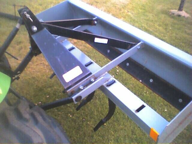

Here is a Hiniker blade. This is an American made unit. It has a curved back blade, just like the Midwest blade. It has an odd clip that holds the scarifier teeth in place. I could not adjust the teeth by hand without a pliers. This is a heavy blade but I didn't like the scarifier lock arrangement.
Another shot of the Hiniker. Notice the side plates use the cut corners.

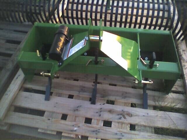

Here is a Frontier blade. This is a 48" blade but it only has 3 scarifier teeth??? It was lighter built than some of the others. I wonder if this model is designed for the Sub CUT size John Deere 2210?
