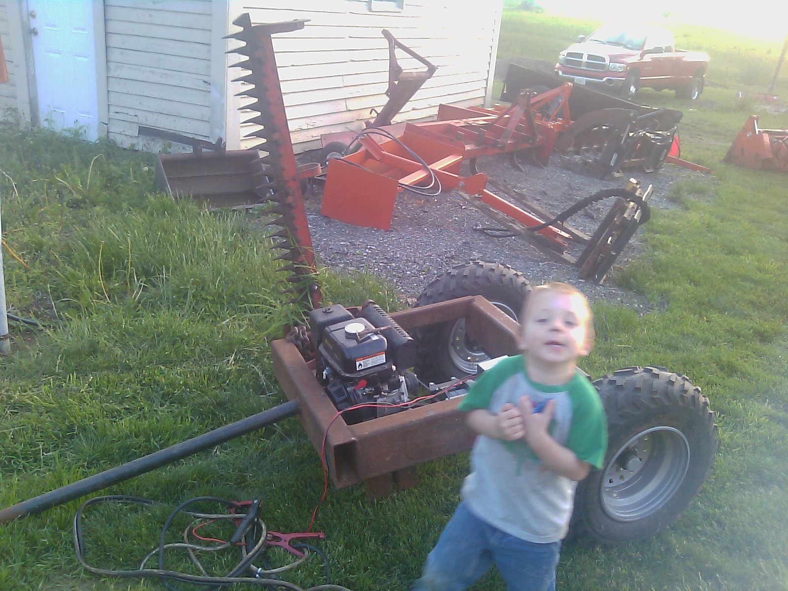

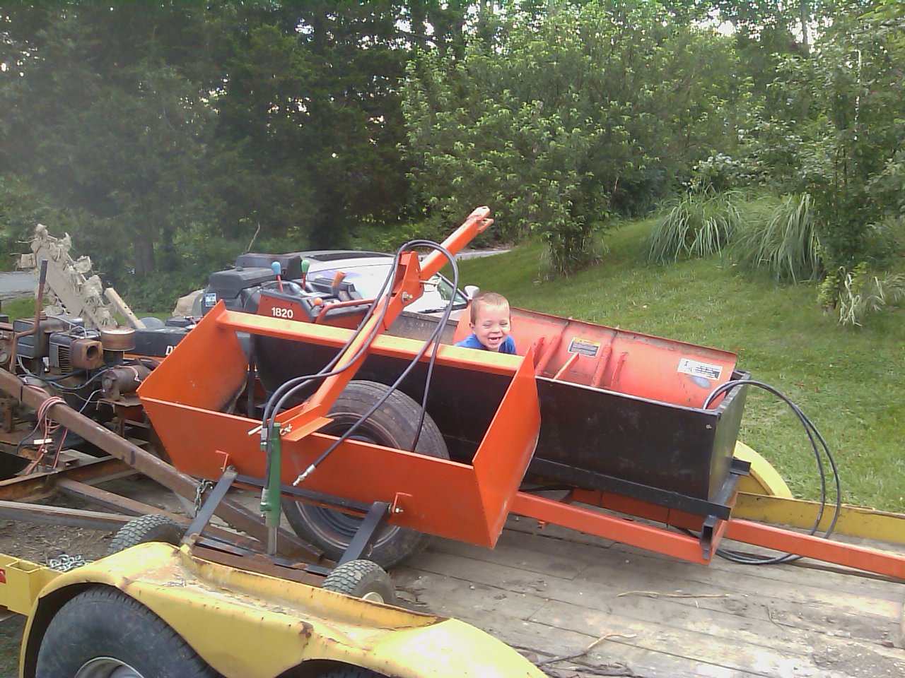

Here is what I built to use behind my ATV sorry for the bad photos but that is all I have on this computer. I use a 12v hydraulic pack mounted on the rear rack of the fourwheeler, which also works on my dump trailer in the second photo.
I made the tounge adjustable to adjust the angle on the box blade. It works real good on loose dirt and gravel on real hard stuff I hang a few tractor weights on it to get it to dig in.
added info
If I was doing it again I would go to TSC and buy a box blade and add the tounge are rear wheels as it may cost more but would make it a quicker build.
