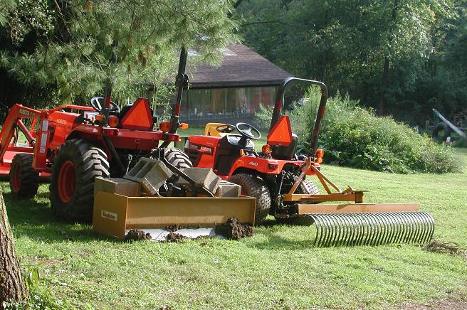

   / Box Blade - Rigid or Hinged? #4
If one does not try both, how could he conclude which is better?
I don't know...
I wanted a better box blade with a hinged rear blade, but I waited until it was too late and then my dealer could not get the one I wanted in time, and I ended up with a cheap KK box.
And it seems to work just fine...
And I don't see the need for a hinged rear blade now...
And I am pretty happy with what I have, even if I do have top put several hundred pounds of concrete blocks on it for extra weight, so it cuts better... /forums/images/graemlins/blush.gif
Seeing what I do now with the fixed rear blade...I don't think I have the need for a hinged one at extra cost.
Then again, I may just be dumb and happy, and working on the fat part... /forums/images/graemlins/smile.gif
