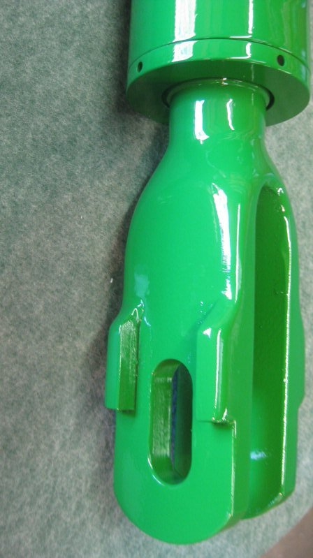

My TYM/Branson 2515H has two settings on the lower 3-point arms where you rotate a rectangular piece to one of two directions and it either enables the lower arms to float up and down with the terrain or to stay rigid. I hope I'm describing this so you can understand what I'm talking about. I don't know if all models of TYM tractors has this feature or not. Anyway, I was thinking that when hooking up my box blade I would want these set in the 'rigid' mode so the box blade doesn't float. If I'm trying to dig in with the blade to take out a high spot wouldn't it make sense to set it up this way? I'm a newbie to this in case you can't tell. :)

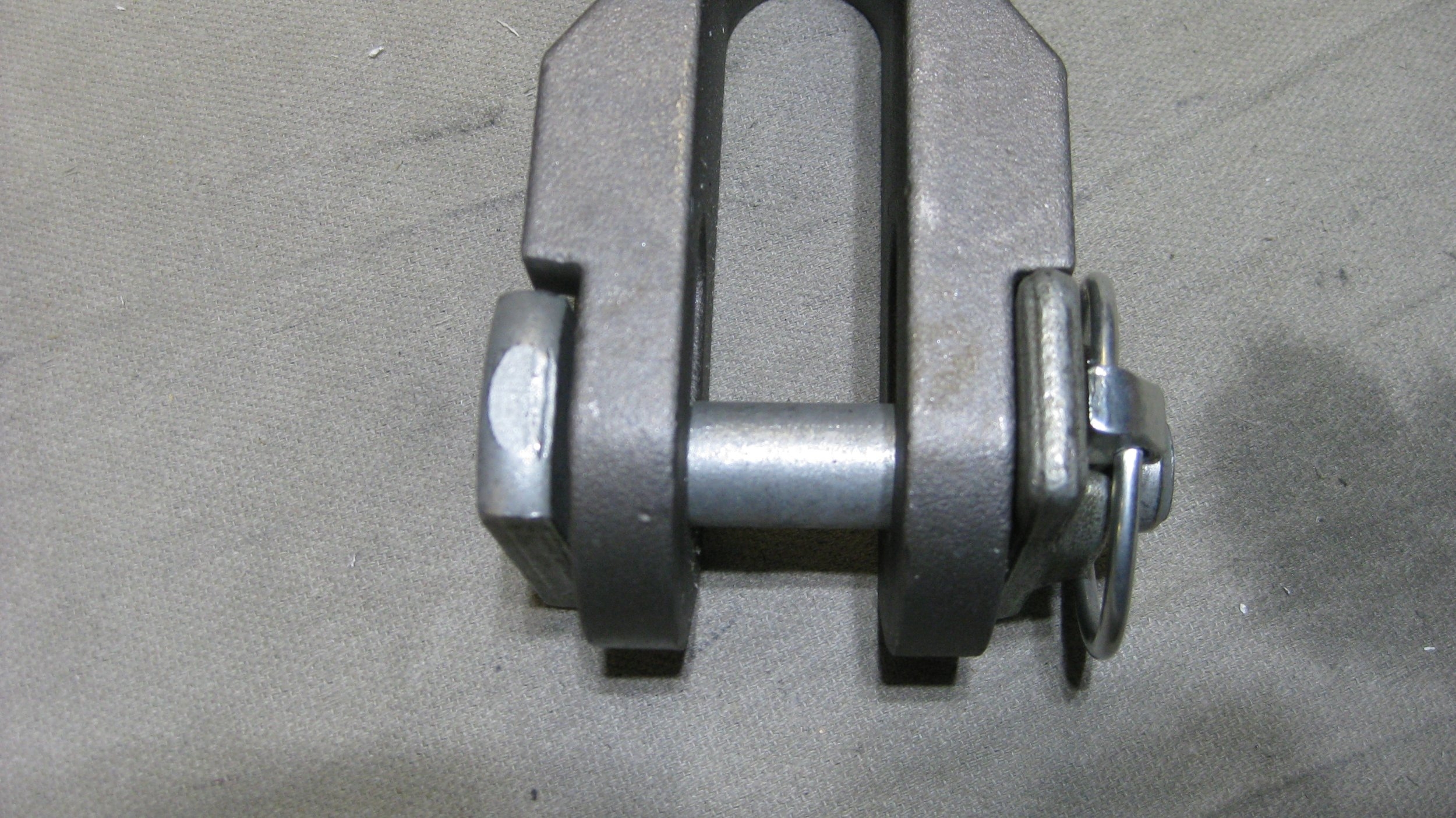

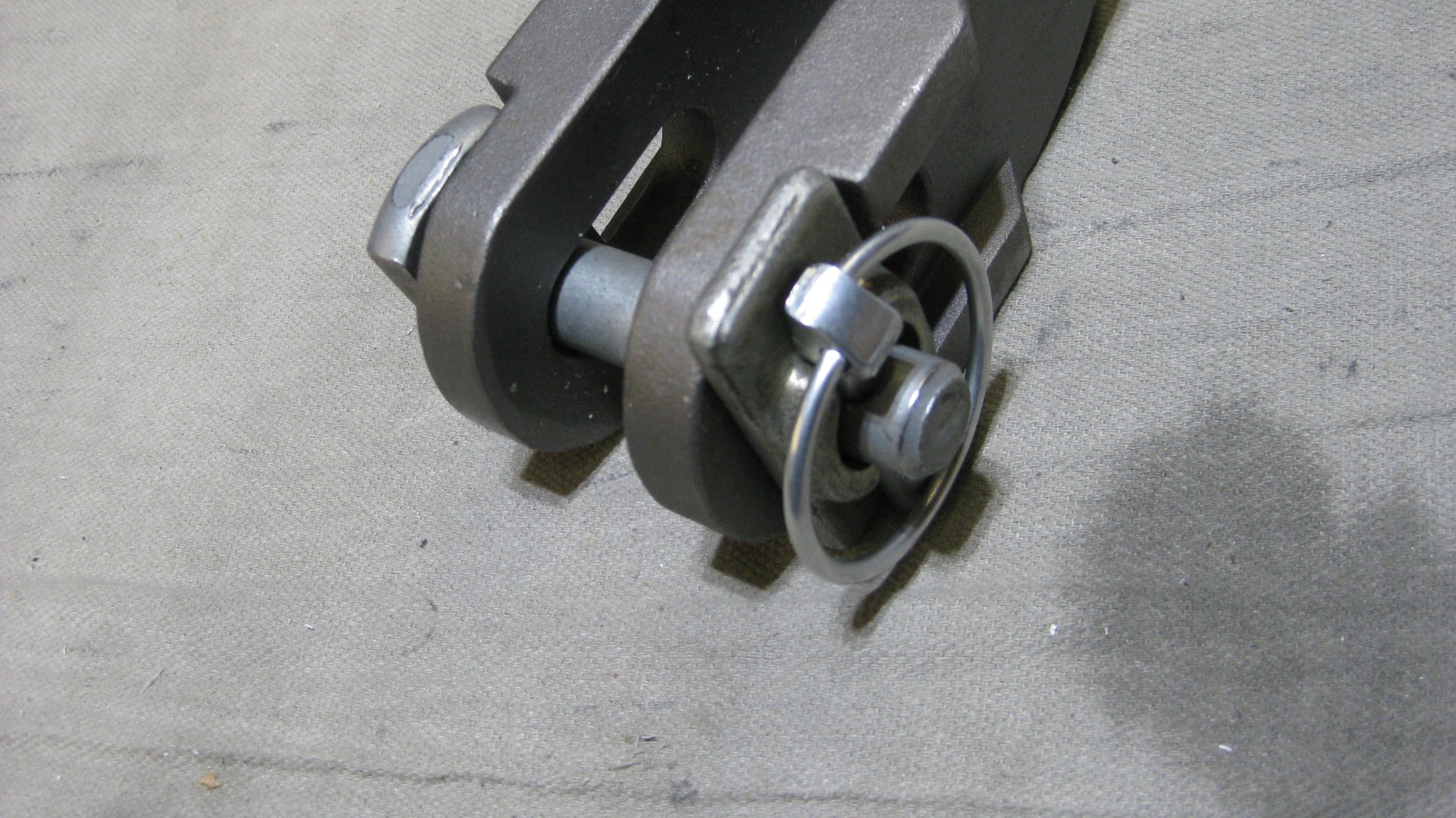

The OP is talking about the draft arms at the side link connections.
Not that the pictures are exactly like his, but they serve the same purpose. The slots allow for the implement to move up-down on the left-right independently of each other. To have the implement locked in place like a std set, you have the pin head turned horizontal to keep the pin locked down to the bottom of the slot-s.
For the OP, yes when cutting grade you want the pin locked in place at the bottom of the slot.

There are many places where this slot & guide feature can be a HUGE benifit. You just need to learn where and when to make use of it. Mowing with a 3pt mower is one of them as well as tilling and disking. Doing a final smoothing pass with about any type of grading implement. ;)

If I remember correctly the manual tells what they are for but doesn't mention what implements may benefit from either setting. I assumed the box blade should not float up and down but wanted input from more experienced users. When you say a 3 point mower would benefit, you are saying it would benefit from the float feature, correct? For those that mentioned the hydraulic top link, that is something on my wish list. I know they aren't terribly expensive so just need to get one sometime soon.
   / Box blade setup #8
Yes, in the float position. (vertical) This allows the mower to better follow the terrain, instead of the tractor vs leaving spots not mowed to the same height.
The more you use the feature and stop and actually think about what's happening, the more you will use it.
But for actually cutting grade, you want the pins locked down.
