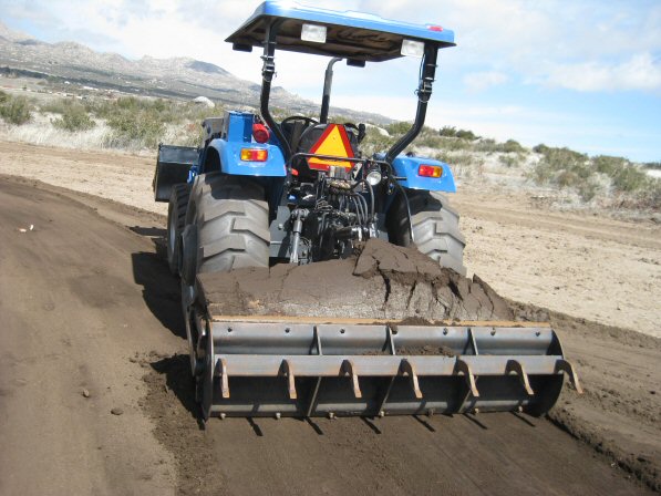

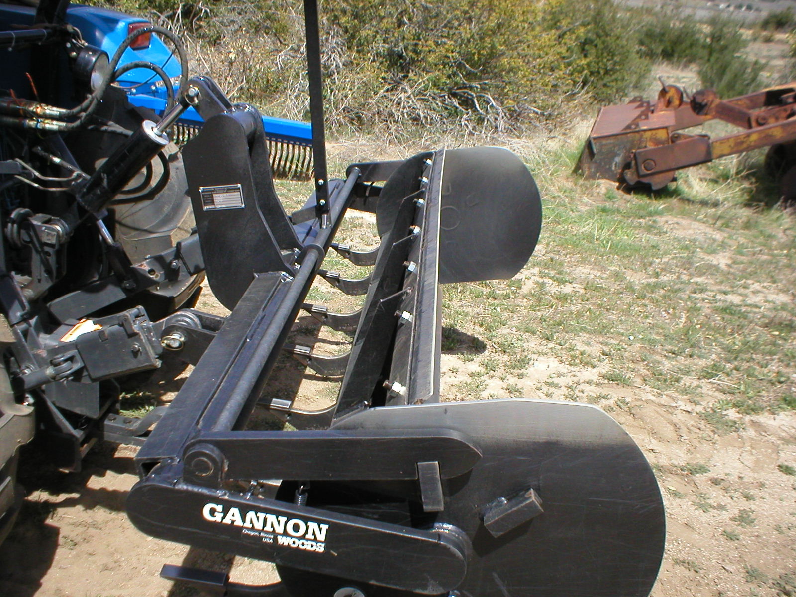

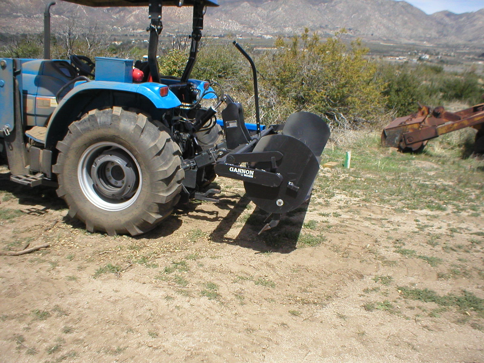

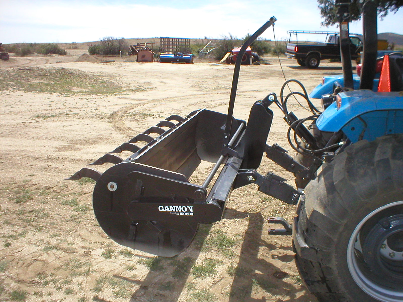

Roll over bob blades (ROBB) are great, especially because no hydraulics are required to get the rippers into the ground as well as not getting off the tractor and they are relatively heavy duty. I happen to have 3 of them, 36" for garden tractor, 65" for my 32hp tractor and an 81" for my 75hp tractor. All of mine are Gannons.
Contact a Dirt Dog dealer to find out. My guess would be $1500-$1800 though. :(

Man that thing is cool!
