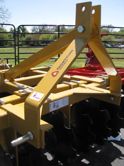

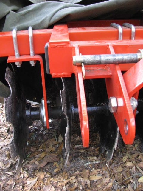

Make sure the box blade that you get has a strong set up for the 3 point lower hitch pins.
You want the heavier built box blade that captures each pin between 2 metal flanges. Your lower lift arms go between them and then a pin slides through. This is a robust set up which will endure many years of abuse.
Technically, this pin-between-two-ears is described as a Clevis hitch, and I entirely agree with your advice.
Photo #1/Orange CLEVIS HITCH (Disc Harrow)
Photo #2/Yellow NON-CLEVIS HITCH (Disc Harrow)
