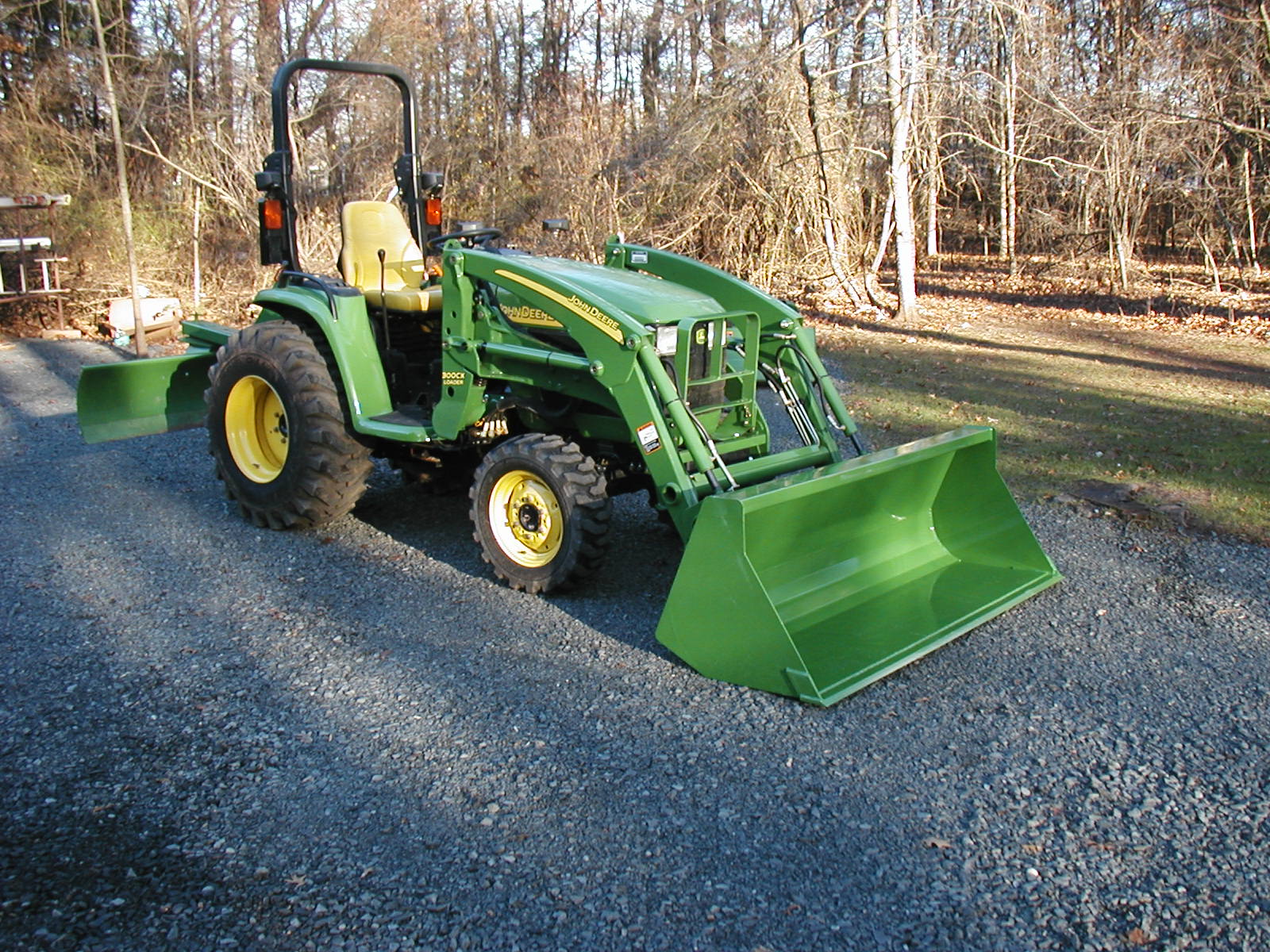

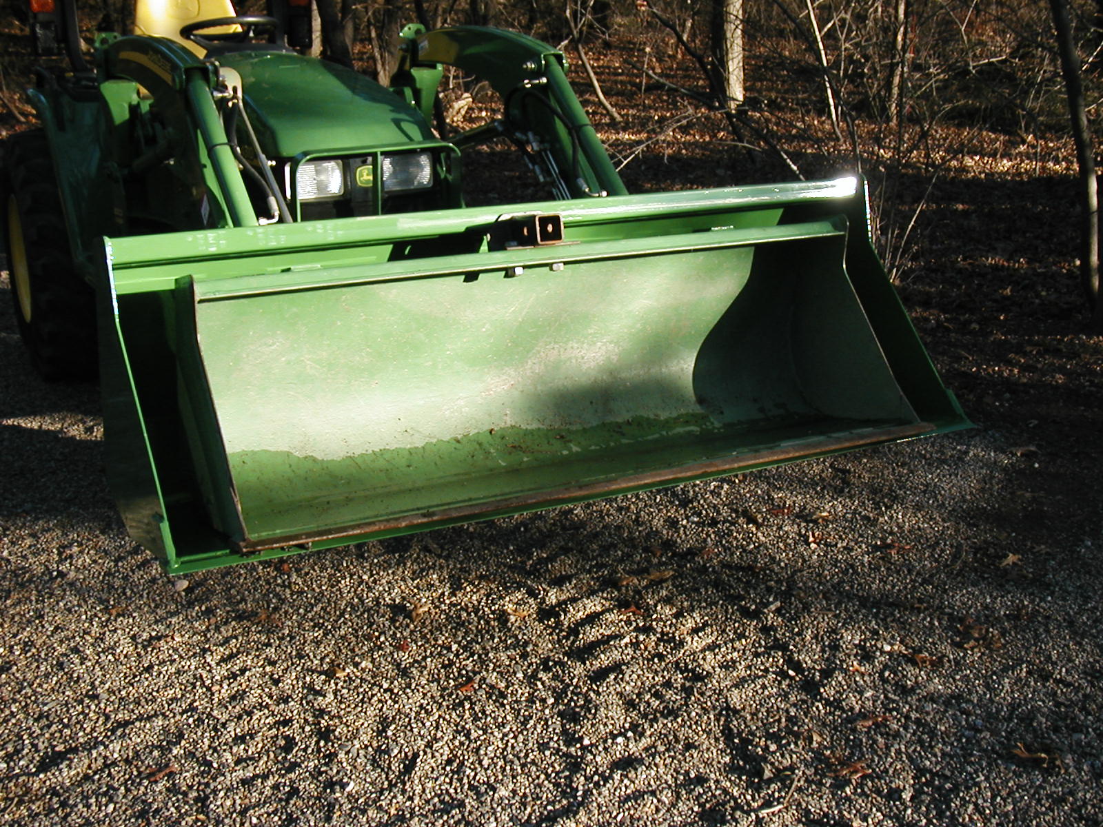

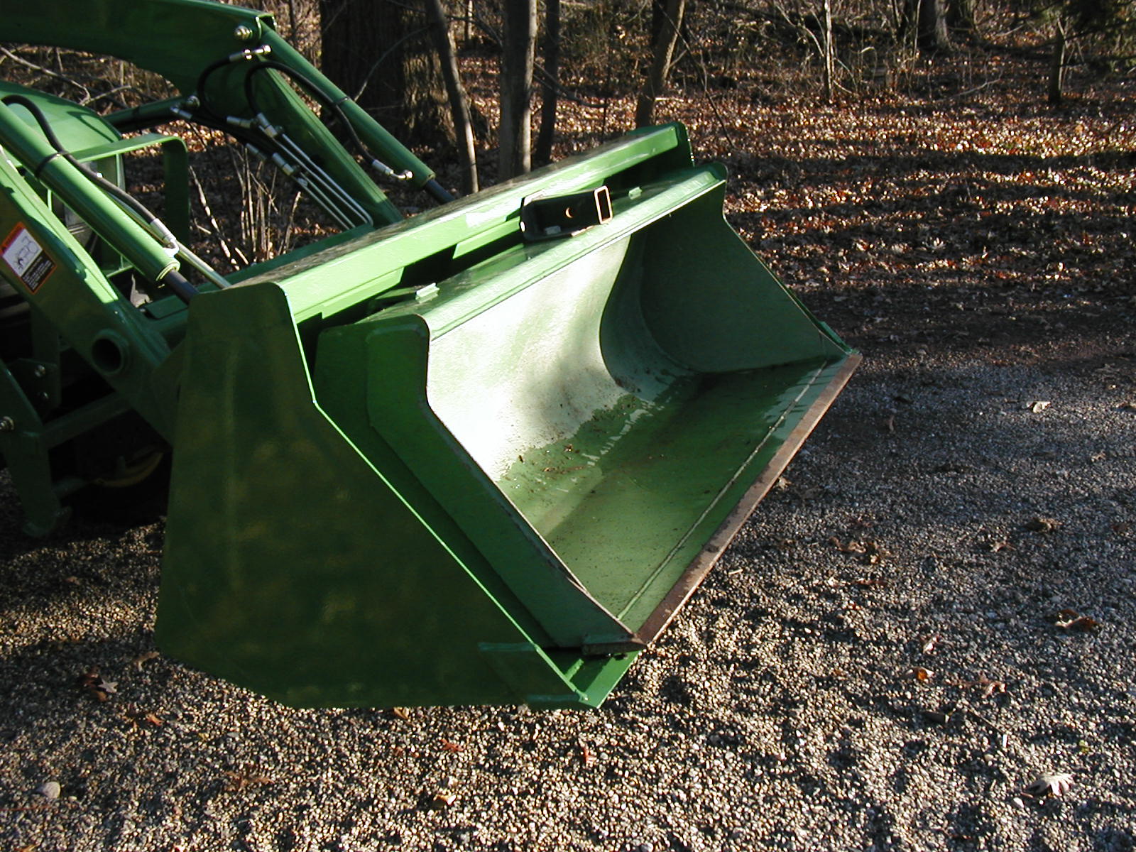

I was thinking about a pusher box, there must be a good reason they're used in every commercial parking lot now a days, but I just bought the larger 73" light materials bucket and it acts kinda like a box holding much greater volume than the HD 5' bucket, but still allows high piling.
I was surprised how well the box cleaned snow the one time I tried it.
