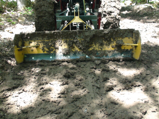

First of all a big thank you to the forum for all the info on here! I'm in the UK with a long compacted stone track to maintain and box blades are relatively unheard of over here. Most people you ask flat out advise you that they wouldn't be strong / heavy enough to loosen heavily compacted stone and the only way to do the job properly is with heavy machinery. Well, I am glad that I ignored that advice and followed the advice on TBN. I found a company that makes box blades in England (Oxdale) and bought a 72 inch one, delivered yesterday. A few hours of work today and I was pretty impressed at the results on a long heavily pot holed stretch, no pot holes now and nice and smooth & level! I'm glad I learned the basics on this forum, I followed the advice and it came out good!
My small contribution to all the knowledge here... brush the water out of those pot holes before starting. We had rain yesterday, dry today, so conditions were pretty ideal. With hindsight of course it's obvious that you need to remove the standing water, but I just left it and so now those "wet patches" that used to be the deeper pot holes are now soft after I compacted the track. You live and learn and I won't make that mistake again.

A better solution is to use the scarifier teeth to rip the entire surface loose and then re-grade. That way, everything has a chance for traffic to re-compact it evenly.

Thanks for that, but in fact I did rip the surface first and it worked perfectly. The wet patches haven't sunk with traffic on them, so I've got away with that. I'll still brush away standing water next time though.
Creating a camber is for my next attempt!

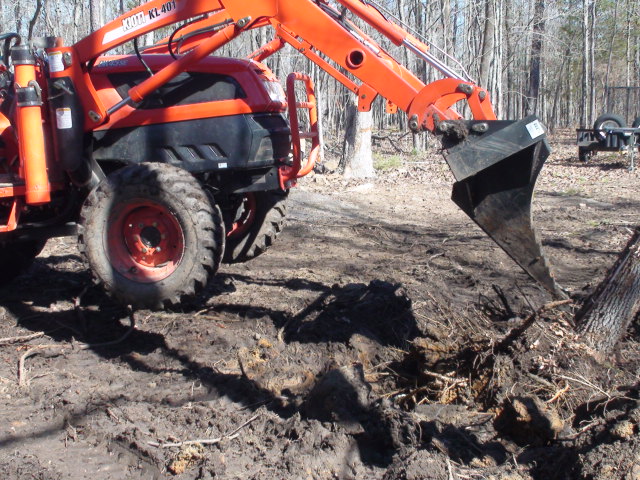

+1 I never worry about low spots holding water as I do a repair as the water helps to keep the immediate area soft so I can add larger/coarser material and then pound/push it into the ground. The soft areas will always be soft until fortified with coarse material, in my experience.
My driveway had a lot of soft spots due to me removing trees and large rocks while clearing my forested property and back filling the holes. Some spots were as large as an automobile and a few feet (1 meter :)) deep. I placed a finish layer of slag over the top and allowed all of the construction vehicles- dump trucks, etc. to finish packing it for me and identify more spots that needed tending after construction was completed.
The only long-term fix for me is to fill the soft areas with large rocks (from my very rocky property) and then top them off with soil or small rocks while the soil was wet, which allowed me to pack the rocks firmly into the soft ground by driving over them with the 7000# tractor. I do the same now on a smaller scale with the few remaining small spots, similar to your situation I imagine.
I have a side opening garage on the new house and a 30' x 60' concrete pad on that end of the house. I also removed more trees ~ 15' wide running along the length of the concrete driveway by the house to use as an access point for the tractor, truck, trailers, dump trucks, etc. It was a muddy mess and I filled the soft spots (most of the area) with larger rocks and used the tractor and 500# landscape rake and 710# box blade to pack and smooth. After it dried out a little bit I had a 22 ton dump truck load of 3" crushed concrete brought in that I covered the muddy area with. The same dump truck came out a few weeks later with 22.5 tons of sand/clay and drove over the top of this new gravel access area to the rear of the property, to dump the load for leveling out the area I will build my shop. He was impressed with how well this new area had firmed up and supported his dump truck. Not a single depression left by his dump truck in the previously, extremely soft area.
