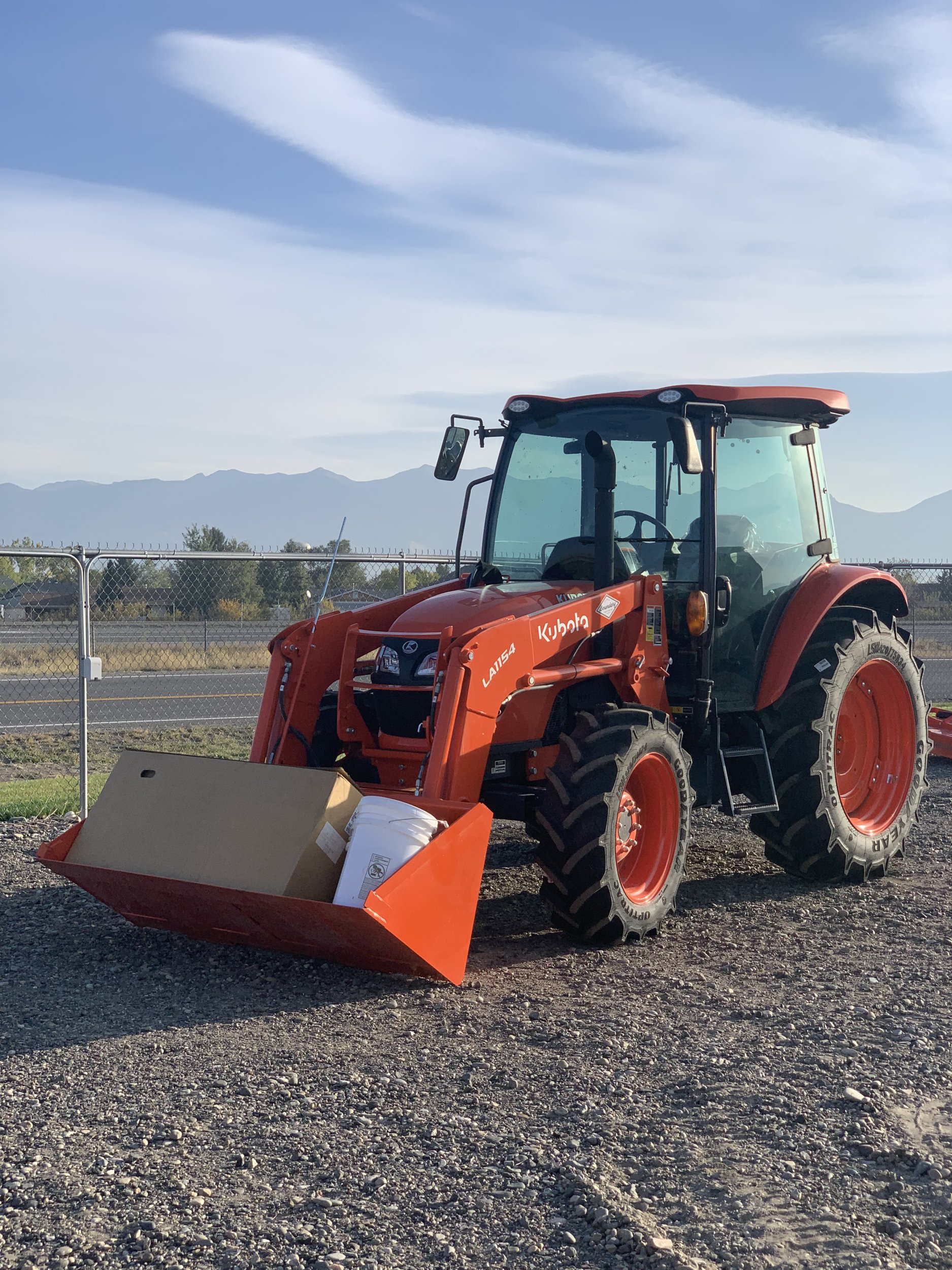

Hi folks, I'm a newbie tractor owner and appreciate the patience from everyone. I just acquired a beautiful M4 from Kubota and now I need a (some?) dirt working implement(s?).
For context, I also have a 3.5 ton mini ex with a 4 way blade on it.
I'm currently focused on developing the property, which involves rough and finish grading both building pads and ranch roads cut into the contours of the hills. For scale, the building site I'm working on now has about 1' of elevation difference that I am addressing with a mini. The big barn will have more like 4-5' to deal with (and perhaps require a professional). The driveway is a little over a mile long and 1/4 of it is raw hill that needs to be converted into something passable. The rest are rough roads to be fixed. Based on my research, the Drag Scraper with trailing wheels is generally used for moving large amounts of dirt and would be a crude tool for most of what I need to do. The Grading Scraper / Land Plane is at the other end of the spectrum and generally more applicable for finish only grading.
How about the Box Scraper and the Rear Blade? I was planning on getting a heavy duty 84" Box Scraper and seeing how that goes, but frankly they're extremely difficult to find right now and I have dirt that needs to be moved. Would a Rear Blade offer any advantages over a Box Scraper or the blade on my mini?
Thanks!

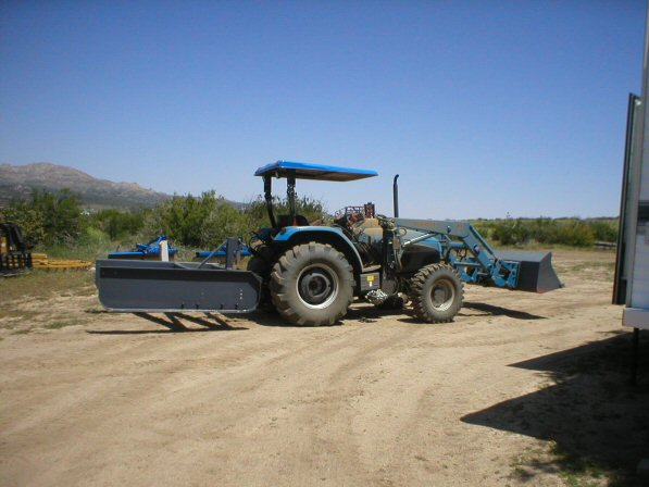

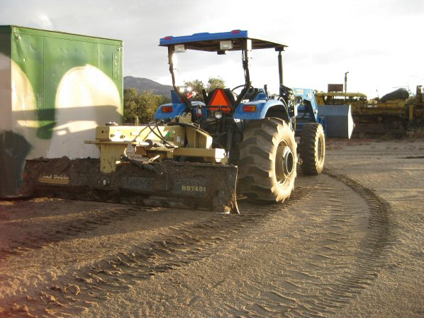

I personally have a 7' 1000lb roll over box blade, a 9' 1200lb hydraulic actuated rear blade, a 1400lb LPGS. (land plane grading scraper)
You mentioned the land plane grading scraper as a finish type implement. Not at all. Yes that is how it is typically used, but I have found that by using the LPGS to start a path, by getting the path smooth and a little more evened out it is by far easier and faster to then contour the path as you want-need it to be. I have done the exact same thing for grading out larger areas (acres). It just makes life better overall.

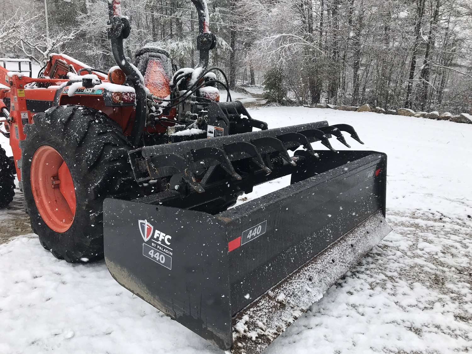

Seeing that you are in the beginning stages of a very large project, and will have a lot of use for rough grading and spreading material, my suggestion would be the heavy duty box blade as first priority.
I think you’ll find this will do a lot more work than you would expect. The trick is getting a truly heavy duty one, not a 600 pound 7’ box blade. Something in the 1,000 pound plus range.
I would hold off on the rear blade. I don’t feel you will need it. You will do all of your ditching with your mini X, and can move loose material with its blade.
I may be a bit biased, but I think that for your size tractor, the holy grail of box blades is the 1,600 pound FFC box blade.
I’ve cleared land from forest to lawn various times, and by far the go to implements for me have been a heavy box blade and a FEL grapple.
For finish work, You won’t beat a power rake.

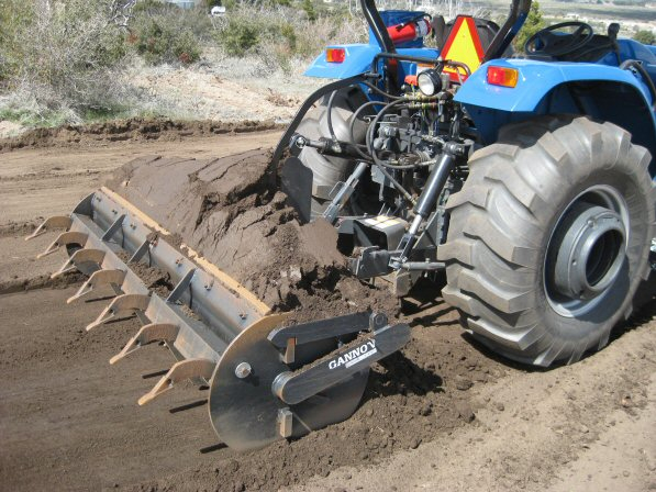

Again, it depends on what you are working on. If I could only have one, I would get a box blade like-similar to what Piston recommended. A box blade will do it all, just certain processes will take longer. An example is it takes forever to move dirt sideways, but it will do it. A rear blade will shape and contour a road in less than half the time a box blade will do it in.
I started out with a med duty rear blade and my roll over box blade. I have over a mile of road to maintain as well as miles of fence line. For 2 years I made due with those. Then I got my LPGS, cut my general road maintenance by half the time, easily.
Then I cut in a couple of new roads, started with my new 9' rear blade, but the ground was so rough that it seemed like I was getting no ware very slow. Decided to try the LPGS to even things out some. Worked great. (y)(y) Then I went back to my 9' rear blade and did the shaping and contouring. I have several gradual turns as well as an S curve.
