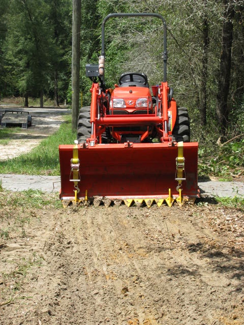

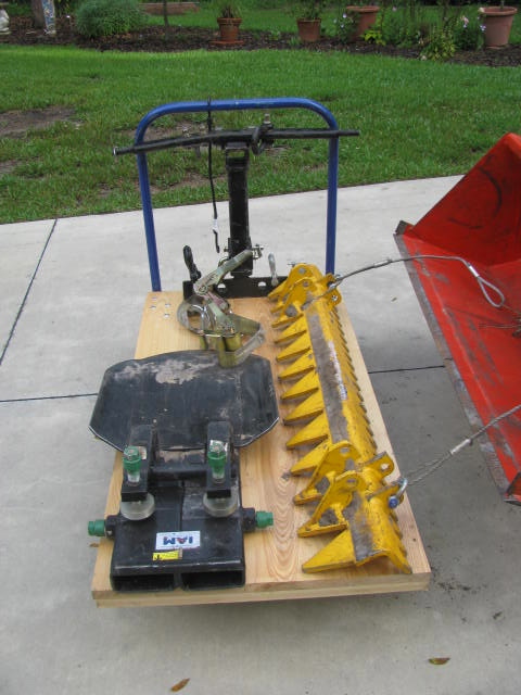

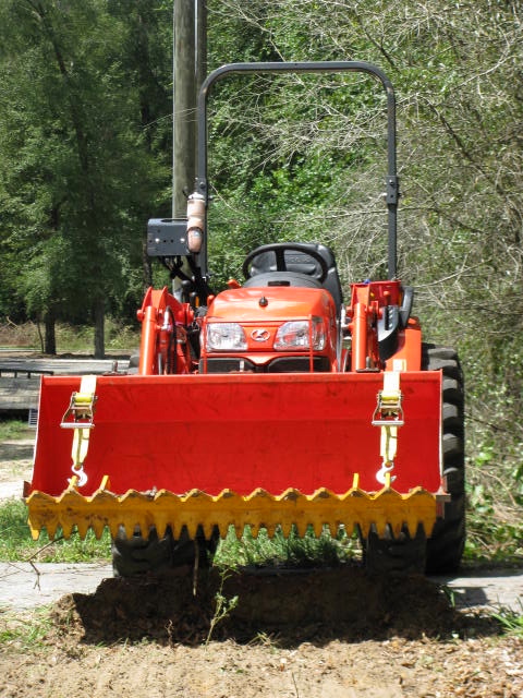

Five feet is the correct width. Buy the heaviest Box Blade you can afford. 600 - 700 pounds would be my recommendation for the rocky soil in Mass.
As you have a Backhoe, perhaps you can get by with a Ratchet Rake on the FEL bucket ($350) rather than a Box Blade, which will require you to remove the Backhoe.
Photo #1 is my Bush Hog (brand) Rollover Box Blade, 587 pounds. Photos #2, #3, #4 are the Ratchet Rake.

Nice box balde you got there. Ratchet rakes look good but I have high and low spots all over so I thnk I will stay witha box blade. I have never had the backhoe off yet but I gotta do it some day. Always threatening to drop it a d go in the woods for fire wood.

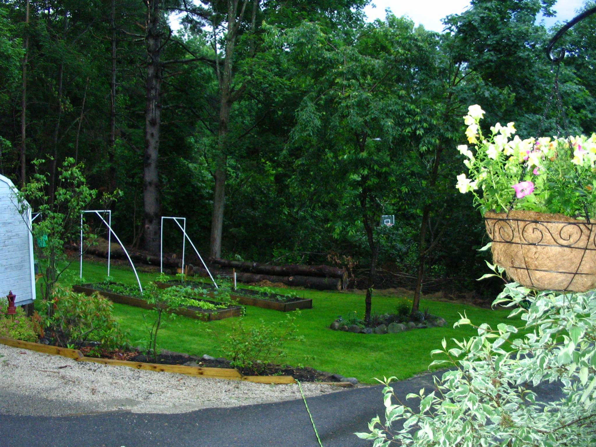

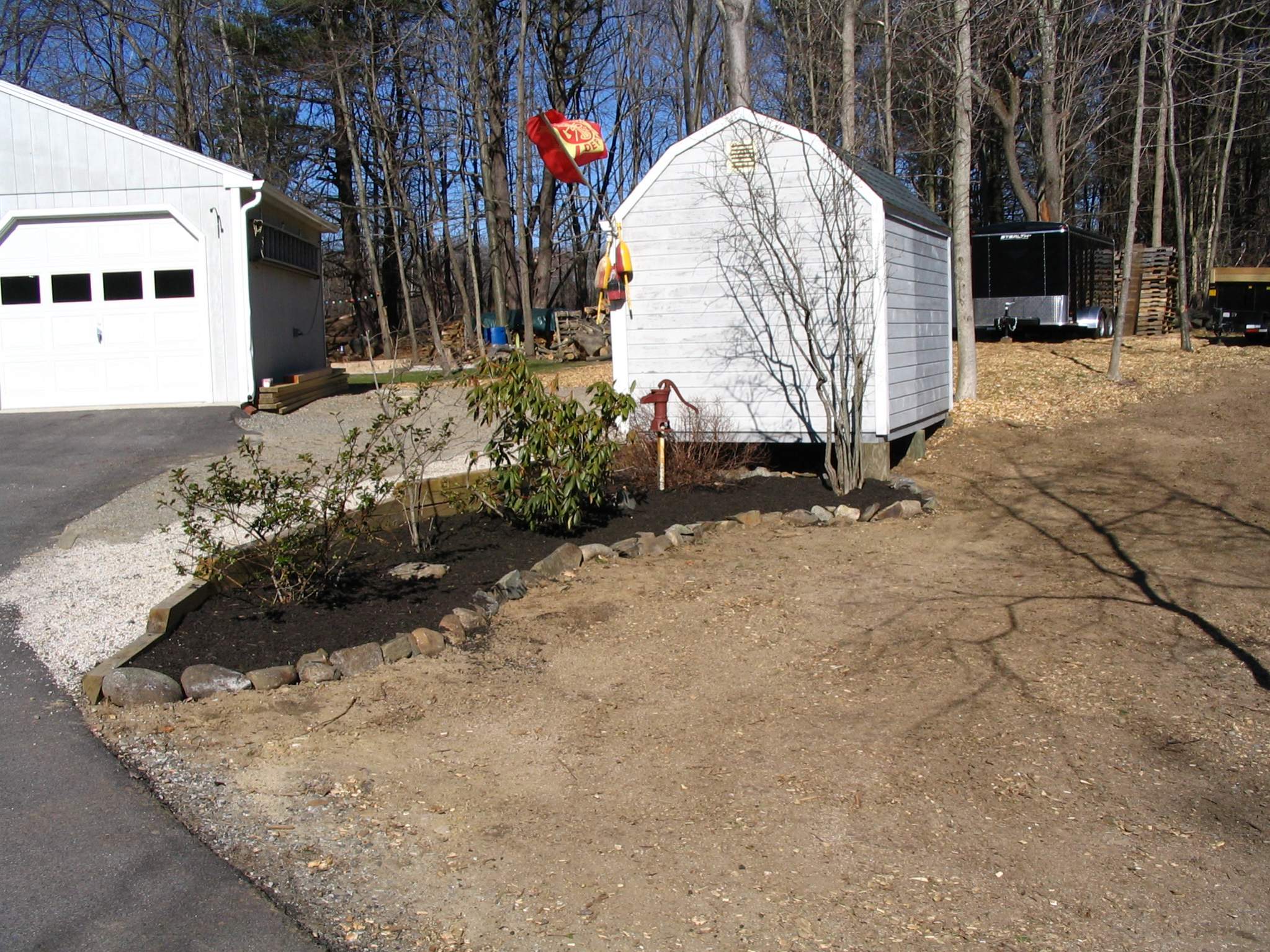

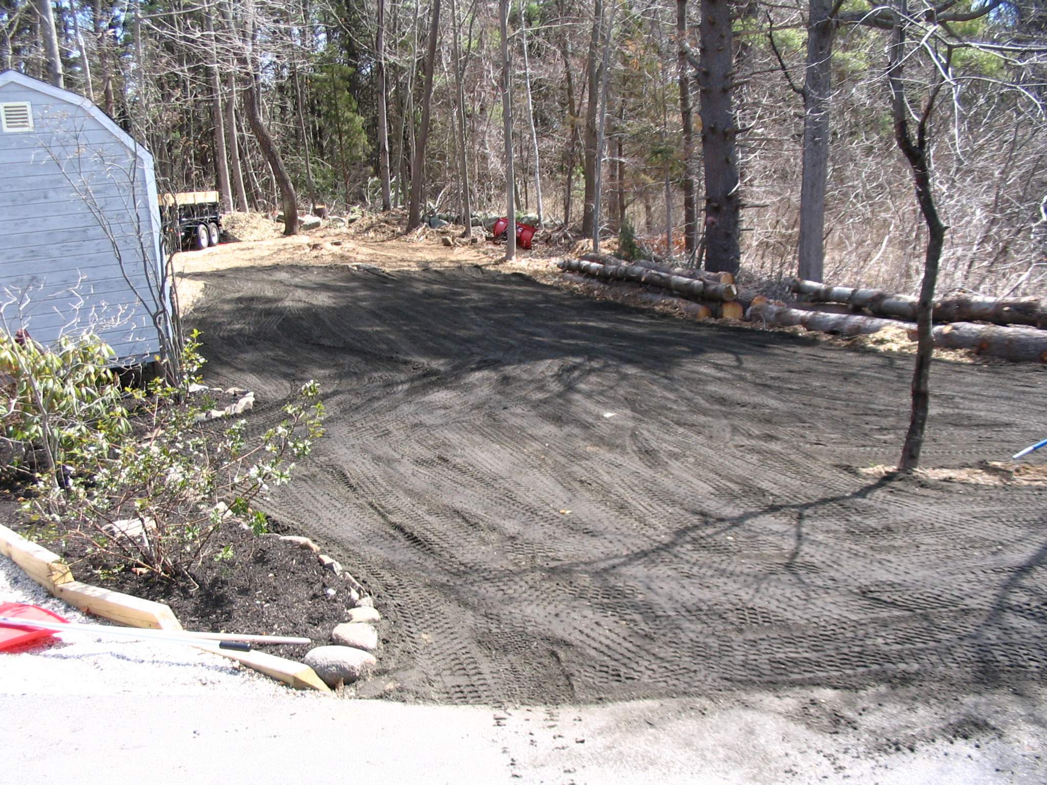

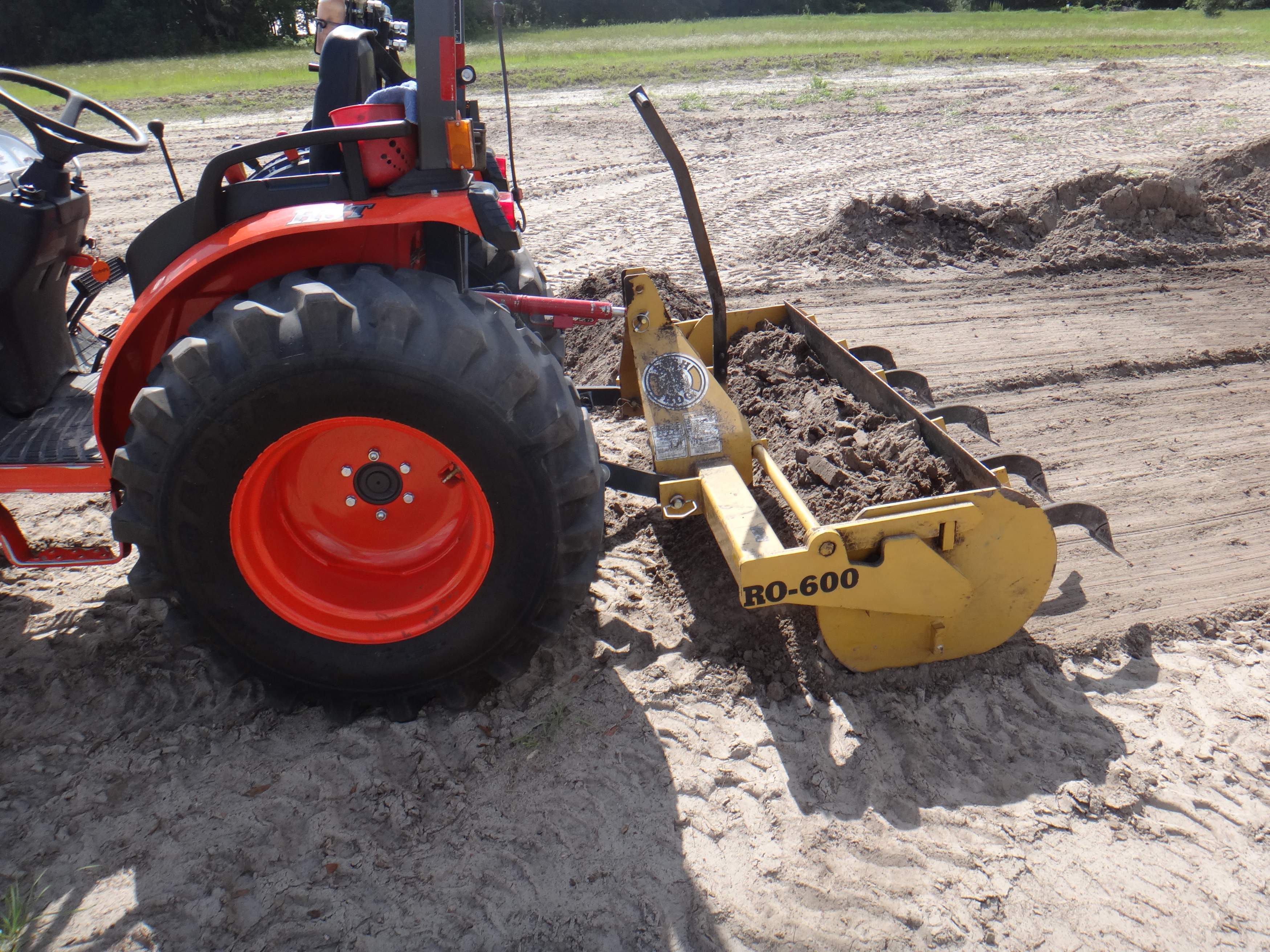

FYI, I did all this with a York rake (with wheels)... Found on CL for under $500. Just a thought
