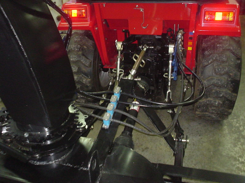

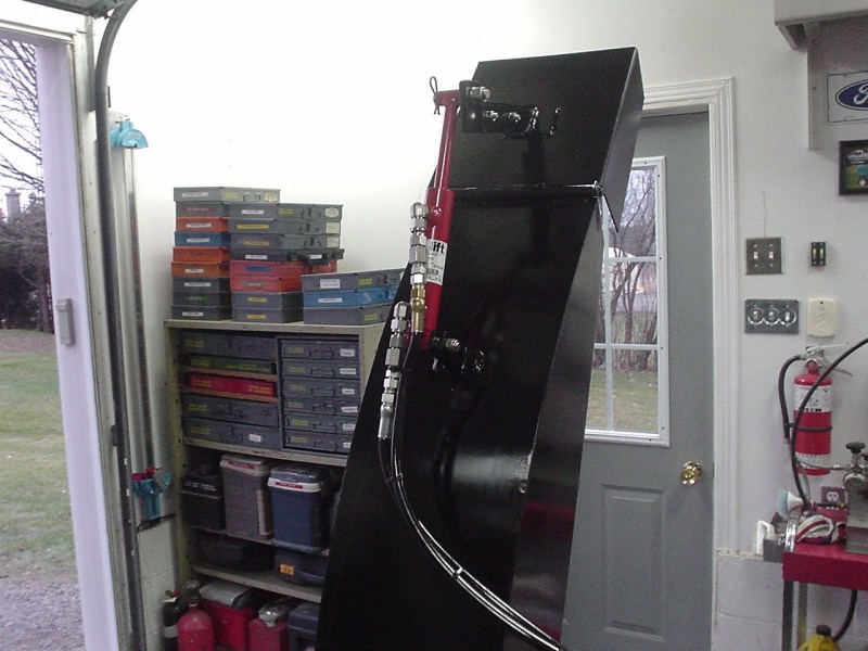

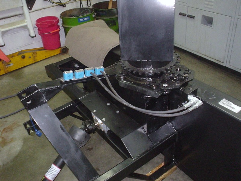

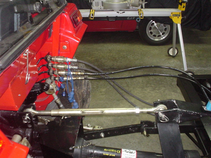

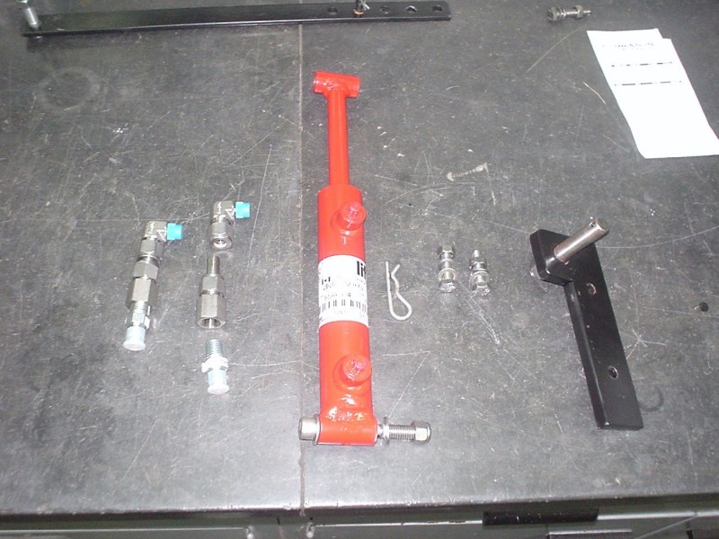

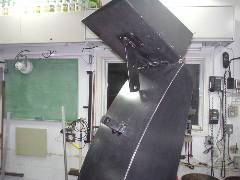

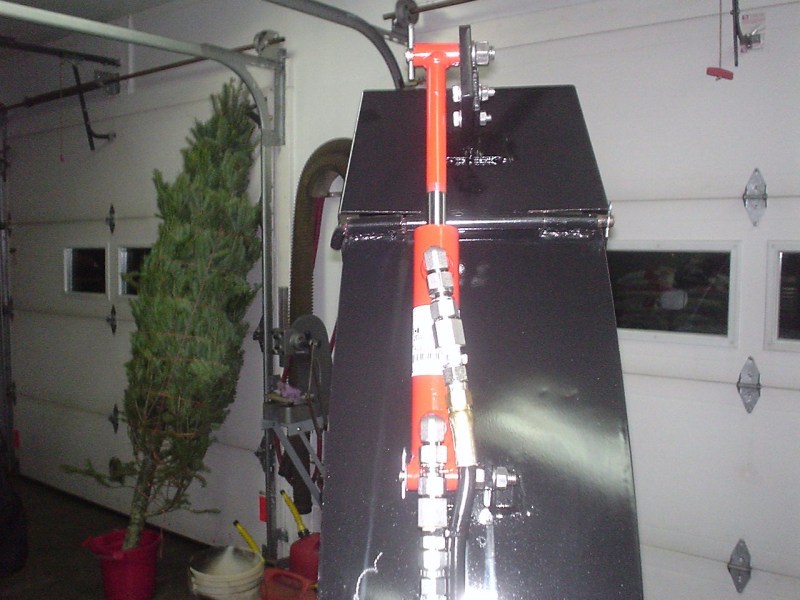

Braber Agriease 72" snowblower hydraulic chute rotation and deflection. I bought this blower with hydraulic rotation and added the deflection.
  • Snowblowerhydraulicchutedeflectorcylindercustommadebrackethoseadaptorsandconnectorsandmountingha.jpg

nice clean job. You know i ran a rear push blower for about 7-8 seasons and had a fixed deflector... I never thought i needed a hyd deflector. But now that i have used my new loader mount blower with the deflector...i wonder how i ever did it before. I can now accurately place the snow where i want and miss the small trees, vinyl fence and landscape lights.... i love it.
