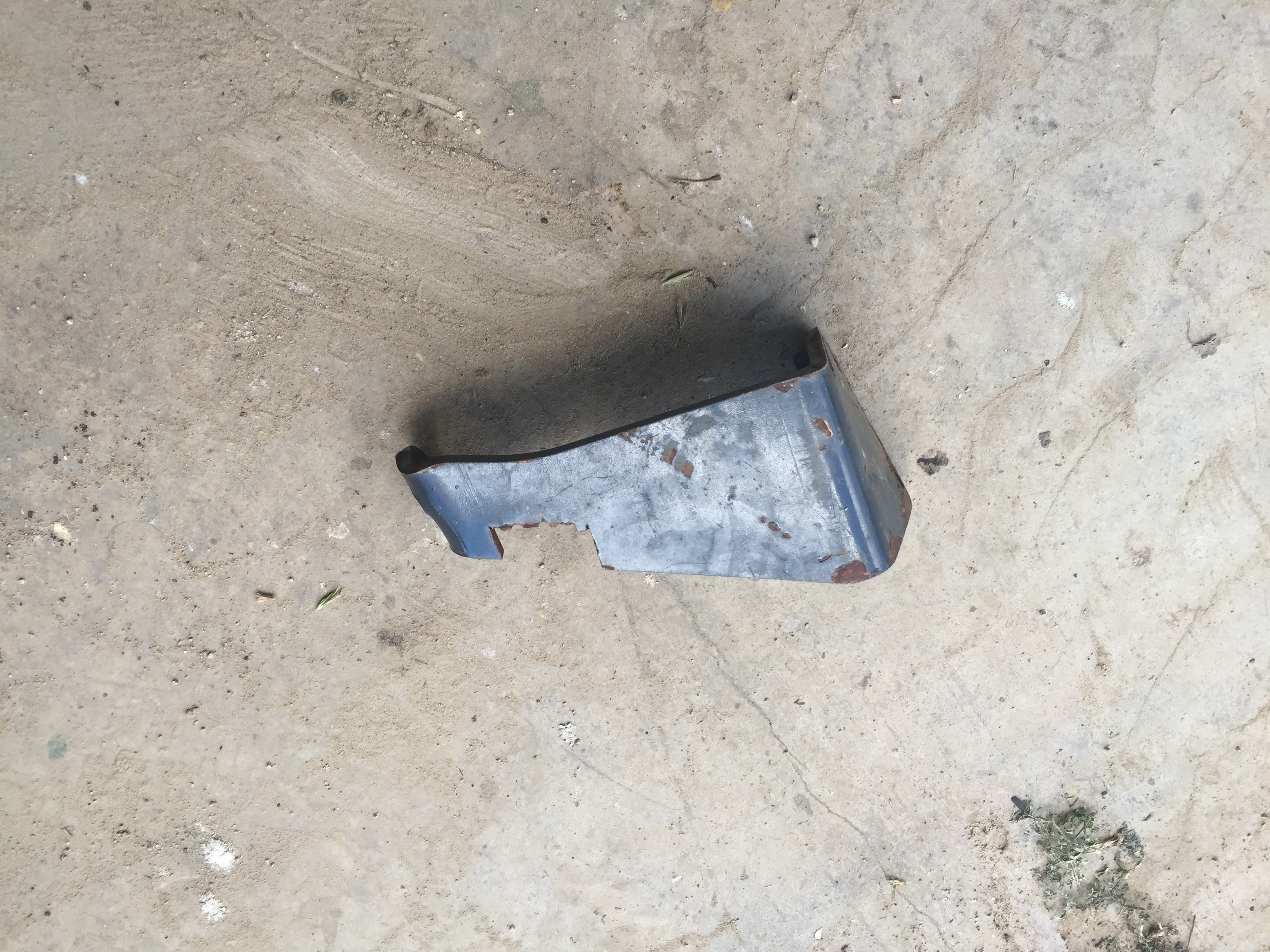

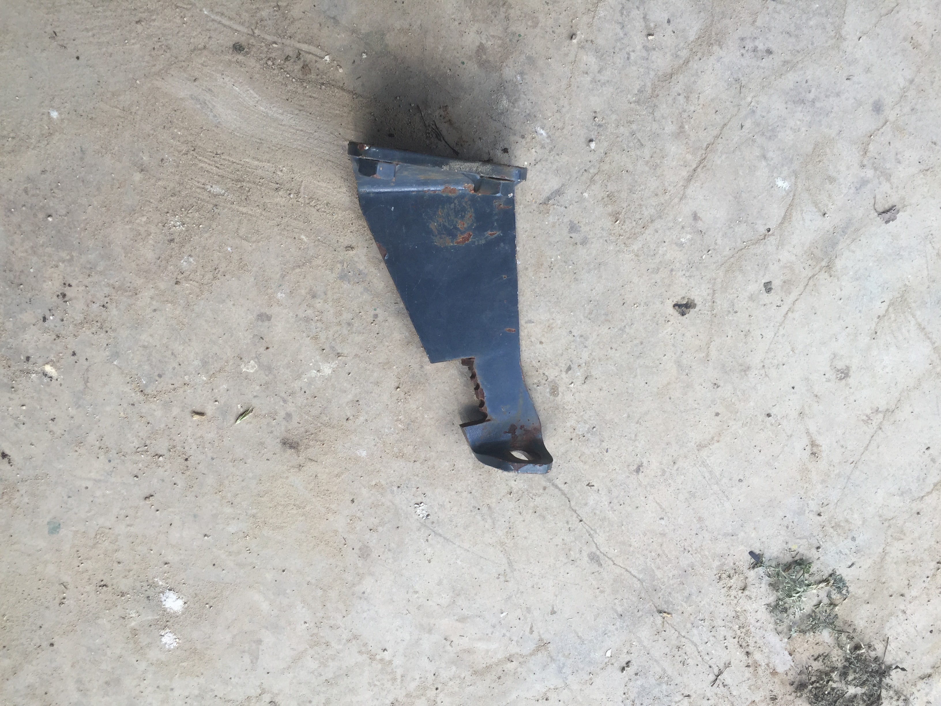

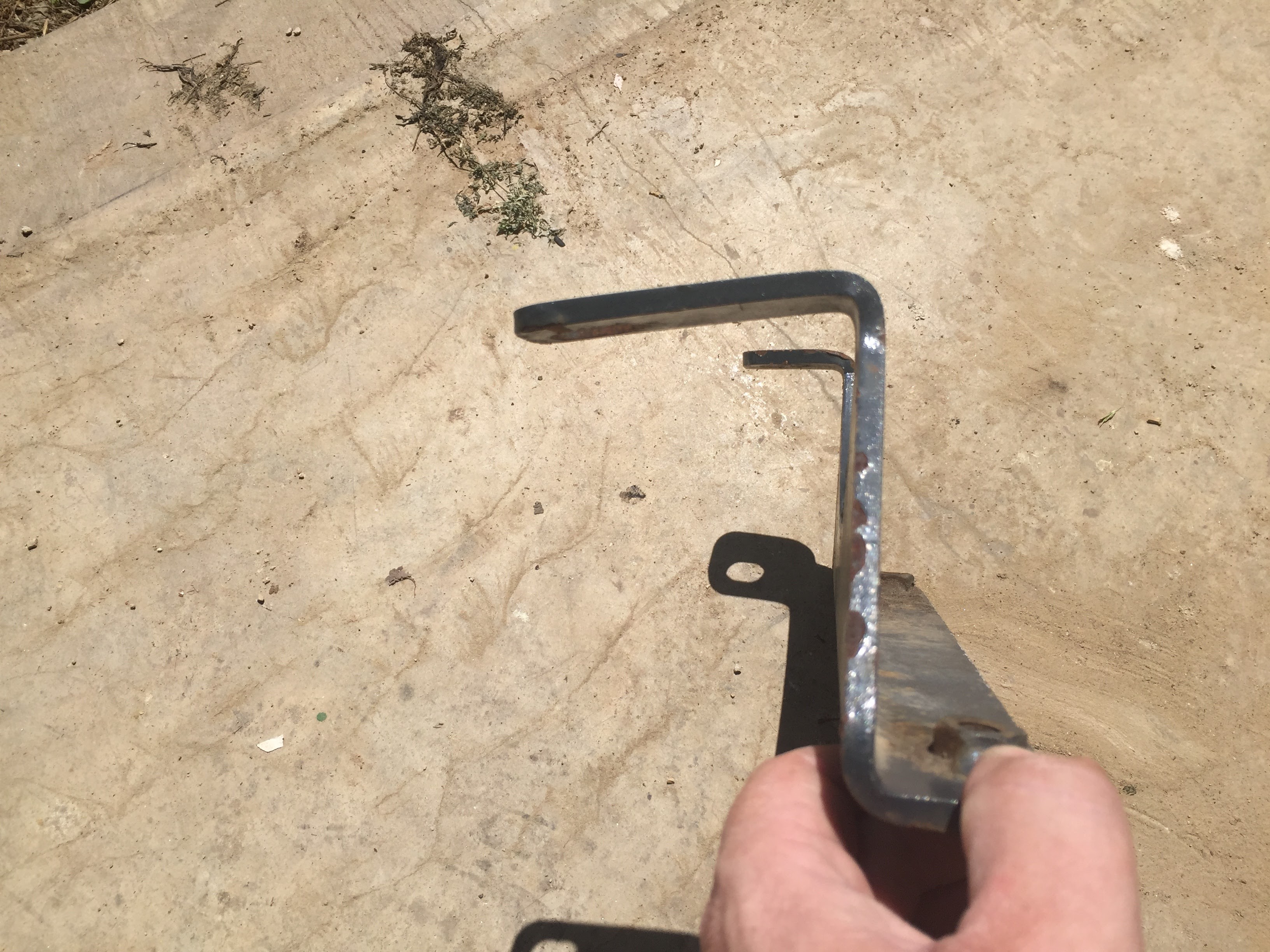

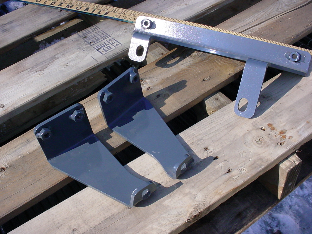

Hello, posted this on another site, but not getting any replies. Hoping someone here can help.
I recently purchased a 110 TLB with auxiliary hydraulics. It didn't have a skid plate and in reading this forum and looking at the location of the valve bank, I could tell it needed one. (actually had a dent in one of the hydraulic filters from from the previous owner). Found someone with a used bottom guard, but it is missing the filter door, and one of the front brackets. The one that is there, is bent and had been modified.
In looking through the online parts catalogs for the 110, I couldn't find a breakdown for the belly pan. Since these were made by a third party, and distributed through Deere, is there any chance of getting new brackets and service door?
The rear bracket is slightly tweaked, guessing the mounting tabs should be 90 degrees to the body? Just wanted to check before straightening.
Also would anyone have the hardware sizes for attaching the brackets to the tractor?
   / Brackets and access door for 110 TLB skid plate #2
I would simply cut another door to replace the lost one.
Yes creating a new door shouldn't be too difficult. Figured I'd compare the price before making one if they were available new. It just needs two holes for bolts on one end, and a piece of extra steel welded to the back on the other to fit into a slot under the existing tab.
Still would be nice to get replacement front brackets, or look at someone's for a pattern. Not sure why they notched this one out. In holding it up to where it bolts to the tractor, it looks like there would have been enough clearance originally, if it wasn't bent.

I have my skid plate off the tractor and can take pictures if that helps. Let me know. I will be putting it back on Tuesday or so.
That would be great, sure appreciate it!
   / Brackets and access door for 110 TLB skid plate #6

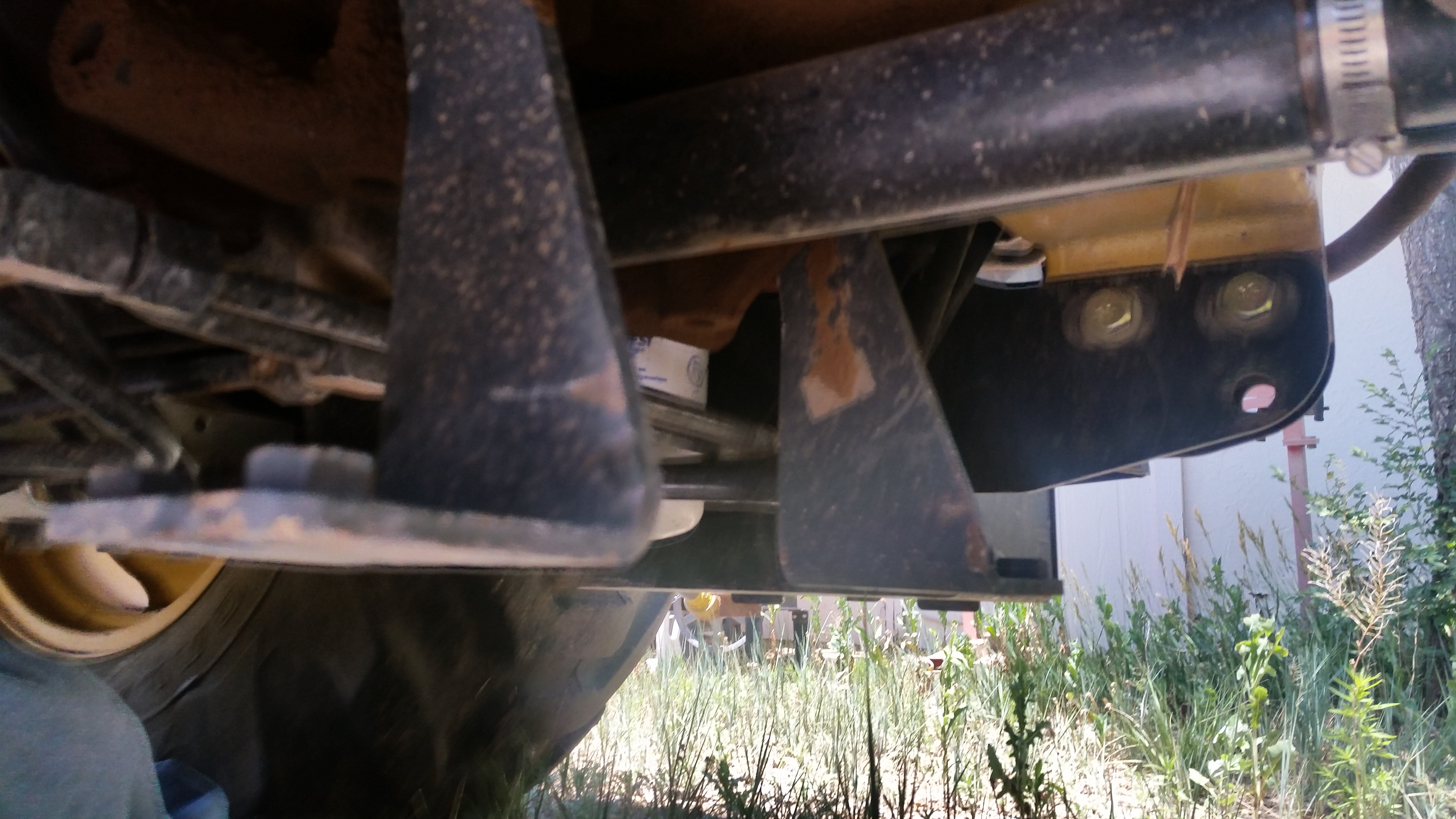

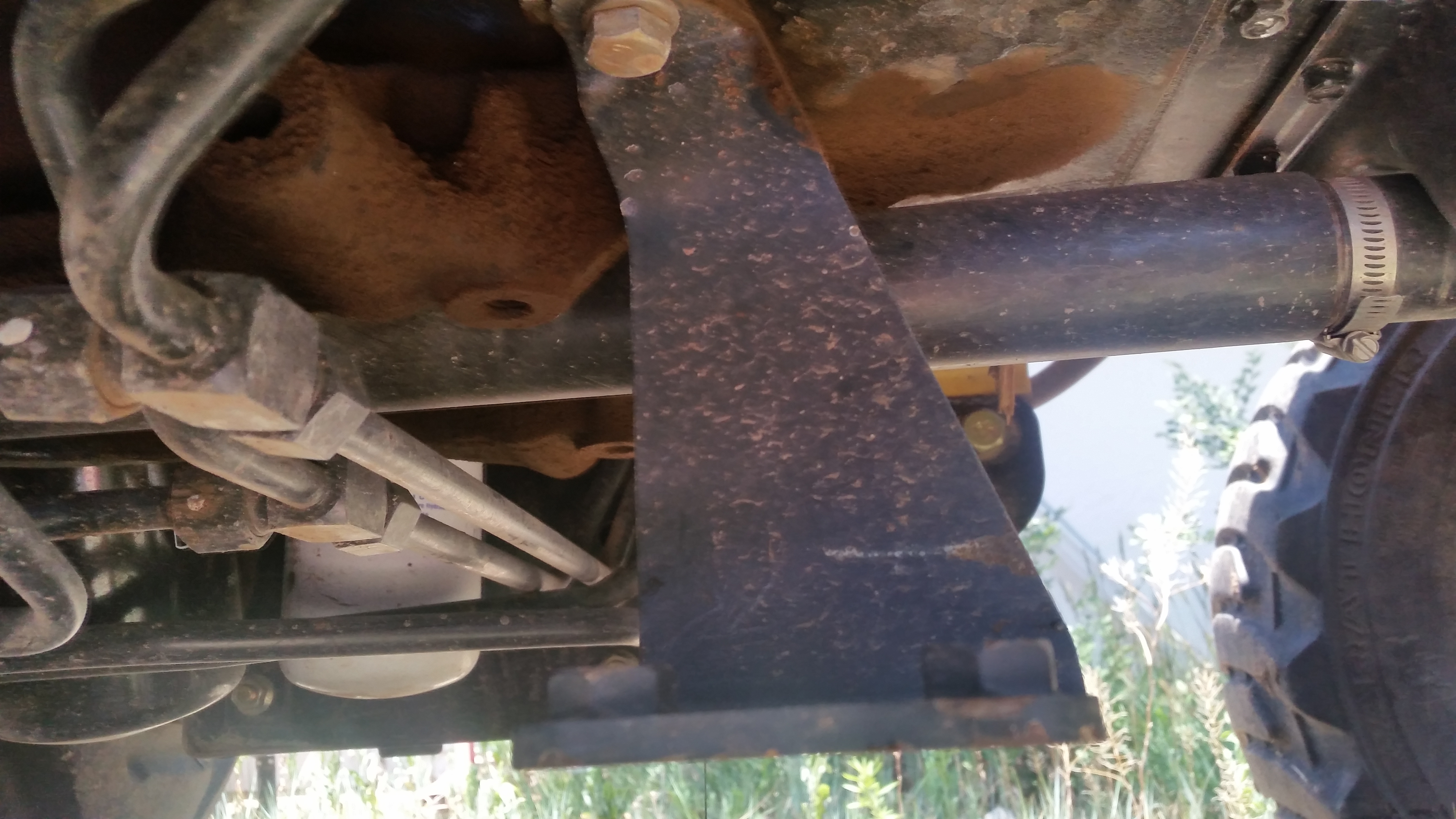

I don't see any reason to notch the support in front. Plenty of room around them, might be a good idea to add a flatbar reinforcement plate where it has been notched. When installed the two front braces need to be flat and true with the pan and obviously lines up with the holes in the pan. The rear mounting should be flat with the pan also.
Here are pictures of the front mounts for the pan.

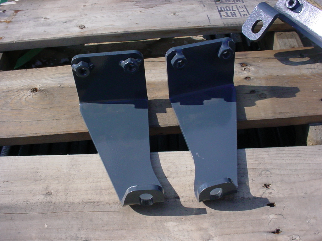

I took some photos of my brackets before installing the guard. I'll try and find them
   / Brackets and access door for 110 TLB skid plate #8
Here are the photos. I hope it helps
#9
Thanks for the pictures! I've been traveling for work the last few days, but will be home this weekend and can hopefully get back to mounting the pan.
It really helps seeing them both on the tractor and lose before being installed. Should help in getting some made.
