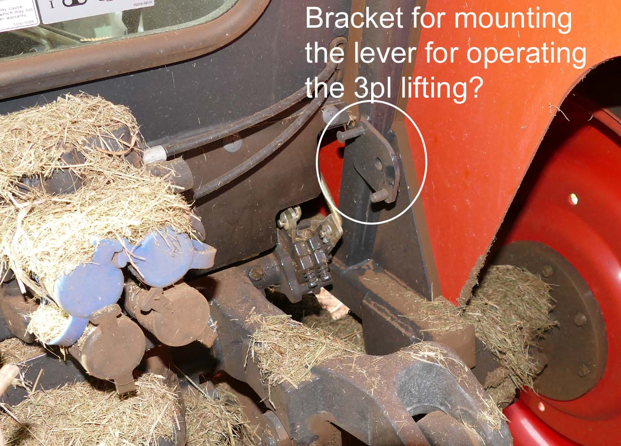

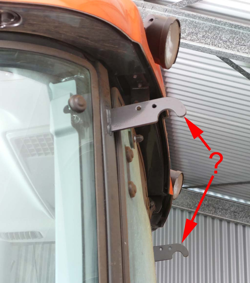

Can anybody tell me what this pair of brackets are for? (On back of RX8030 cabin)

   / Brackets on back of Kioti cabin? #2
Looks ljke they're ok for auxilliary lighting, might be good for a camera too. Keep 'em light.
   / Brackets on back of Kioti cabin? #3
Brackets are for a second set of exterior LED work lights, of course for lighting the rear of tractor. I did not see it in the photo, but there should be a power connection, just waiting to be used. The power cable goes to a toggle switch on the driver's right side panel.

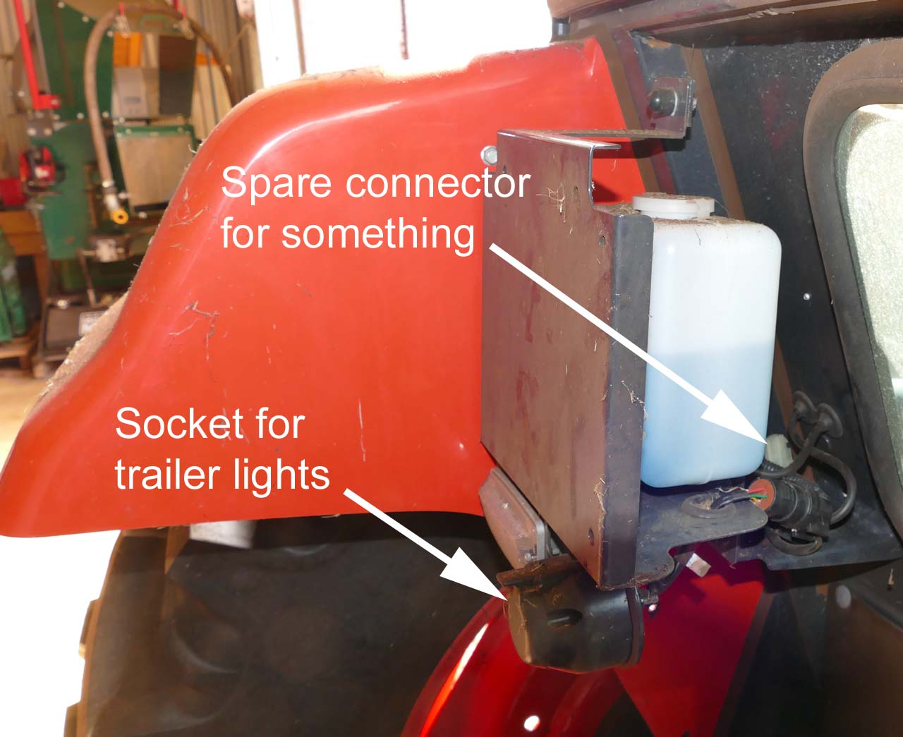

The only unused power connector around the back of the cabin that I can see is tucked in between the windscreen washer reservoir and the cabin:

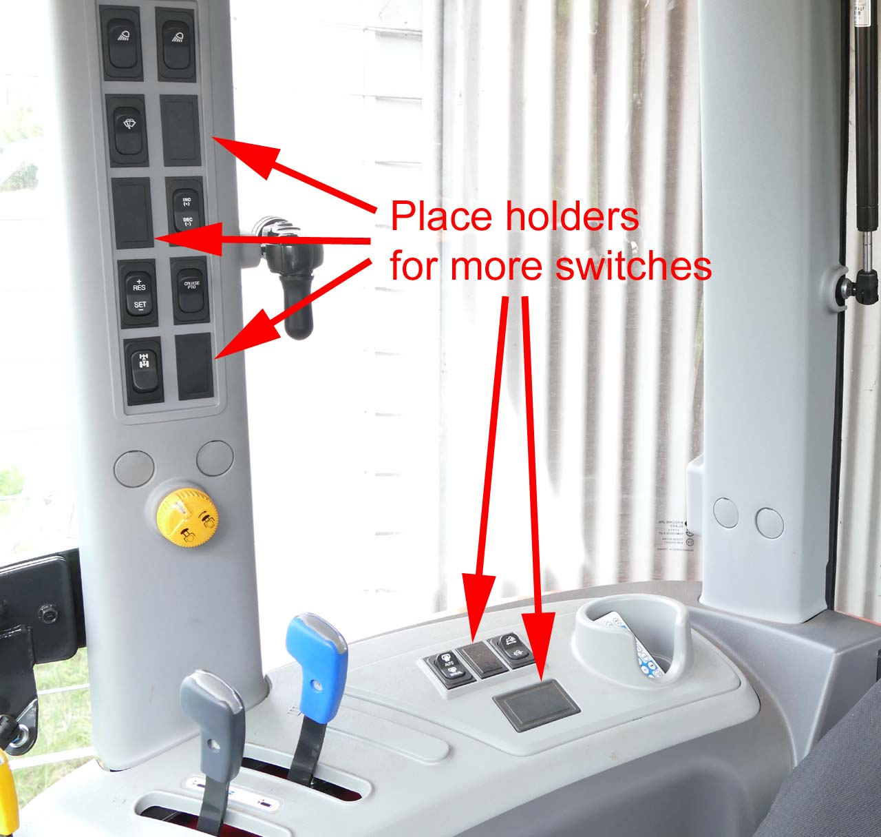

I can't see an aux light switch inside either (apart from the front and rear worklights mounted high up) but I believe depending on which market, Kioti equip their tractors differently. I believe in some markets, there's an external control to raise and lower the 3pl.

   / Brackets on back of Kioti cabin? #5
Are those spring things under the lever aux valves for raising & lowering, just w/o the lever to actuate? The connector can be tested for power in whichever switch position. If it's hot in key 'run' position (only) I'd tap into it, add a factory switch to the panel, and run the wires.
Yes, the two existing rods are from the inside - one for draft, and the other for raising & lowering. I think all that's missing is the lever. Does anyone have a Kioti with that rear lever? I'd be interested in seeing the setup. I don't imagine the rear lever would be permanently connected, 'cos if it were, it'd have to move up and down as the inside lever was moved. That'd be a messy sort of arrangement I'd think.
At the moment, by opening the rear window, and standing carefully on the right hand lift arm, I can reach in and operate the lift when hitching up an implement, but I'd rather not have to do that. I'll check with the dealer and find out whether that rear lever is available as an option.
I'll check the power status of that spare electrical connector, and try to work out it's purpose. If no joy, I might even have to ask the dealer about that too! :)

   / Brackets on back of Kioti cabin? #10
Nothing to do with lighting. I asked my sales man about them 10 years ago. They are there to facilitate cab installation.
