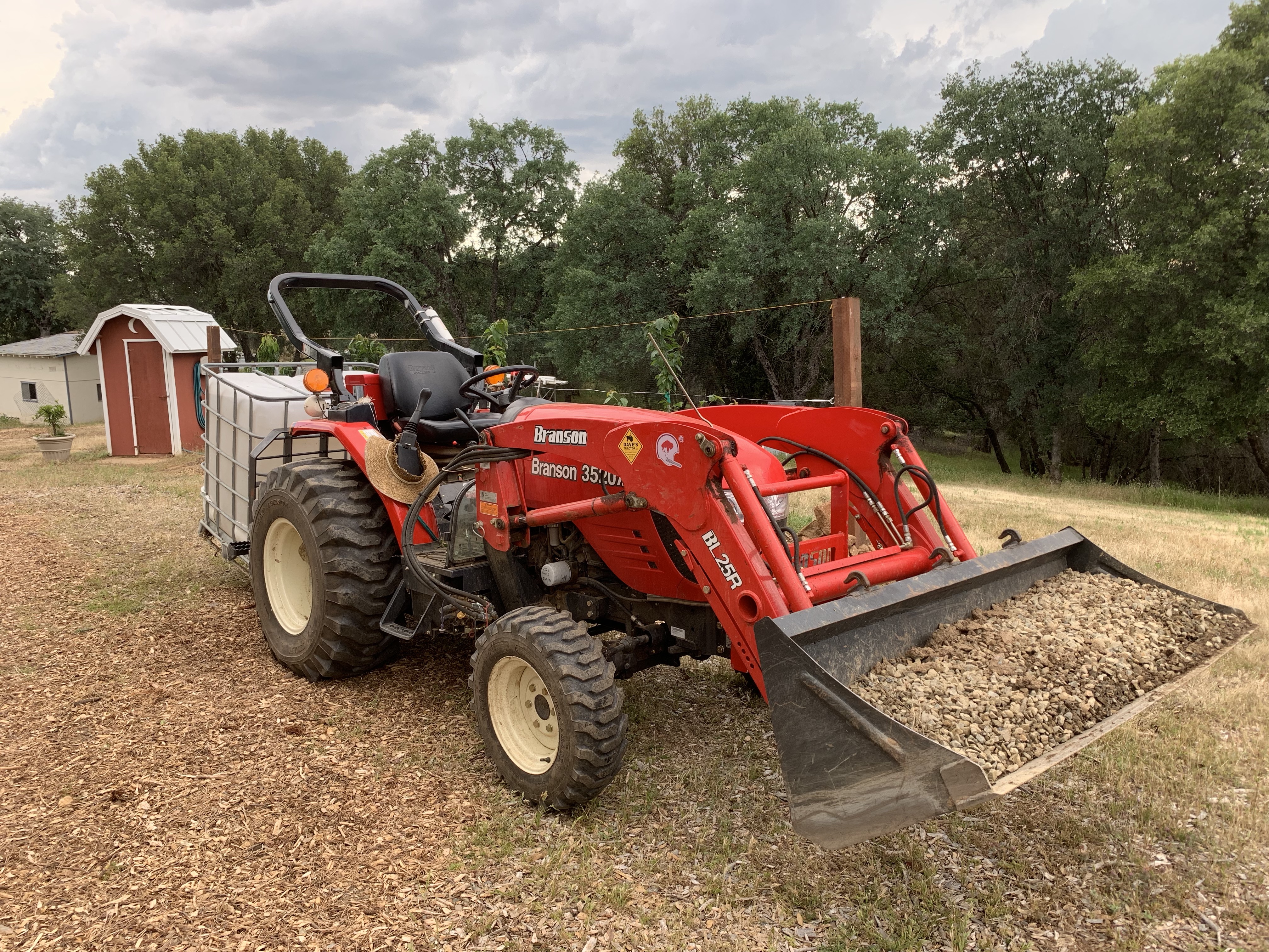

Yup.
Here's my 35 HP Branson lifting 2428 pounds (275 gallons x 8.34 lbs/gallon + 135 IBC Tote). And yes, had to scoop some gravel in the FEL to keep good balance on both axles.

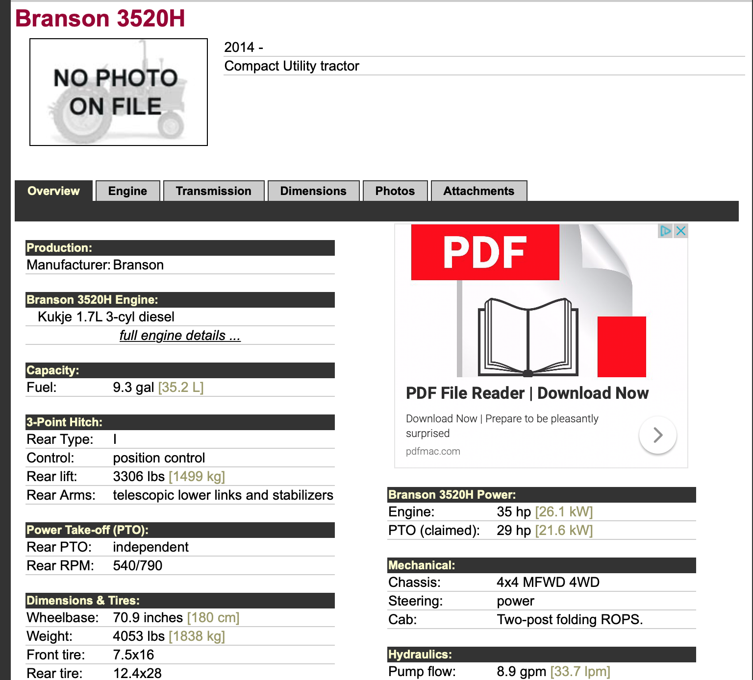

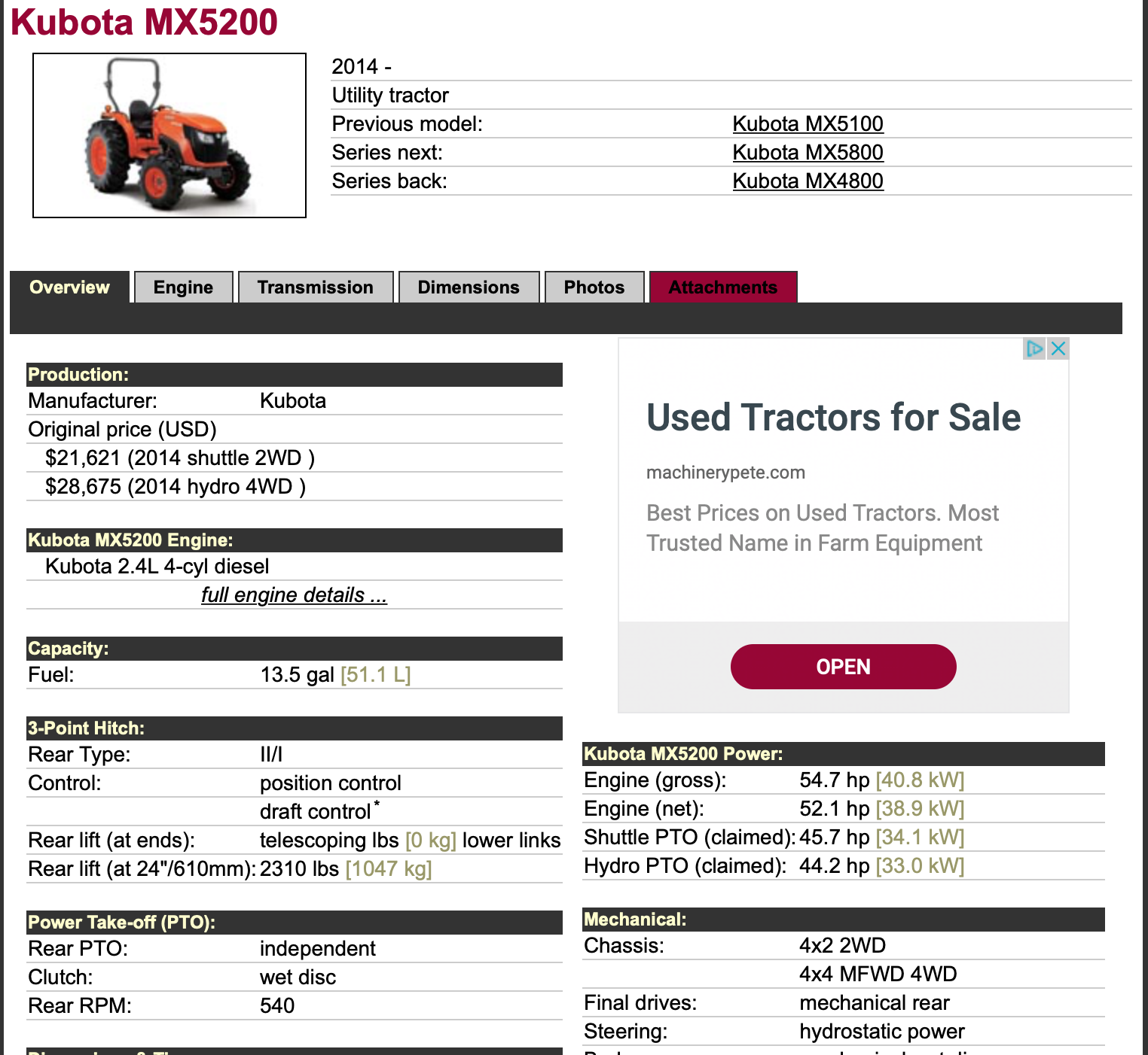

FWIW, the Kubota MX 5200 is lighter and has less lifting capacity than the Branson 3520H.

Thanks for the spec sheets - guess when I bought my 3520, I did ok then... I take those tote cages and fill with red/white oak split firewood - the green stuff... can only lift 3/4 of a tote full. With a Kubota - I would only be able to life the empty tote cage... /lol
