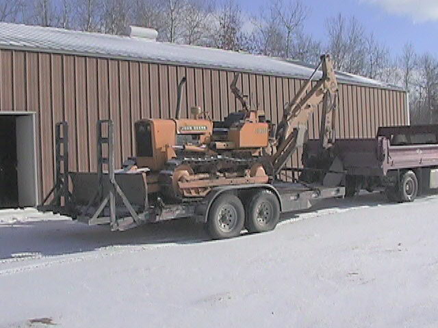

I've had a Tekonsha prodigy since 2002 and works great towing light or heavy. In all weather rain sleet ice snow or clear & dry. Left it hooked up for weeks at a time & does not discharge truck batteries.
