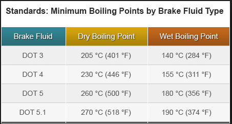

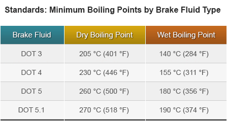

I have had bikes with both types of systems. DOT 5 was supposed to be better in bikes because it can take higher temps but in the real world you are not going to see a difference. 5.1 also threw that out the window.
