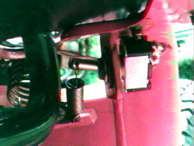

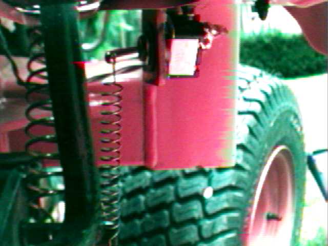

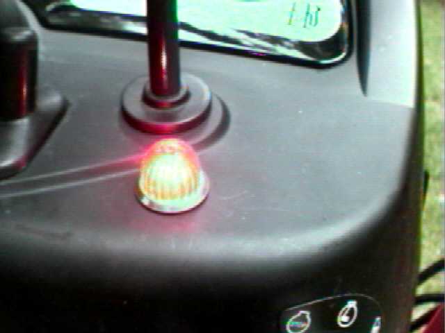

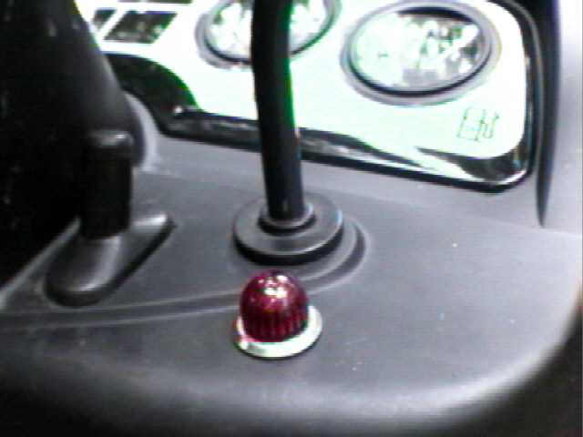

Well...I just finished installing my brake light switch. It works great. I used a piecce of 1" angle iron, drill a 1/2 inch hole for the switch, and two small holes opposite for mounting the brackect to the machine. I used a momentary on normally open bat toggle switch. I drilled a small hole in the end of the switch, mounted the bracket to the tractor, then the sw to the bracket. To actuate the switch I used a spring, put one end through the end of the switch ( hence the small hole I drilled) and put the other end on the brake arm; on the opposite side of the pedal return spring. Kubota nicely made the pin extra long with a hole in allready in place! I put a 1/2" 12v red light in the dash just below the throttle,and picked up the 12V from the ignition (key on-power on,key off power off) side of the headlights...this way the light will NOT stay on when the key is off. I'll try to get some pics to post...dont have a digital cam but my web cam works ok. Total cost...less than $20.00....total savings of not killing my tranny...thousands...Not having to tell my wife I killed my new tractor...priceless!

OK here's some pics..this is a view looking foward...the brake is off. Note switch and spring.

Now here's a pic with the brake on...again note spring and switch.

Here's the light on my dash

And last here's the light "on"..as you can see it's nice and bright.
PS. Can't only set one brake on the bx.
