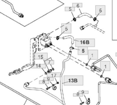

John Deere 5310 circa 1999. Just replaced the hydraulic control on the brakes (the old one blew out). My brakes work fine until I run my max size shredder (MX-7) for about 3 hours, then they get soft and eventually go to the floor with no breaking at all (this has happened multiple times). Today I worked on dirt moving and road work for 3 1/2 hours and had no problem. Any thoughts before I mortgage my house and go talk to John Deere service (kidding, a little)?

Have you tried bleeding brakes? If so my guess is check valves inside brake housing aren't seating properly. My understanding of brake valve operation is hyd system is only utilized to keep brake valve reservoir full of hyd oil but supplies no direct hyd pressure to brake linings. Note hoses attached to brake valve with clamps.
