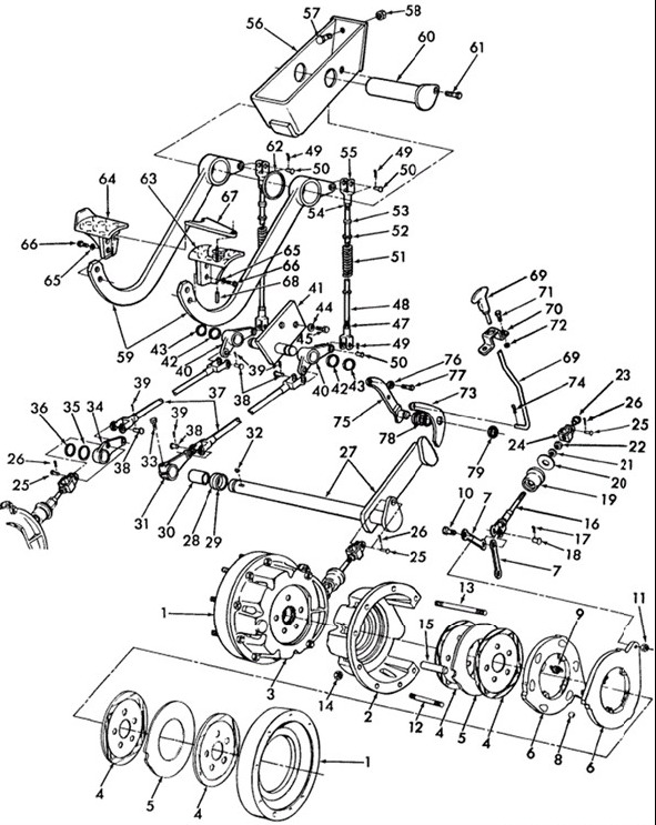

Thnaks for looking in - I've got a 88 Ford 555B and one brake pedal goes to the floor with no resistance and therefore no braking. I've looked underneath and everything is connected and moving properly but no brake? The other pedal is working fine. Thanks for any advice -- I do have a service manual but not sure where to start w/ diagnostic.

I can't really help a bunch, but here is an illustration to use for reference on your brakes. You can use it to see how they are mechanized internally.

newholland website is slow for me. so i just go through the company i bought from website. for a quick link to new hollands part catalog...
Construction Equipment-Backhoes-Mini Excavators-Skid Steers-Pat Kelly-MO
then click down in middle of page
New! New Holland Online Parts Catalog
type in 555b into search
then click plus signs to see different views of the brake.
p.s. same image as what jinman posted. but gives some part numbers.

The type of brake mechanism that the 555B has is pretty common. Pressing a pedal moves a plate inside the brake mechanism that rolls up steel balls in a ramp channel (it looks like 6 in the diagram) causing pressure against a brake disc. My guess is the mechanism is broken or loose inside the housing or the steel balls may be gummed up and not rolling as they should.
   / Brake problem - One pedal not working? #6
It is a mechanical wet disc brake system. It is either out of adjustment (most likely) worn out (possible) or an internal linkage part is broken (not very likely). This assumes that the external linkage is intact and functional as the OP says.
Adjust at reference #'s 21 and 22 on each side until pedals are balanced and have 1-1/2" to 2" of free travel
