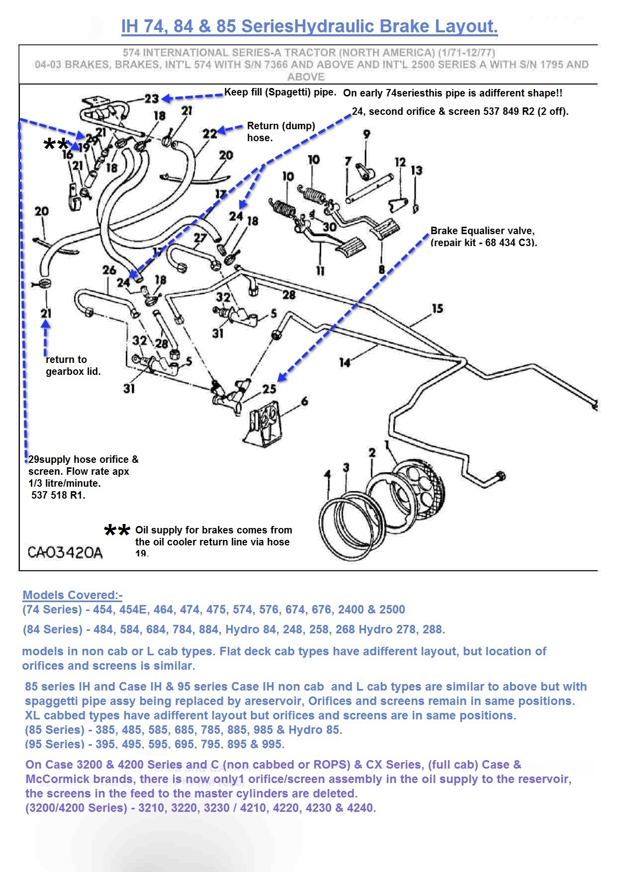

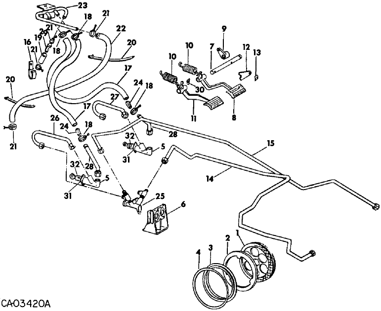

Have a International 574; can't seem to get any brake pressure; have tried bleeding; no luck; any suggestions....Joeander
   / Brakes on International 574 #2
Is on both, or just one..?? Below is an exploded view of your brakes. Click on it, and it will enlarge. If it is just one of them, might be either #24 or #29, depending on which wheel. These are orifices, and screens. Maybe contaminated, and plugged..?? And if just one, maybe the master cylinder..?? Each wheel has one, #5, I believe.
Or if both, #25 is the equalizer for both brakes.
Don't have one, or never worked on one, just trying to see where trouble spots may be in the brake system, from this exploded view.
   / Brakes on International 574 #3
how are you bleeding them?there is a procedure.
   / Brakes on International 574 #4
Sorry to hear you have brake problems, a fairly common issue on these machines!!:eek::eek:
I have attached a document which should help you solve the problem??, any further questions come back to us on the forum:cool::cool:
  • 674 Loss of Brakes.pdf

   / Brakes on International 574 #7
Warming transmission oil, refers to using warm oil to top up the plastic hoses used on the seal leakage test. Pouring warm oil into tubes will allow air in oil to rise quickly to the top of the tubes so you get aset level, (saves time!!).
Dump hose, sorry !! Confusion of terms, this is the return hose that goes from top of spaghetti pipe to top of gearbox as shown in diagram!!
   / Brakes on International 574 #8
some additional information to help !!
