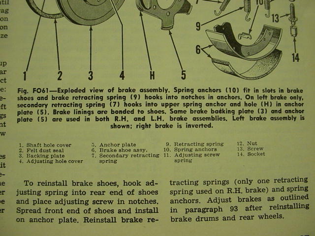

   / Brakes Seizing- 1994 Ford NAA #4
Here is Picture 2
