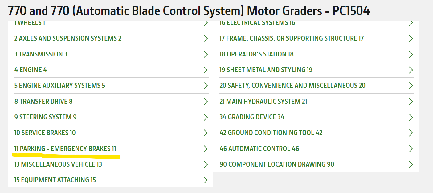

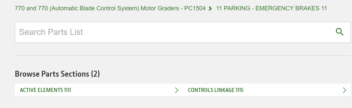

In reviewing TxJim's link. If it's that version the park brake has nothing to do with the trans not going into gear. This system uses a caliper on a spinning disc outside the trans. All it does is stop the trans from turning.
The later cable version uses the parking brake integrated internally in the trans. It will lock out the trans ability to go into gear. The more later versions used electric over hydraulic and also lock out the trans.
   / Brakes won’t release on 770 John Deere grader #9
ovrszd
Thanks for your explanation. I failed to locate another style parking brake control in the only JD parts catalog #1504 for 770. As I previously stated my experience with JD industrial tractors/implements is very limited
