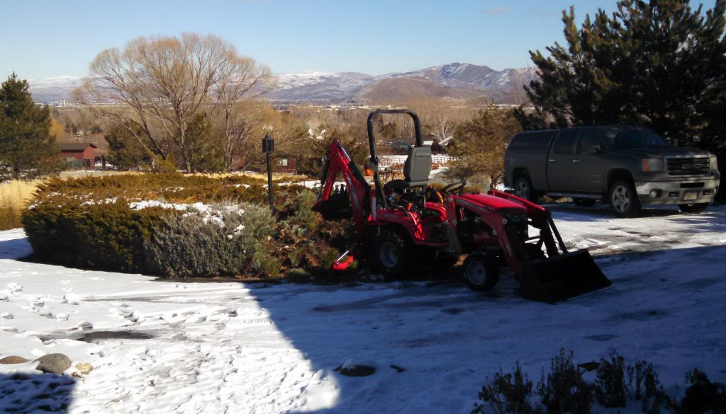

Dealer said maybe the control was not returning 100% to the neutral position. I will check that and see what I learn. If its not that, then it sounds like a replacement seal is needed. btw here are *some* of the junipers getting torn out!

Wow, what view. How far off in the distance are the mountains?
I'll bet the junipers are pretty root bound, probably like digging in very rocky soil.
Hope your dealer can fix the leak.

Thanks. That's a small mountain range to the east of Reno, NV, about 8 miles away. The BIG mountains are behind the property and not in the picture-- our new property backs up to the Sierra Nevada range. If you look closely at the photo there is a white vertical spike above the red building on the left. That's the control tower at the Reno, NV airport. About 3-4 miles away.
