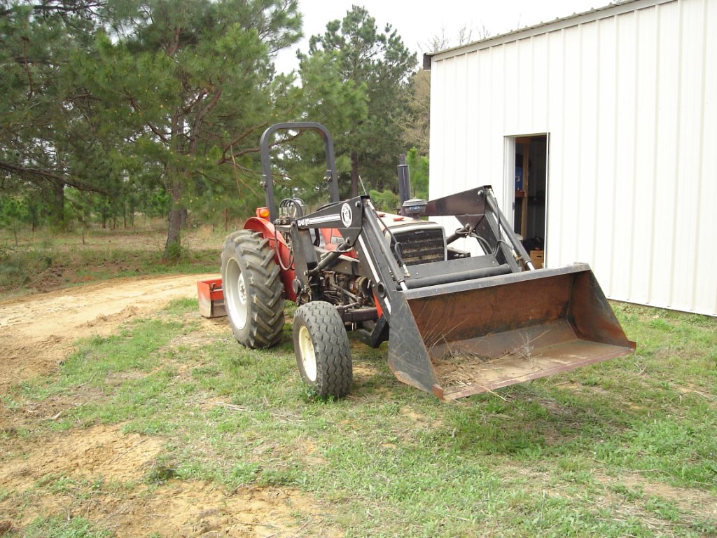

I have had a bushhog FEL for about 7 years now and my uncle has the same type of FEL as mine. We both have not had any problems, they work great. I not sure the model number, but I am running it with a Massey ferguson 231 and my uncle has his on a Massey ferguson 451 I think. I can't remember the price difference but it was cheaper than the Massey FEL. Here is a Pic of mine.
