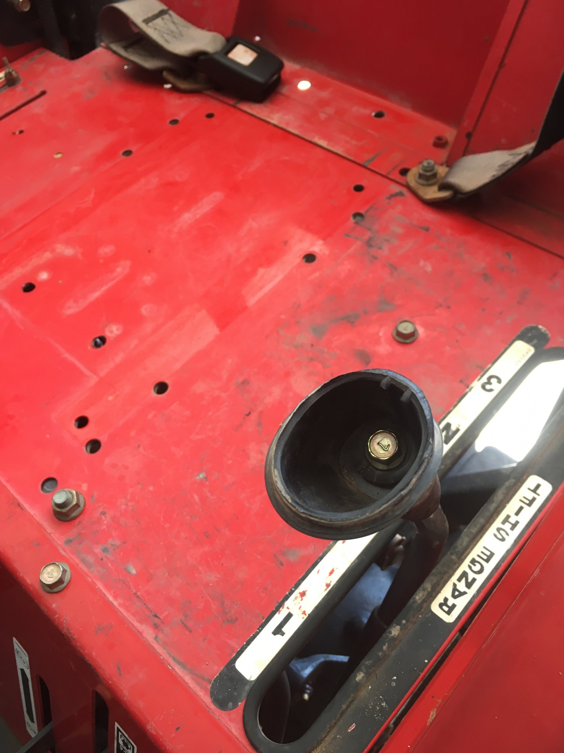

2. Figuring out how to get the knobs off the levers (without destroying them) took a bit of time. I used a claw hammer and block of wood to gently pry the knobs off. The 3-range shifter knob is different in that it has a 10mm bolt under the cap on the knob. (See photo) 3-range shifter knob.JPG

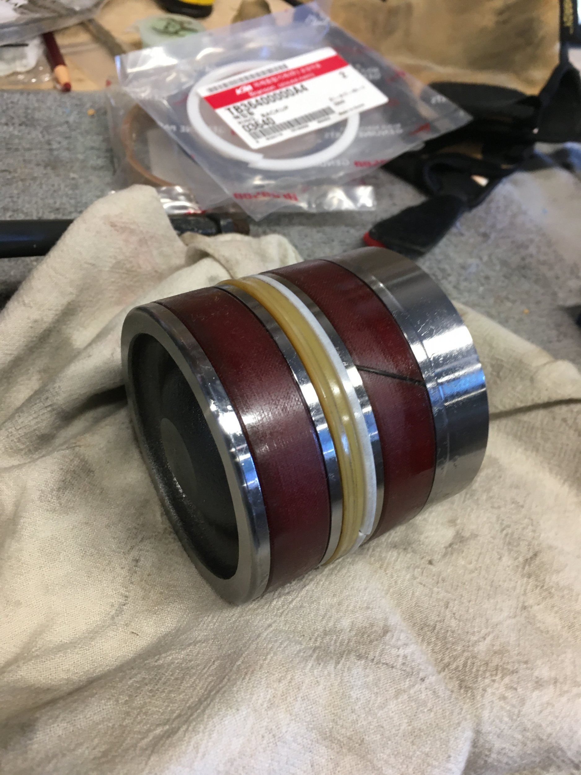

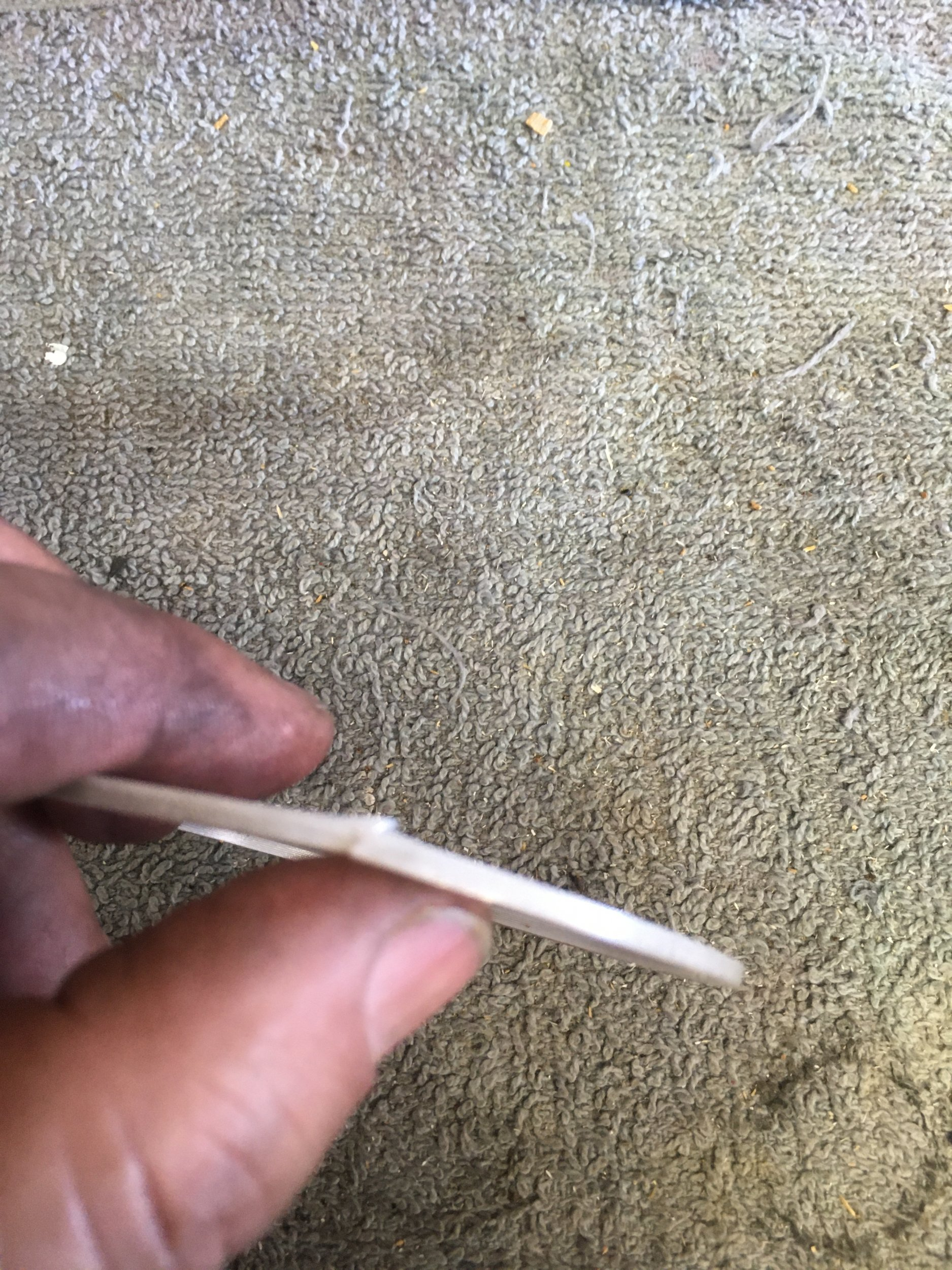

which made me doubt my diagnosis slightly. However, I did notice a slight spur on the little white "backup ring", but I didn't think that was bad enough to cause a problem. (See photo)backup ring spur.JPG

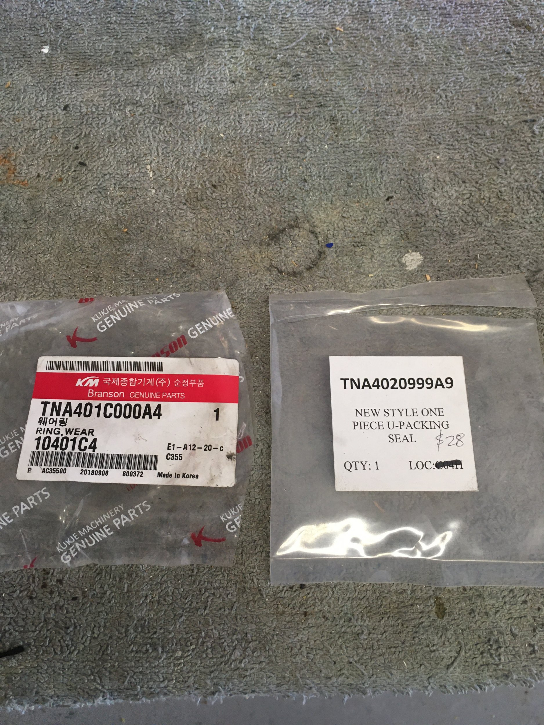

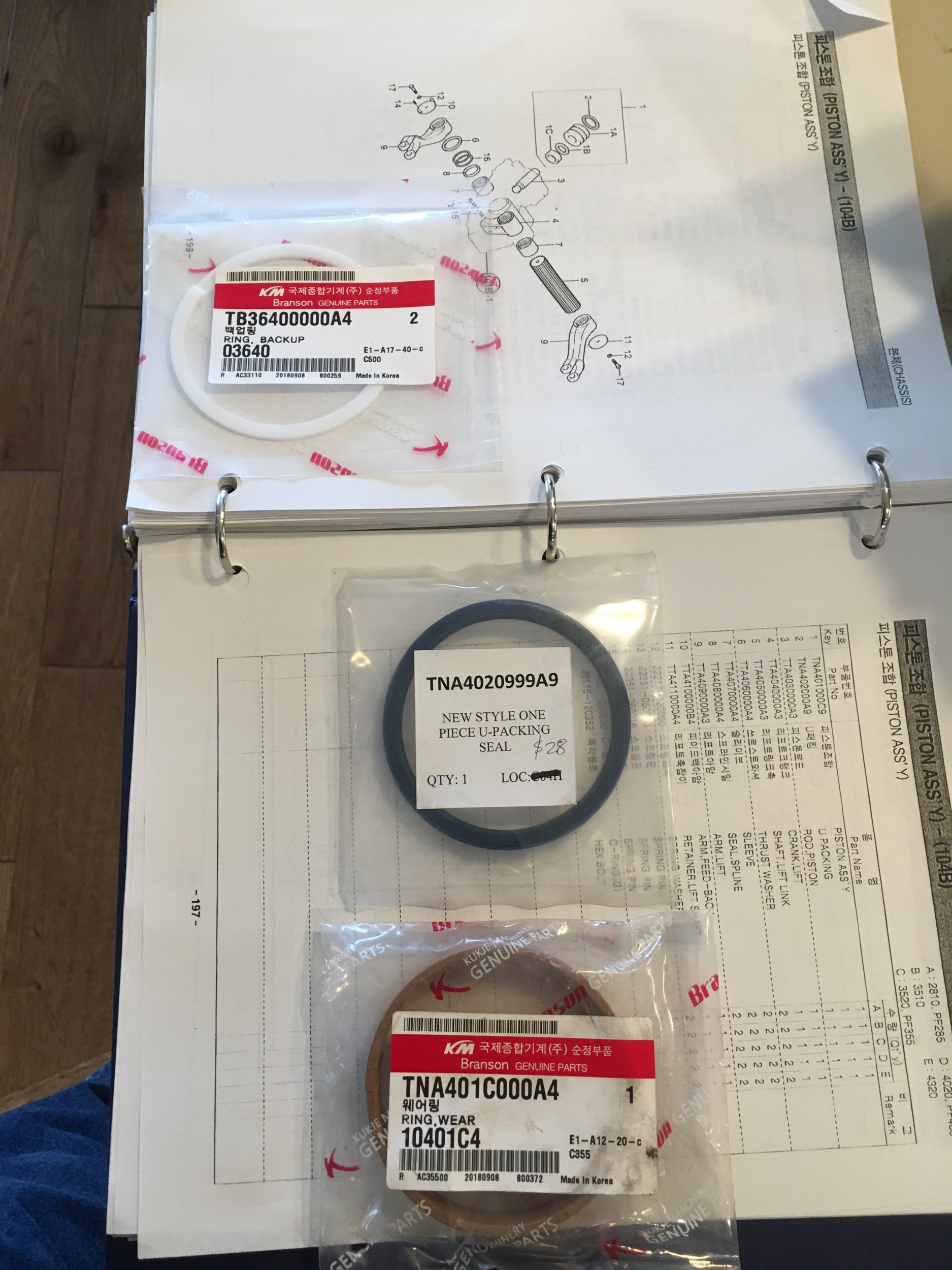

Dillon at Dave's tractor had sent me three rings: one TNA4020999A9 "New Style One Piece U-Packing Seal", one TB36400000A4 Backup ring, and one TNA401C000A4 wear ring. (See photo)TPH piston rings.JPG
However, when I examined the piston, I realized that the new "one piece" ring replaced the old piston ring and backup ring group, so the backup ring IS NOT USED with the new one piece seal ring. Also, Dillon only sent me one wear ring; the piston has two. So, since my wear rings were in good shape, I reused one of my old wear rings with the new wear ring. In short, the CORRECT parts for this repair are: one TNA4020999A9 New Style One Piece U-Packing Seal, and two TNA401C000A4 wear rings. The only two ring types you actually need.JPG

After reinstalling the seat and floor plates and making sure everything was buttoned up properly, I reattached the Gannon box (box scraper) and raised and lowered it multiple times... no more hiccups! I guess the slight spur on the backup ring was enough to break he seal of the piton and cause leak-by. Maybe that's why Branson went to a single ring system.
