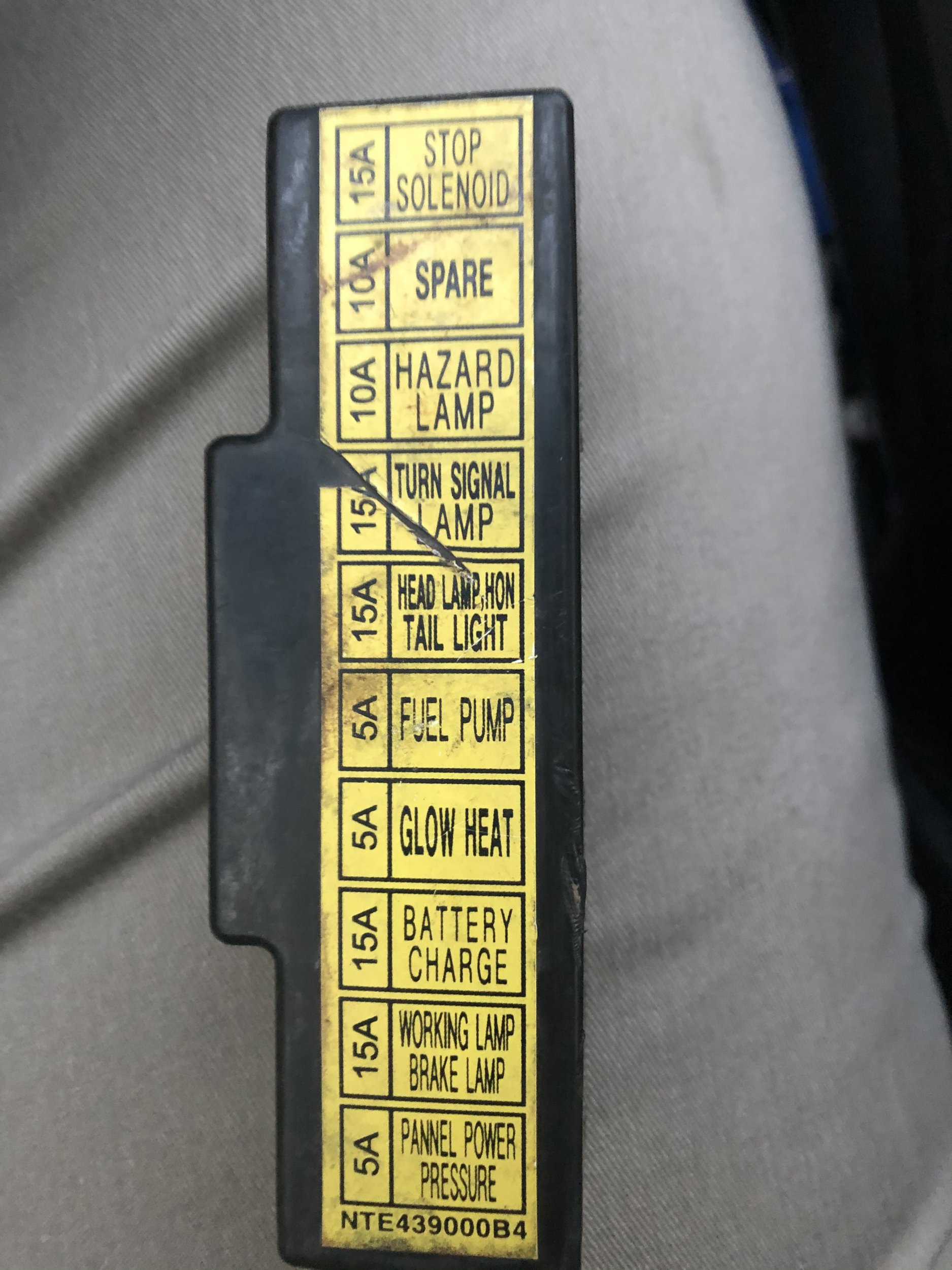

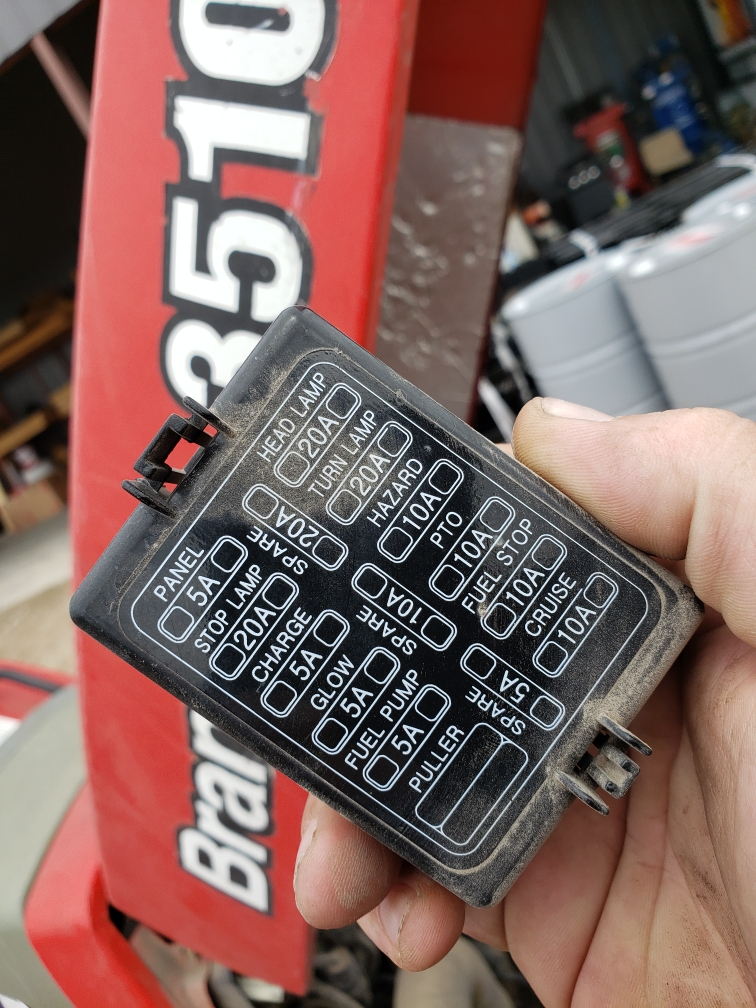

I have an 05 or 06 Branson 3510i and I致e lost the cover to the fuse panel. The inside of the cover indicated which fuse powered what, and I need that diagram. Can anyone direct me to where to find that diagram or maybe take a picture of theirs and post it? Thanks!

   / Branson 3510i fuse panel #5
If no one attaches a picture before next week i have a 3510 coming in to our shop next week for a head job i'll grab a pic of the fuse box or you can check out my post of service manuals look for the 10-20 serie one and it should have the wiring diagrams as well as the fuse box picture.
   / Branson 3510i fuse panel #6
Sorry for the delay guys, customer didn't bring it in until yesterday, hope this helps
