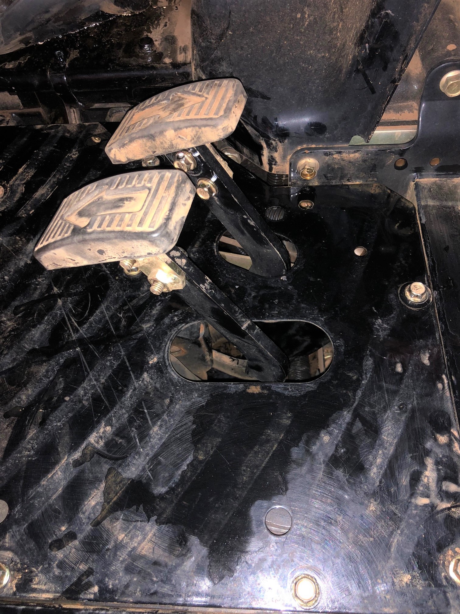

Hi,
I think its been creeping up on me but forward is now slower than going in reverse, any speed. Crawled underneath, had my wife work the forward and reverse pedals and I can see that reverse is going the full length of the pedal movement but forward isn't... I can see the wear markings for how much the pedal use to go in forward and its not going that far anymore.
There must be something adjustable that has backed itself off or such...pushing the reverse pedal it feels like you could keep going if you really pushed hard... in forward it feels like pushing against a wall.
What do I need to adjust and how do I get to it?
Much appreciated for the help.
-Rob

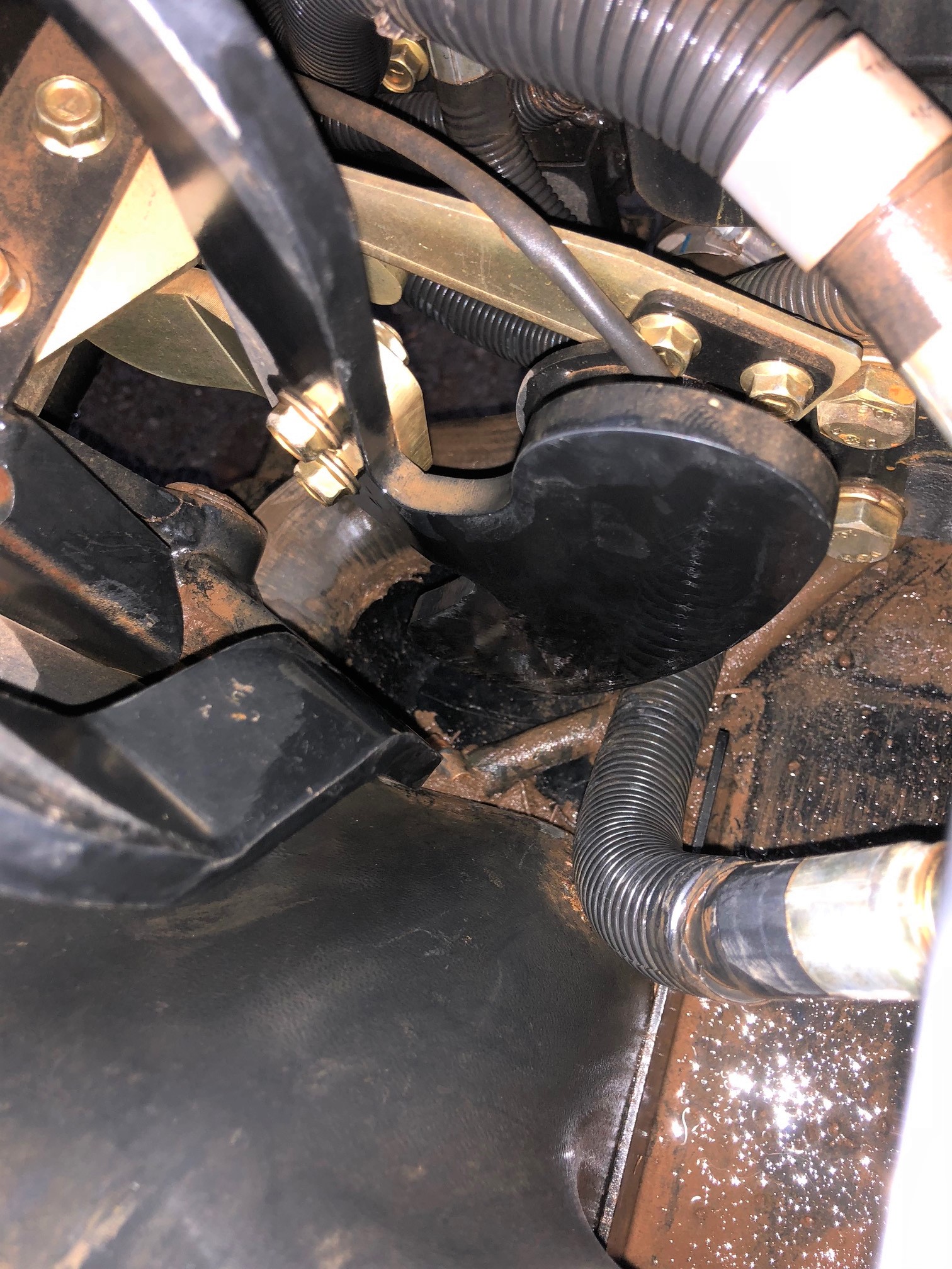

Figured it out, hard to get a good photo but if you see in the first, how much space is around the pedals, you can imagine over time how much dirt/mud can fall down around the pedals. The issue was hard packed mud in behind of the swing plate attached to the pedal. When you push the forward pedal forward, the swing plate goes backwards, right into the rock hard mud. Mud that goes below the pedal really doesn't have any place to go... the fuel line routes around there blocking its exit.
It took taking off the plate under the rubber mat and the protective foot glass off to be able to see what was happening with the swing plate attached to the forward pedal. You wouldn't be able to get at it from underneath. I used a long handle flat tip screw driver to get it out and wash it out with a hose over 10 minutes. A lot was caked in there.
Live and learn.
