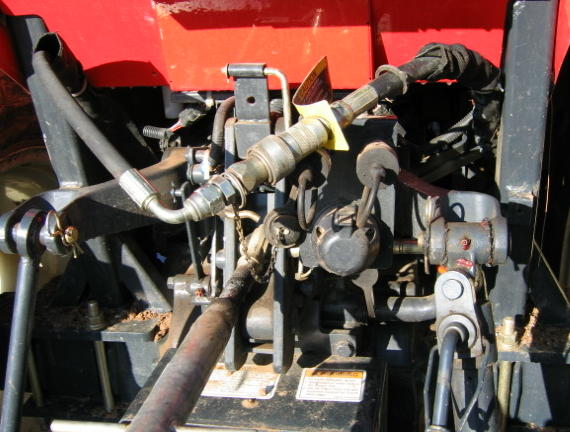

Some of the machines come pre-piped with rear hydraulics and a towing socket...get that if you can.

The century has an option which cocnsists of rear hydraulic connections and a towing plug...its a nice option I didnlt thinkI'd need but I did end up using it...glad I got it.

If you think you may ever need the extra hydraulics get them now as it will be cheaper than adding them later. Here is a picture of the extra hydraulics on the back (excuse the dirt, she has been getting a lot of workout lately). I plan on getting a 3-pt log splitter in the future so I am glad the hydraulics are already there.
I have R4's and have been happy with them. They are supposed to be the best for loader work and so far that is what I have done the most with on my tractor. I was stuck once with the R4's. I could still move back and forth I could just not climb out of my own ruts back up the hill. I do not think ag tires would of made a difference here. The wife in the old jeep was just enough to get me turned out of the ruts.
