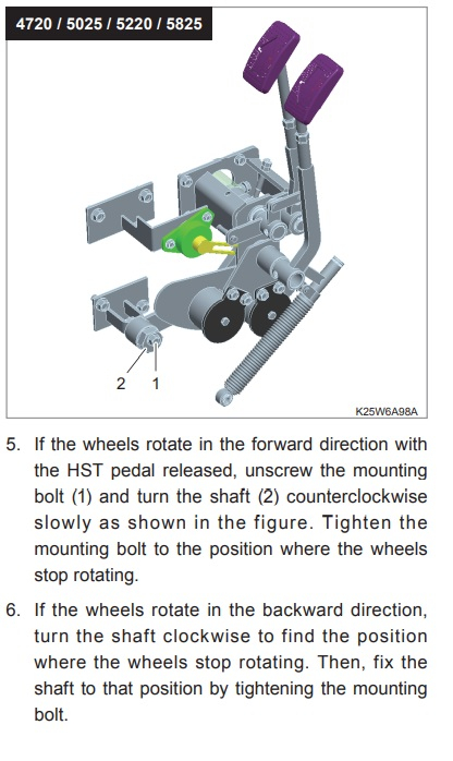

Can someone post some pictures of the linkage for the petals back to the transmission. Sounds like the two problems could be related.
Somewhere along the linkage there may be nut on a pivot point that allows adjustments to the petal tension. Cougs may be set too tight and Ceaster may be set too loose. Just a though.

Here are some pictures out of the manual that show the whole set-up. I would mention none of this stuff is easy to access.

Thank you for posting that. In my case the cam that controls neutral position is working fine, the pedal springs back into position as expected, and I released tension off the spring to avoid fatigue. I didn't get a chance to adjust the magnet distance to 1.5mm yet, but I would think that butting the magnet almost up against the plate would only make it stronger. There's always an amount of pressure coming back on the hdryo pedals when the machine starts to bog down going up a slope or the implement you are pulling causes resistance, that seems to be when the magnet can't handle holding position, I can watch the RPM's steadily climb down when in cruise control just going in a straight line on even terrain.
I will adjust it once the weather we are having here calms back down and I will post a picture of the magnets and how they are fitting up.
