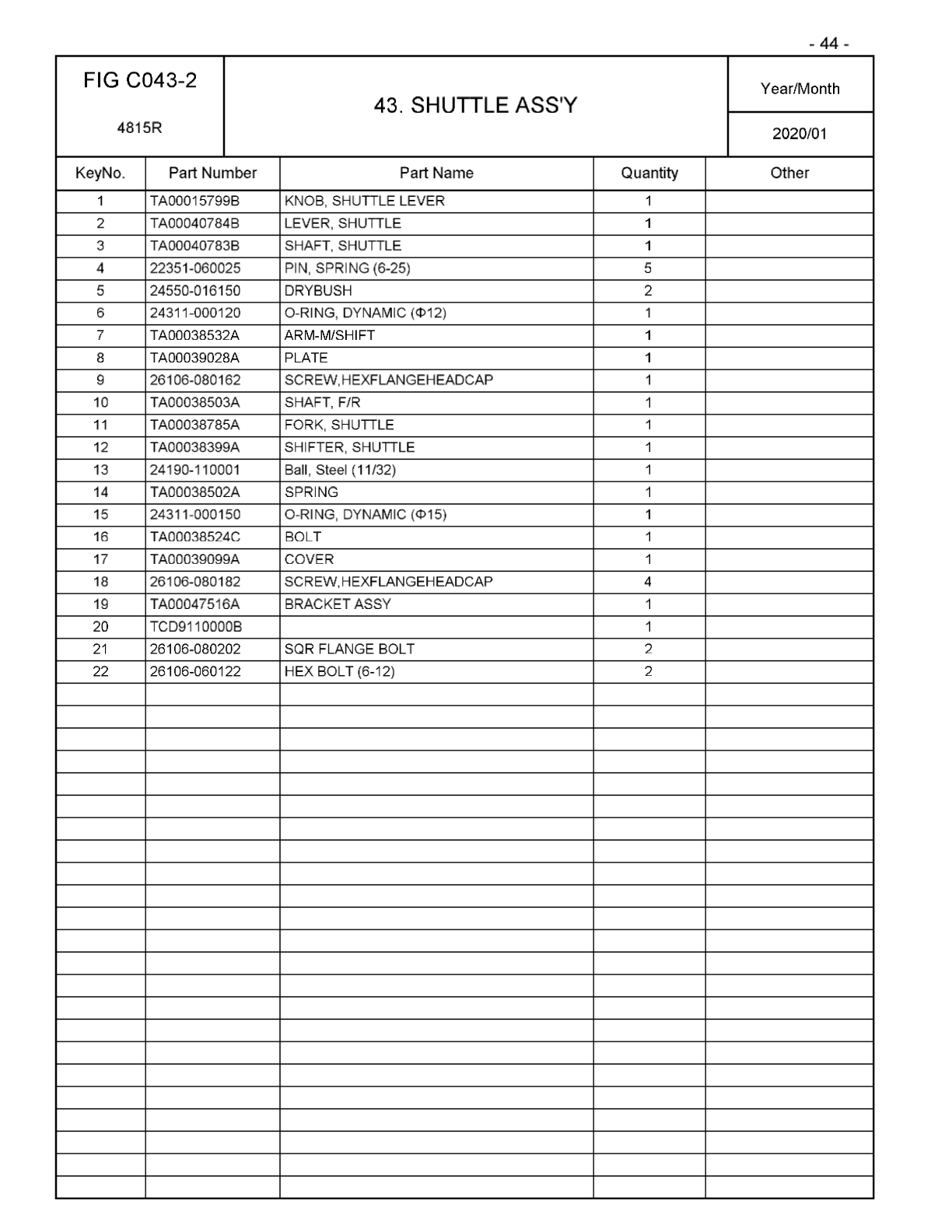

I have a Branson 4815r shuttle shift stuck in reverse. The shifter won’t come out reverse and go into neutral. Please help

First get under the tractor and make sure that there isn't a stick wedged in the shift linkage.
Then follow the shifter rod down to the floorboard and make sure the shifting fork is aligned and in proper position.

The shuttle linkage on this tractor is a straight shaft all the way to the bell housing. Following the shuttle linkage down to the transmission, you'll see a square plate on the side of the transmission. Try remove and see if you spot something there.
It may or may not help your issue but at least it's provides somewhere to look at the linkage inside the bellhousing. There is a small lever and a U-shaped part where the lever pushes/pulls the rod back and forth. This rod is the one that has the fork attached to move the shift collar back and forth between forward and reverse.

This may help,
it's a fairly simple linkage but it is a mechanical shuttle linkage.
Many people abuse these shuttles by trying to operate them like a power shuttle.
They are a synchronized mechanical shuttle.
The foot clutch must be used and it's easier on every component if the brakes are used to stop movement, instead of the syncro's and clutch disc.
