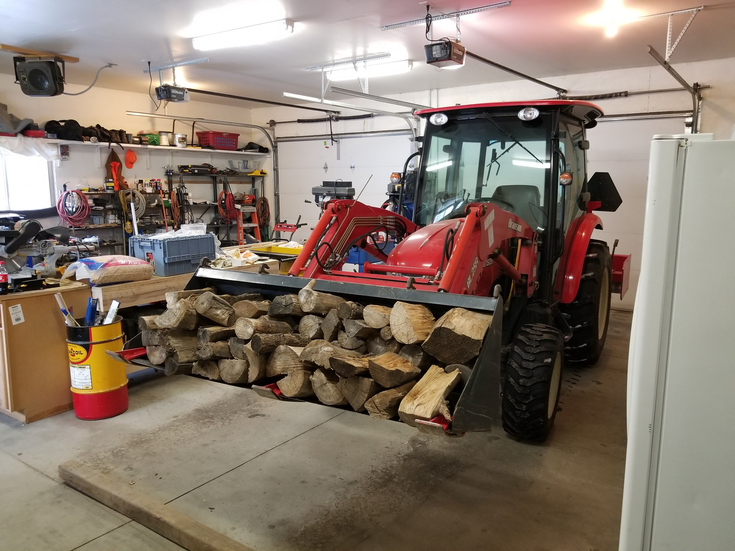

Yes that would be awesome. Appears to be same cab
   / Branson 4820ch actual height with cab and ag tires #6
My cab is 94" to the highest point on the cab.
My garage door (in the picture) has a 97" opening.
This is on a tractor with R4 tires, not R1 Ag tires. Just wanted to be clear on that.
   / Branson 4820ch actual height with cab and ag tires #7
I have a TYM T574 and I believe it is pretty much the same as the Branson 5520.The height of my T574 HST cab tractor is 99.6 inches according to the owners manual.
Hope this helps.
