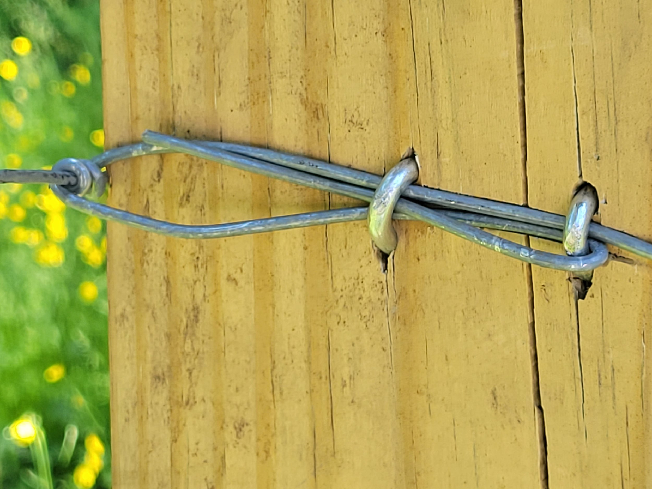

Well not being properly frugal An extra staple? If I were fencing miles of land, it'd matter I guess.
This is how I'm terminating line.
   / breaking the rules, buttercups in the background #2
I'm a firm believer in using what works. 👍
   / breaking the rules, buttercups in the background #3
As wood ages, staples loosen up. I have them pull out lots over the years. I always twist wires. Have for 50 years.
   / breaking the rules, buttercups in the background #4
Id bend back the tag end and spend the money on another staple in between the other two.
   / breaking the rules, buttercups in the background #6
I used a similar style for UNSTRAINED tie offs when I was farming.
   / breaking the rules, buttercups in the background #7
Depends on how frisky the bulls are.
   / breaking the rules, buttercups in the background #8
I always go completely around the post and twist the wire onto itself top,middle and bottom.
I do the same, had to many fence get saggy from staples only.
