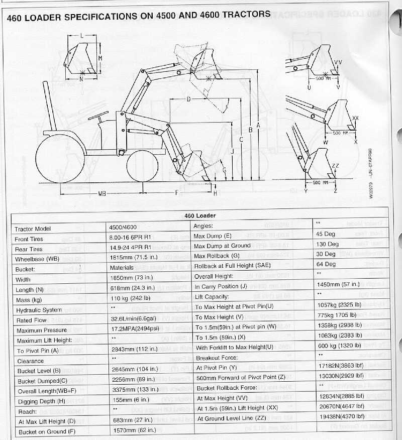

Here is a copy of the spec page for a JD460 loader. I think that it is clear from this that Deere defines breakout force as the boom lift capacity at ground level (Force vectors Y and Z in the drawing). If breakout force was a function of bucket rollback than the force at Y, the pivot pin, would be zero. You will notice that the bucket rollback force, which is only specified at a distance of 500mm forward of the pivot pin, is actually greater than the breakout force. Maybe Kubota specs their loaders differently. Hope this clears everything up.
I love the smell of diesel in the morning. /w3tcompact/icons/smile.gif

   / Breakout force? #7
Hi MJB, /w3tcompact/icons/smile.gif
Just want to "second" your opinion.
I also have the JD460 loader, and I interpret the spec sheet the same way you do. That "zero-force at Y" tells the tale. /w3tcompact/icons/wink.gif
