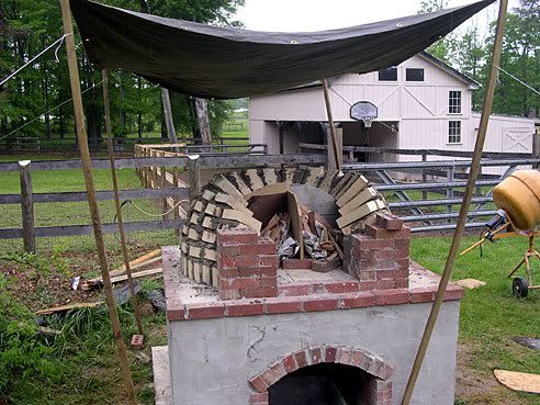

I was told to start on the end to get everybody's attention. Following that advice, this is the output of a project. We are baking:
Pizza:
Czech rye bread:
/ Brick oven
#2

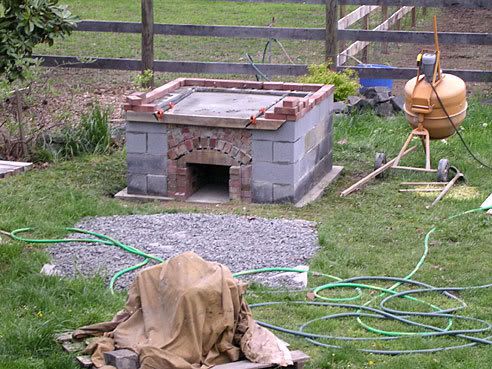

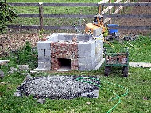

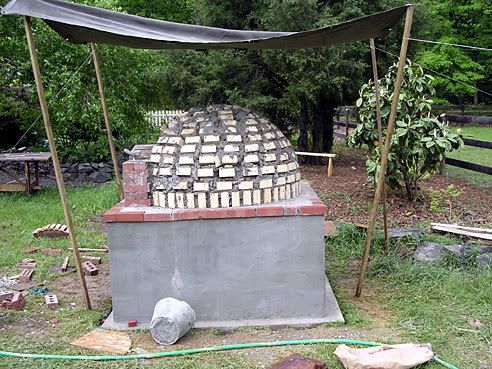

This is not how it started, but it is the oldest picture I could find.

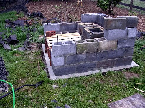

Building the base, using leftover blocks and parts of a chimney:
/ Brick oven #4

/ Brick oven #5
I really love the concrete dome! Looks great, functional and I can taste that bread from here:D

I have a copy of "The Bread Builders: Hearth Loaves and Masonary Ovens" by Daniel Wing and Alan Scott at the top of my reading list. Did you use a set of plans or go with your own design?

/ Brick oven

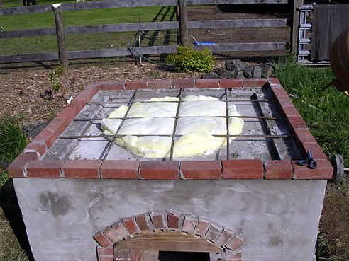

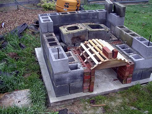

Ready for rebar and bottom insulation:
I was not sure if the insulation is going to work, but I done it anyway. The logic was the dome will be standing on the sides and middle supports only a layer of firebricks and the concrete is about 2.5" thick above the fiberglass.
Base is finished:
/ Brick oven

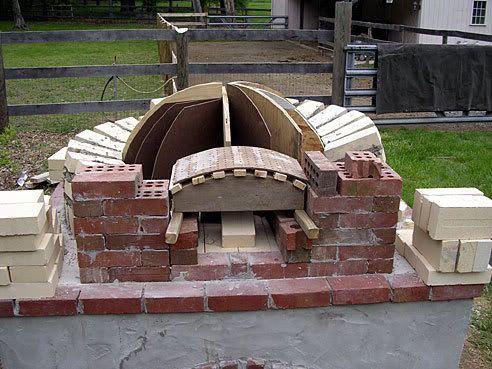

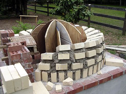

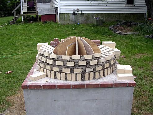

I used regular firebricks and mixture of fireclay (from Indiana:)) cement and sand. That stuff smells like a pond mud and it is very sticky. If you keep bricks dry, they hold in place without support almost all the way to the top. The wooden shapes are needed to follow the arch.
The top looked like a hedgehog with bricks sticking up in the air:
/ Brick oven
#11

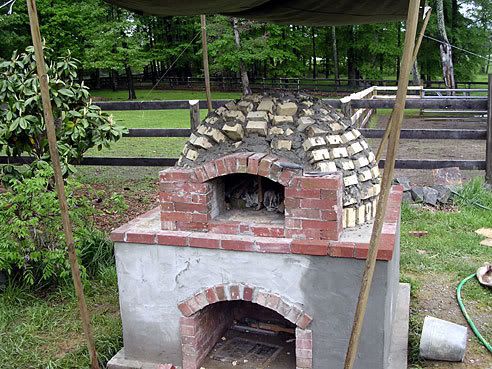

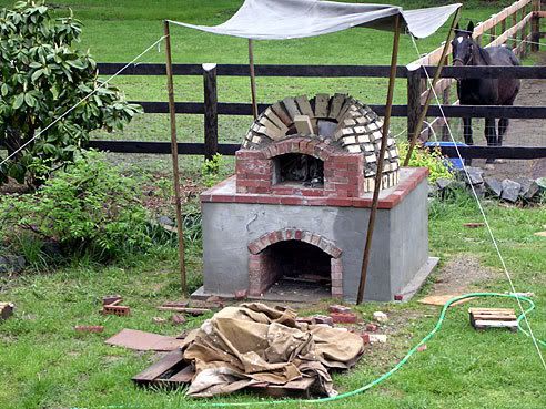

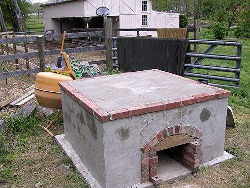

I filled the back cracks with more fireclay mixture:
Tried different tools, but hands worked best for this part.
When it all dried - took 2 weeks or so , I stuccoed it with mortar from Home Depot.
I would like to paint it too, but I leave the artsy job to my wife:)
/ Brick oven
#13
Overall it was fun to build and it is great fun to use. It takes a while to heat up, but when it gets going, it goes:) We used it for bread and pizza and some sausages and such.
Costco pizza was done in 2 minutes or so, bread takes 3/4 of an hour - and we love to sit in front of it at night, just watching the flames.
And here is my bread receipt:
5 cups of bread flour
3 cups of rye or whole wheat flour
2 spoons of salt
4 spoons of dry yeast
2 spoons of carraway seeds (in my country we call them kmin/cumin)
4-5 cups of warm water
Mix it in a mixer for 15 minutes or so (Kitchen Aid for me), let it grow for an hour, dump it on cooking stone and bake it.
/ Brick oven #14
That is awesome. great project - thank you for sharing!
/ Brick oven #15
That's great! If the economy tanks, you've already got a business going. :)
Either baking bread, or building ovens.
You need to build a Tandoor next. Although if Wiki is correct the oven you built is an improvement over the Tandoor.
/ Brick oven
#16
Thank you, gentlemen. I am getting ready to dry deer jerky in the oven this week.
