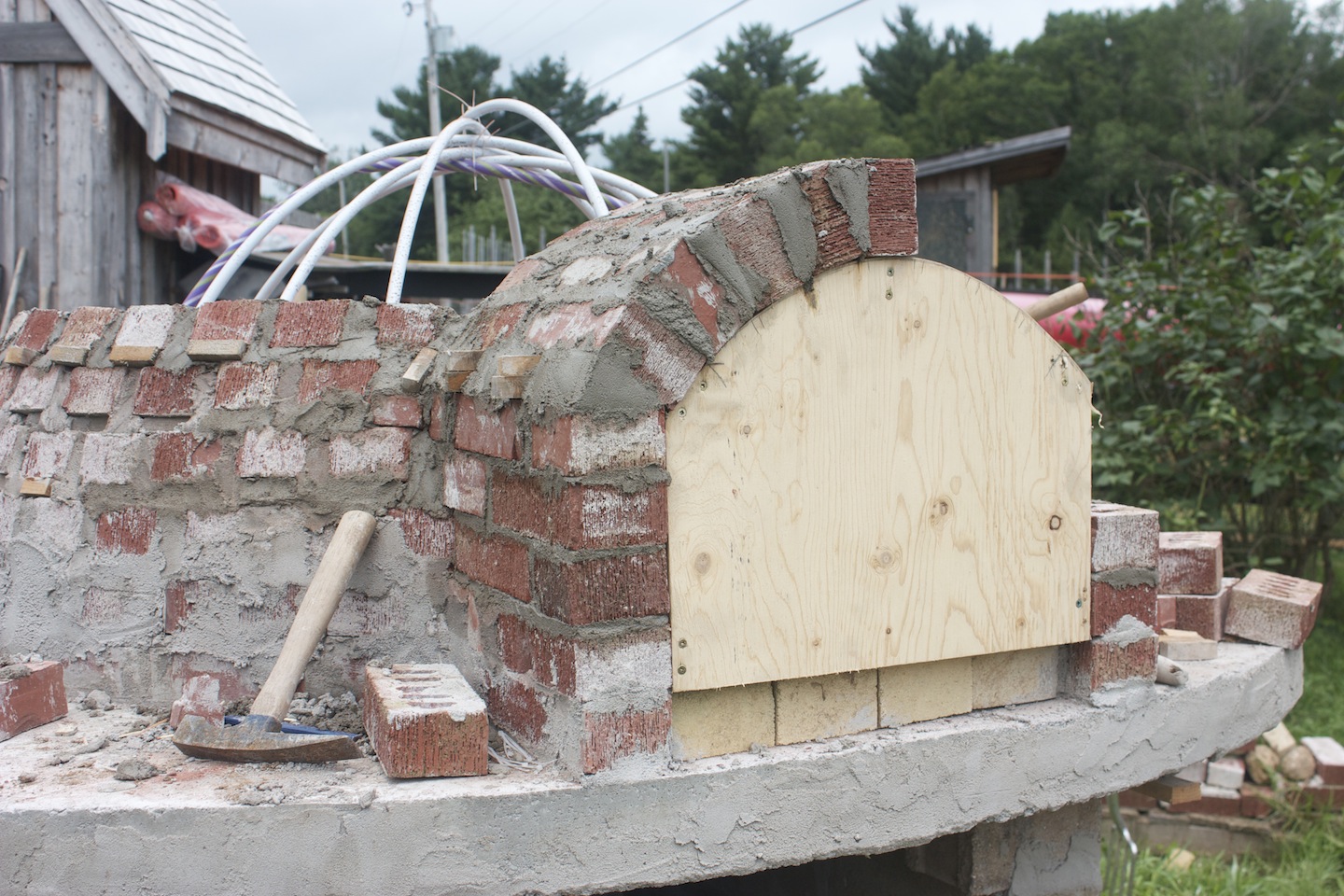

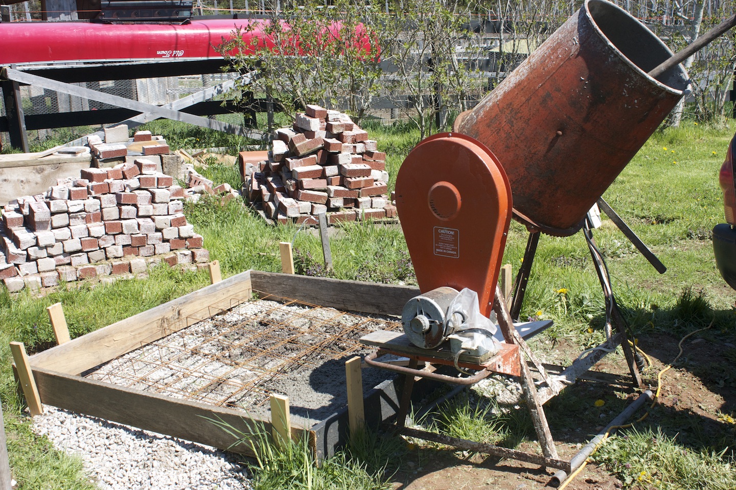

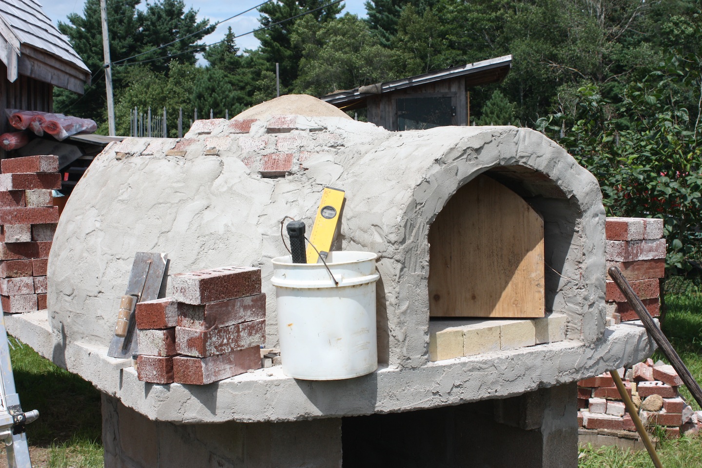

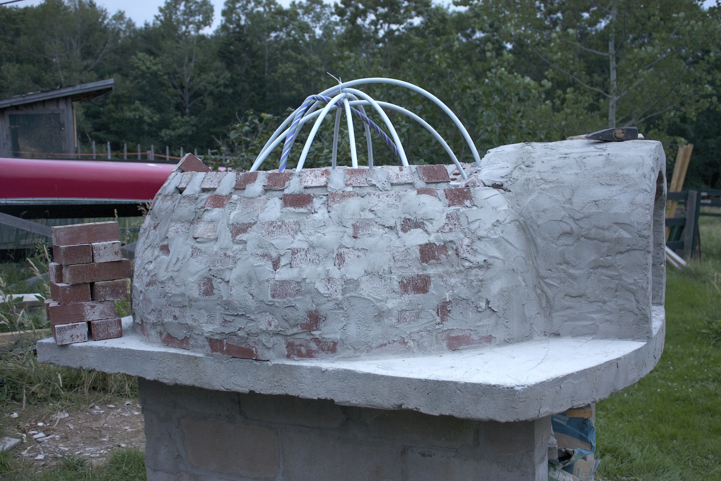

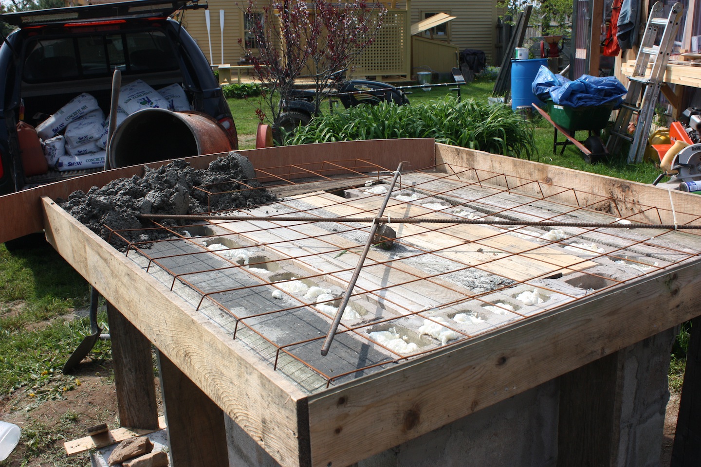

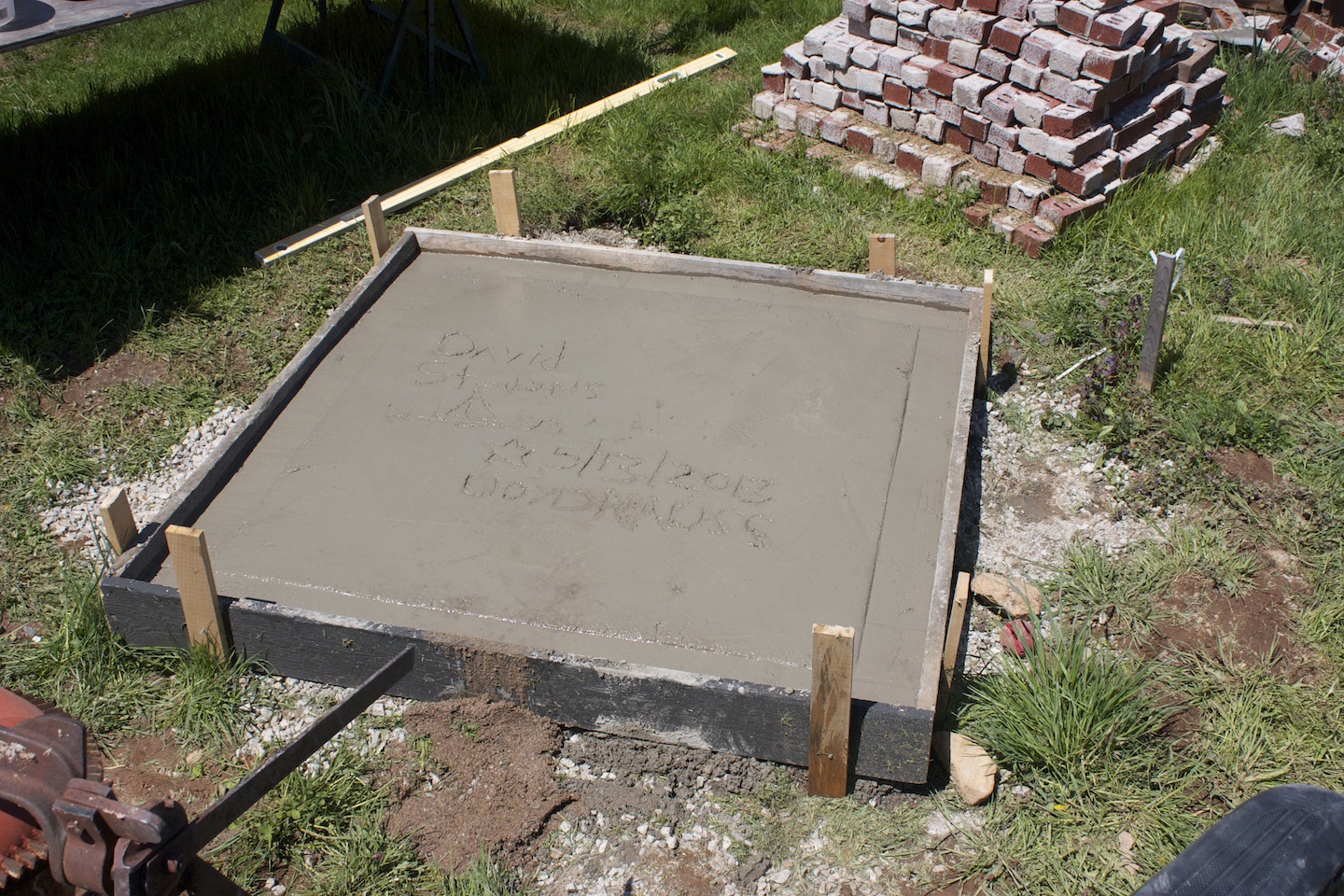

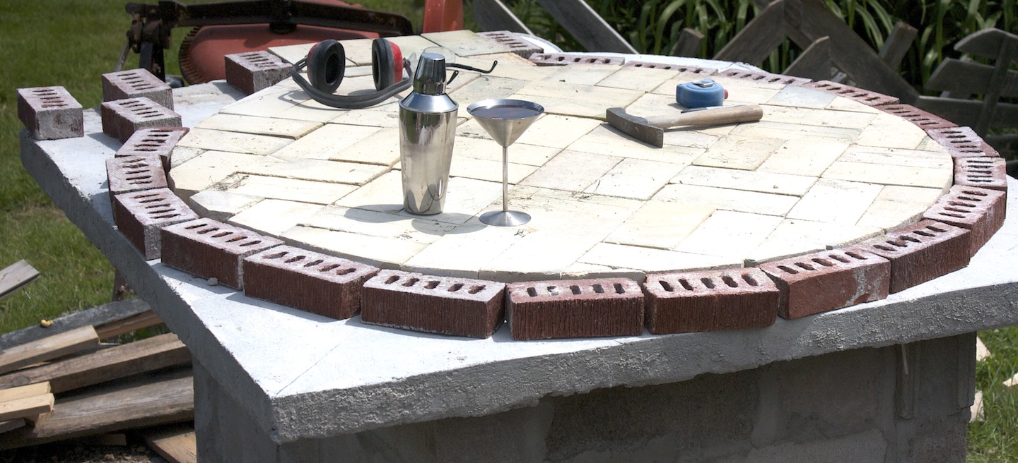

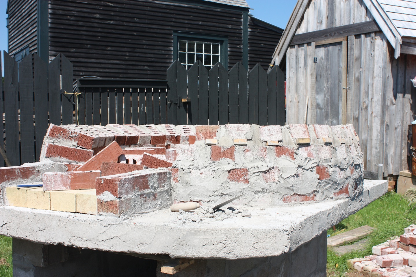

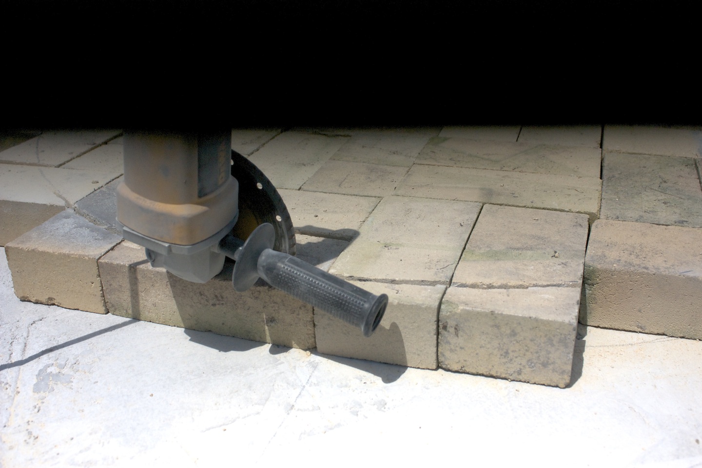

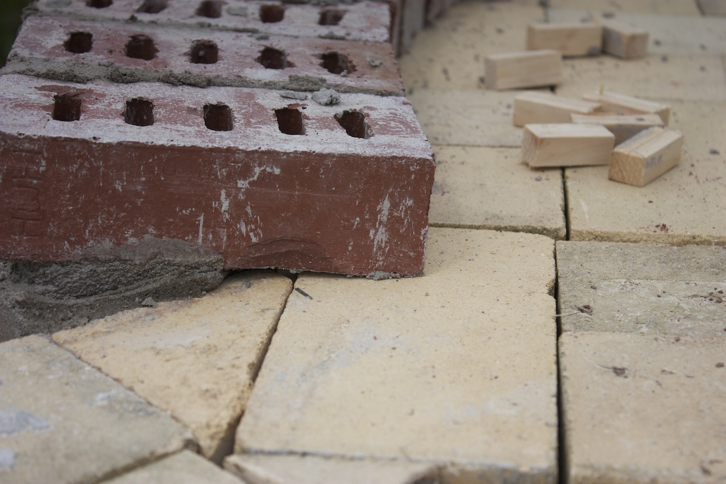

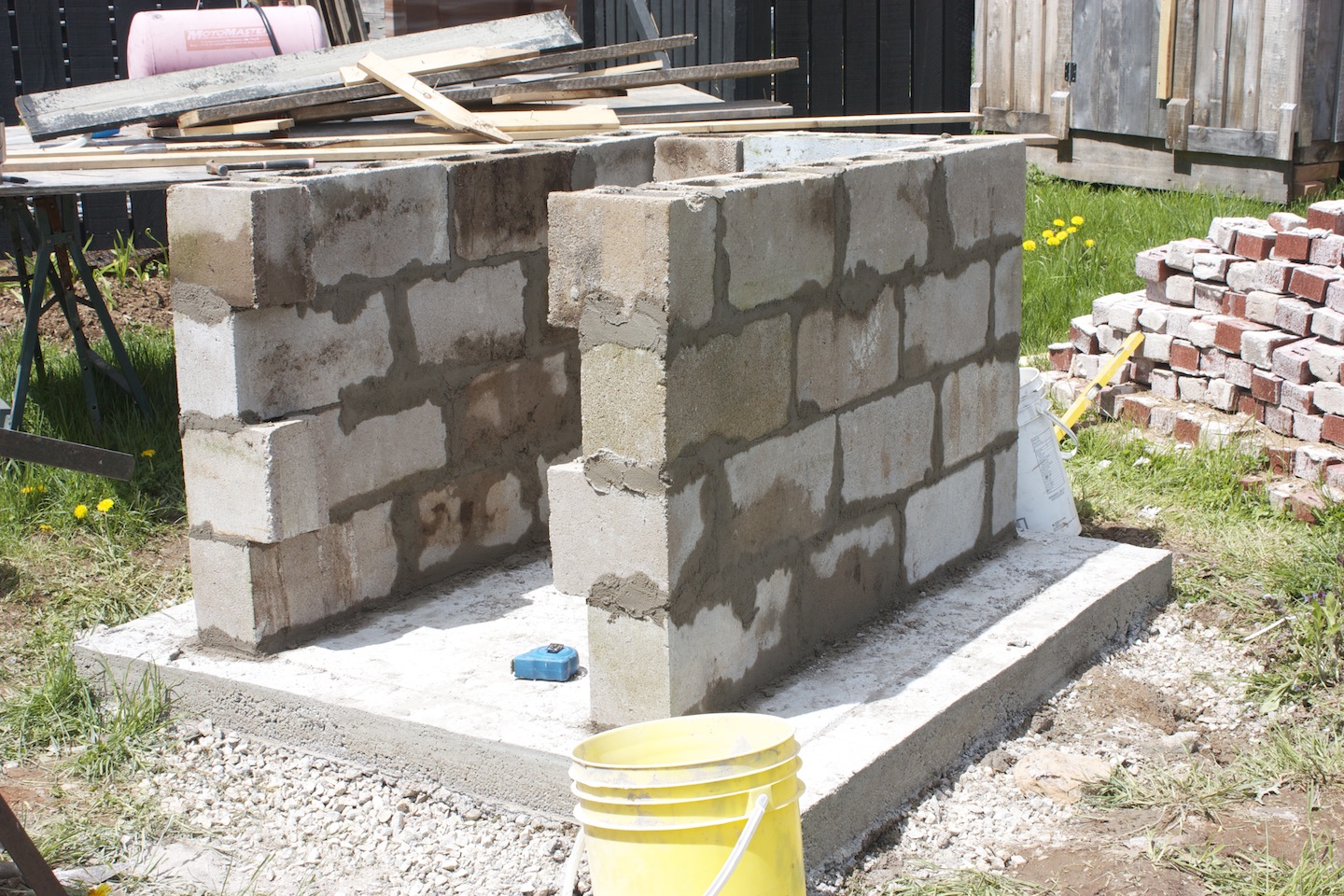

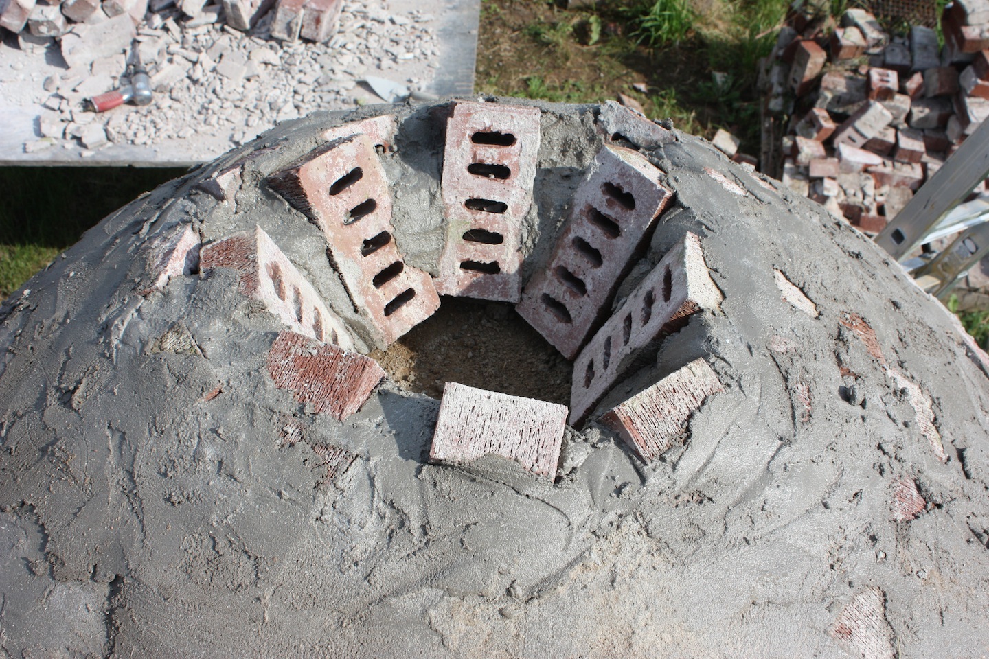

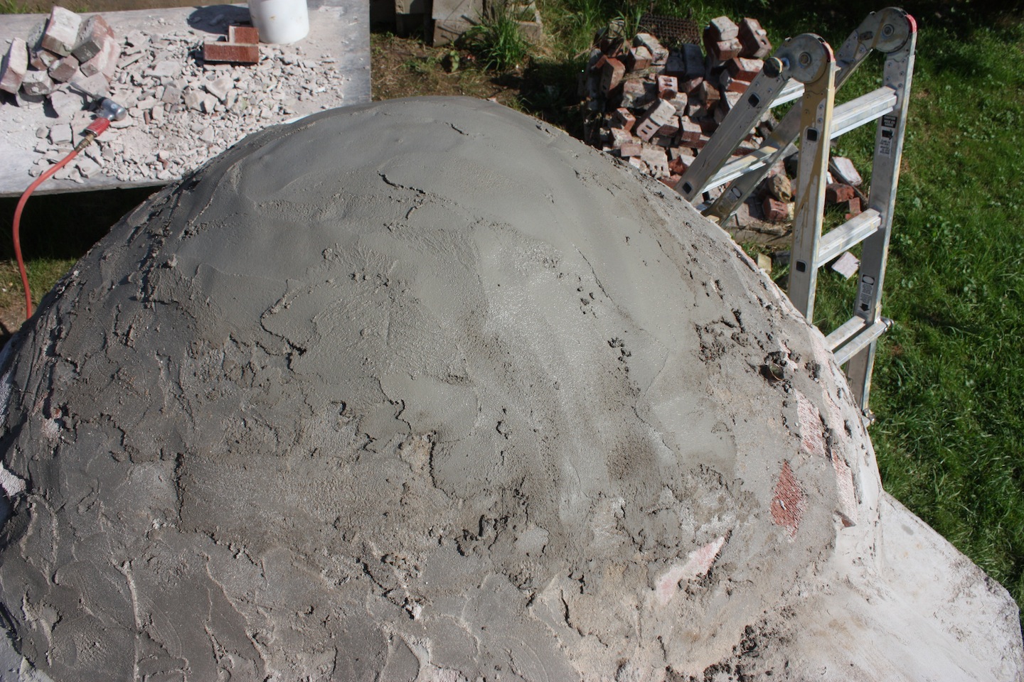

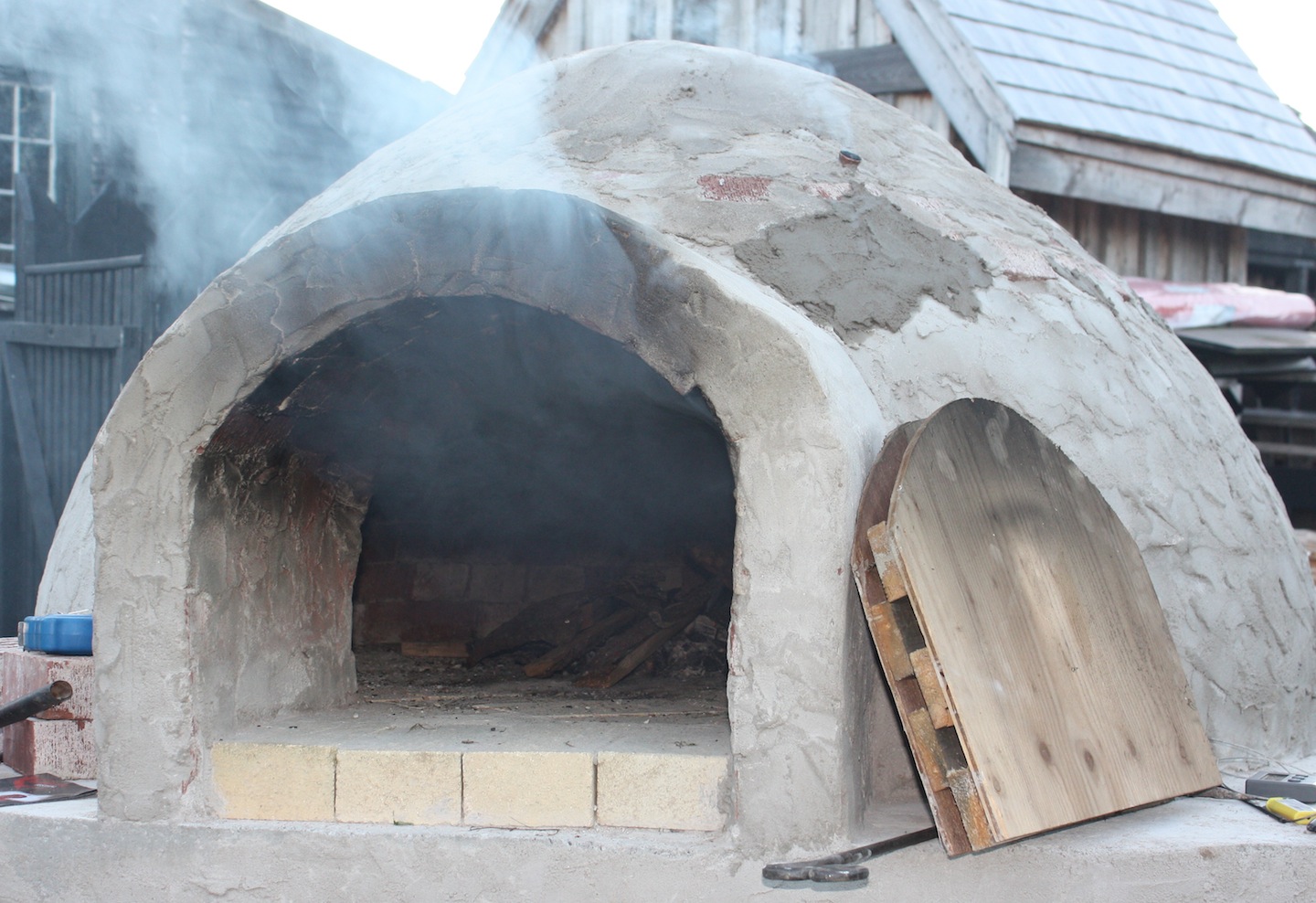

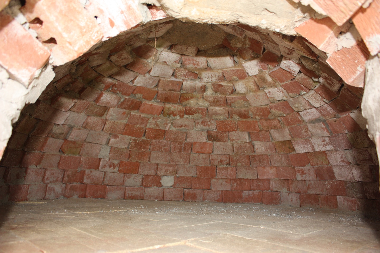

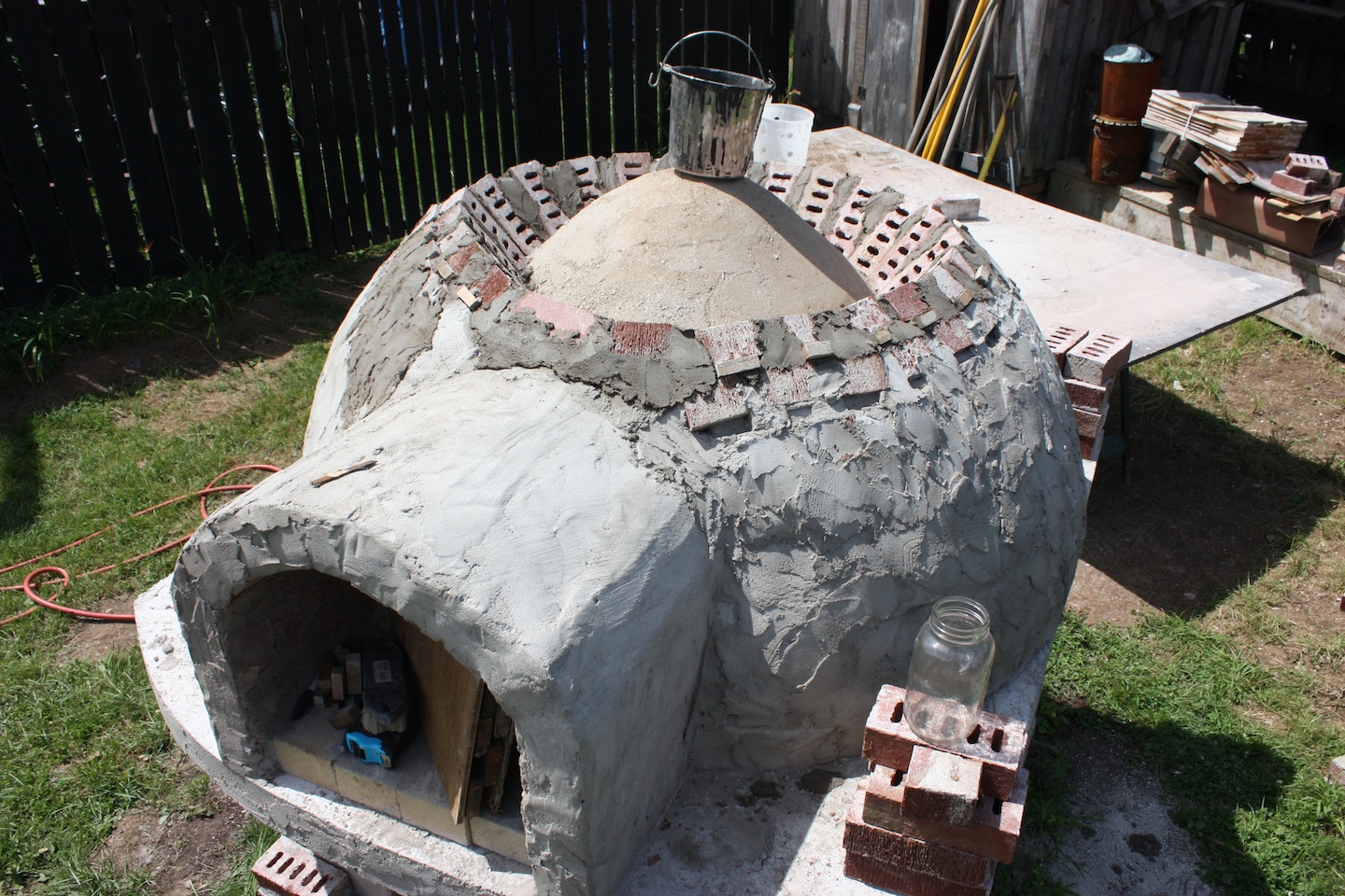

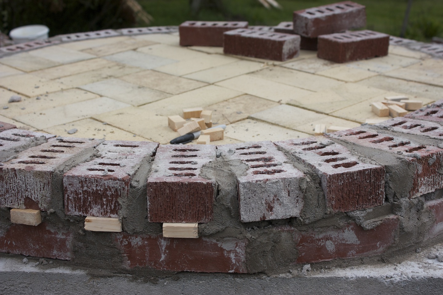

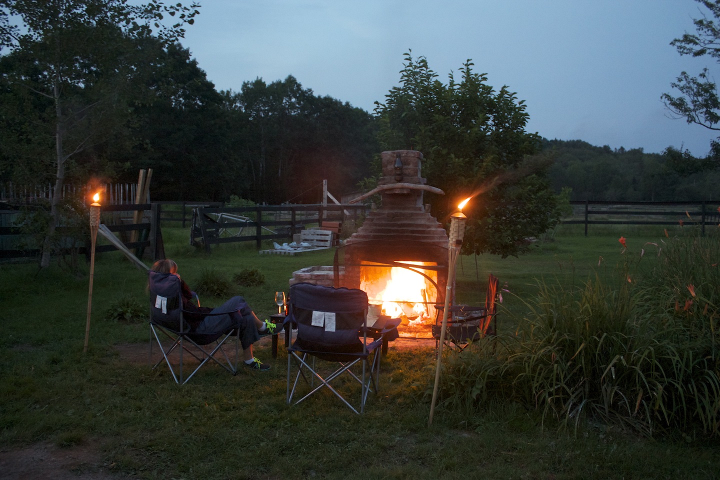

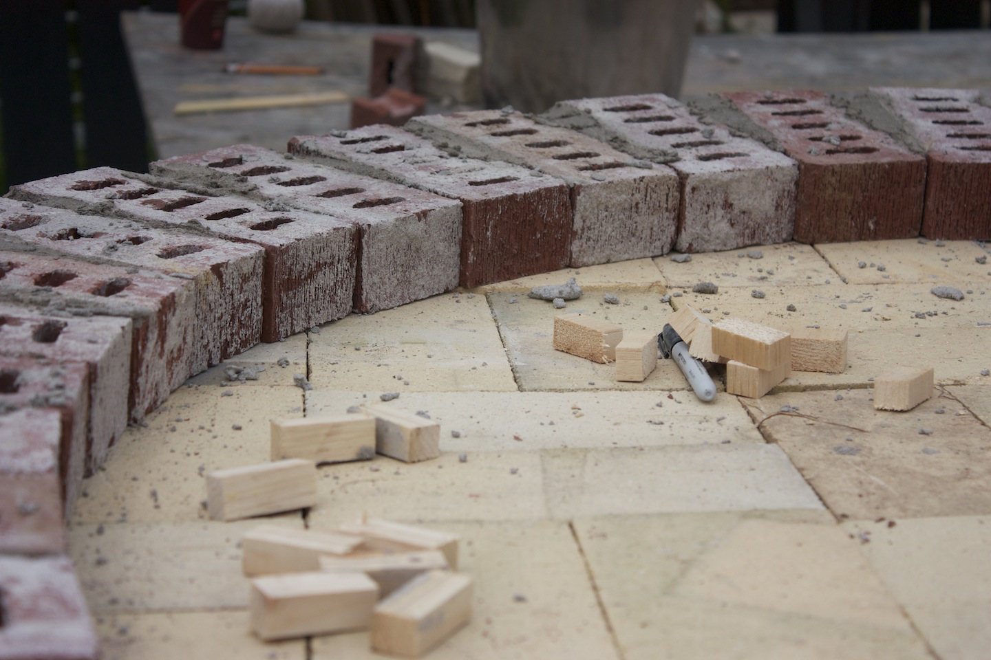

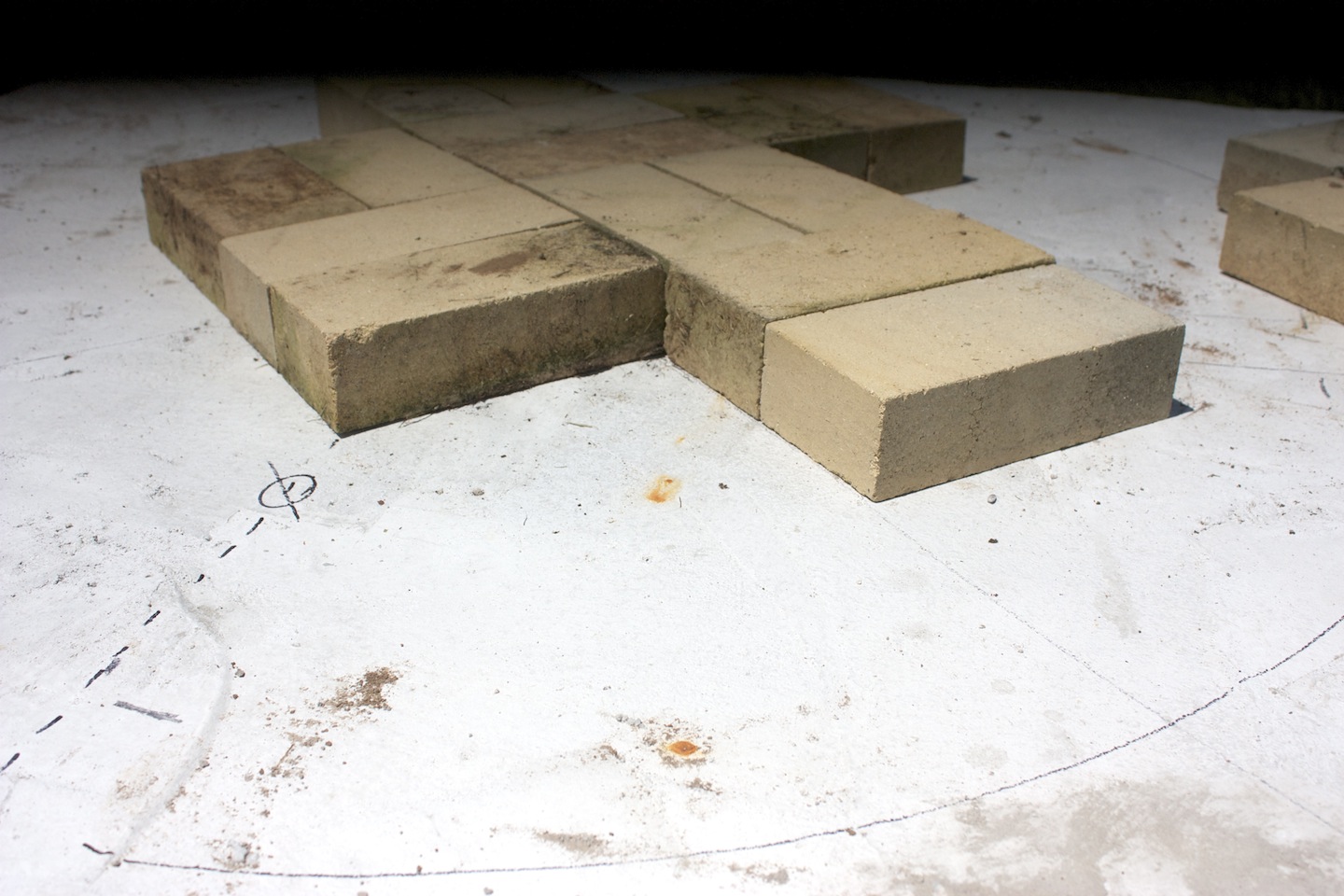

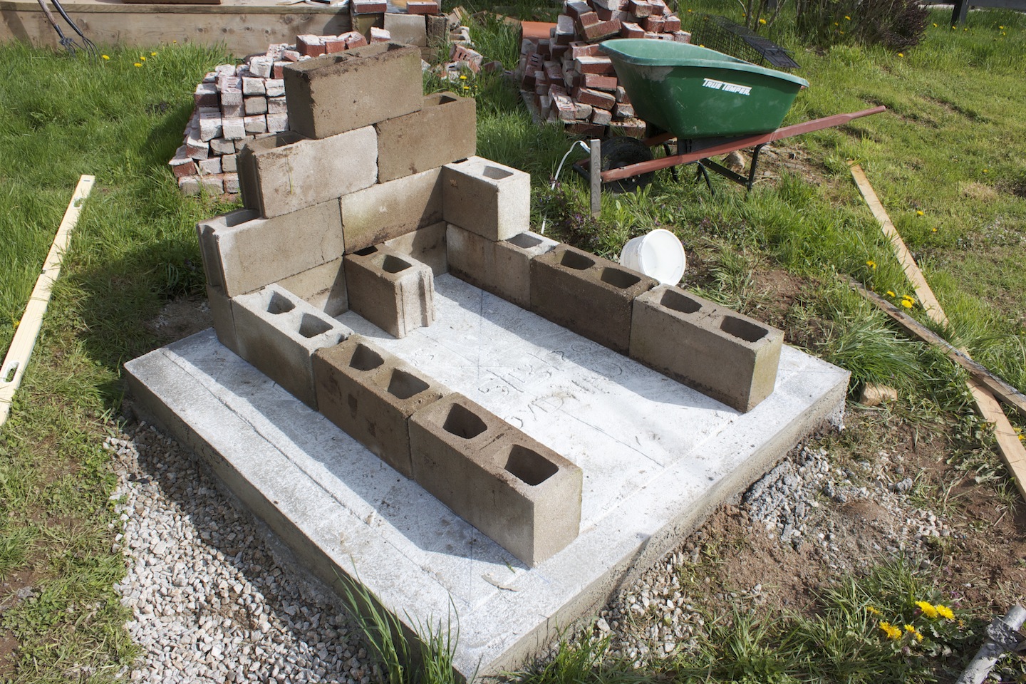

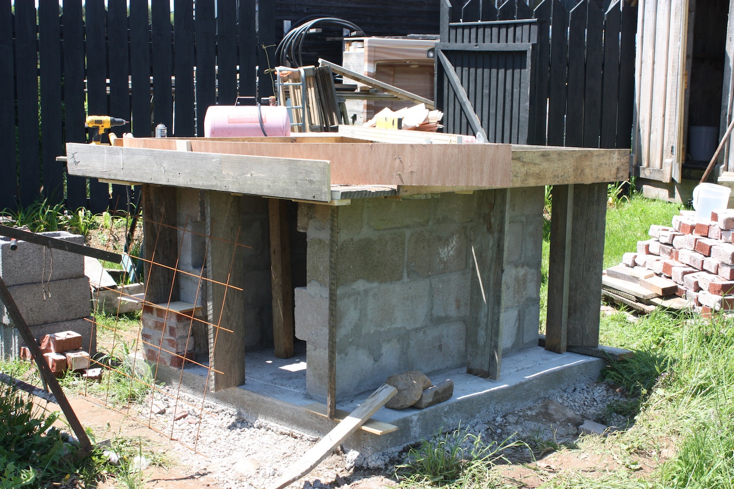

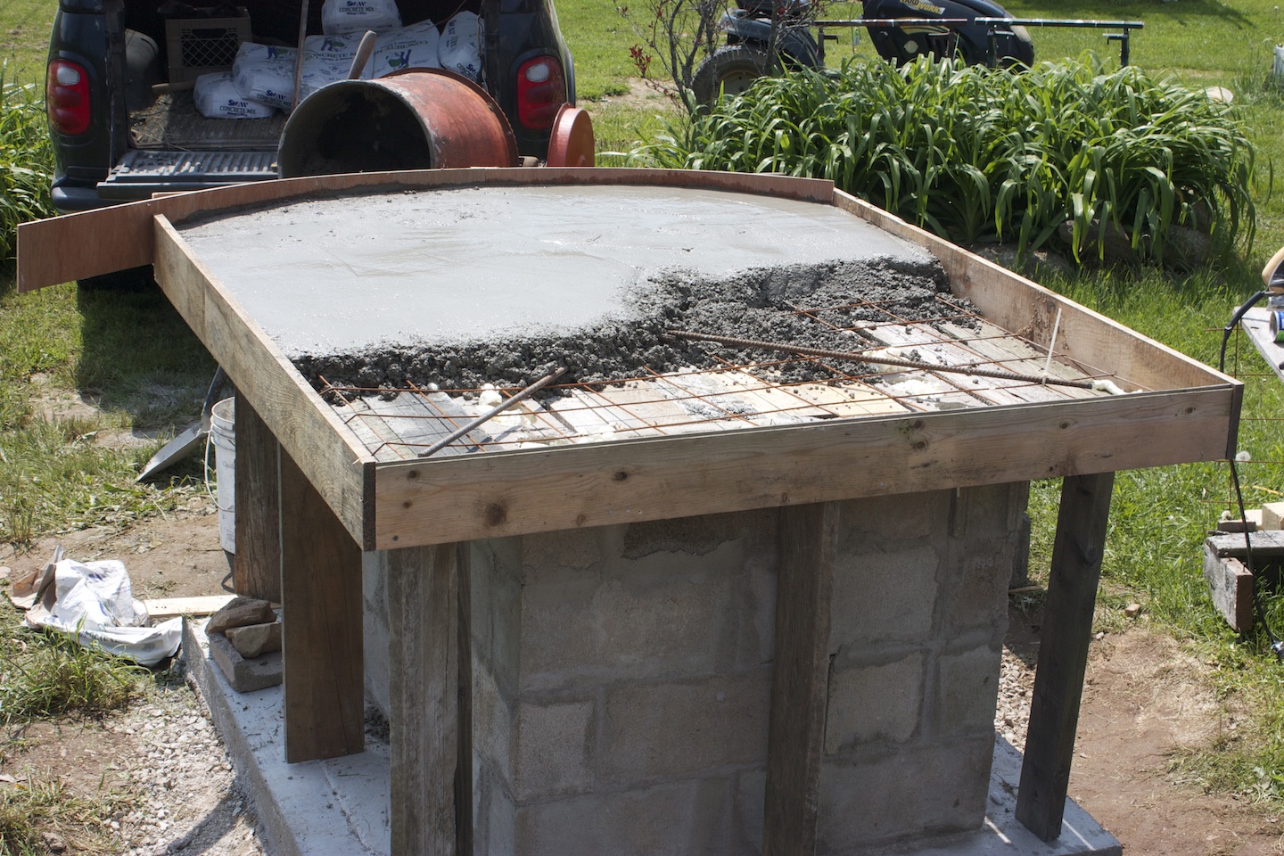

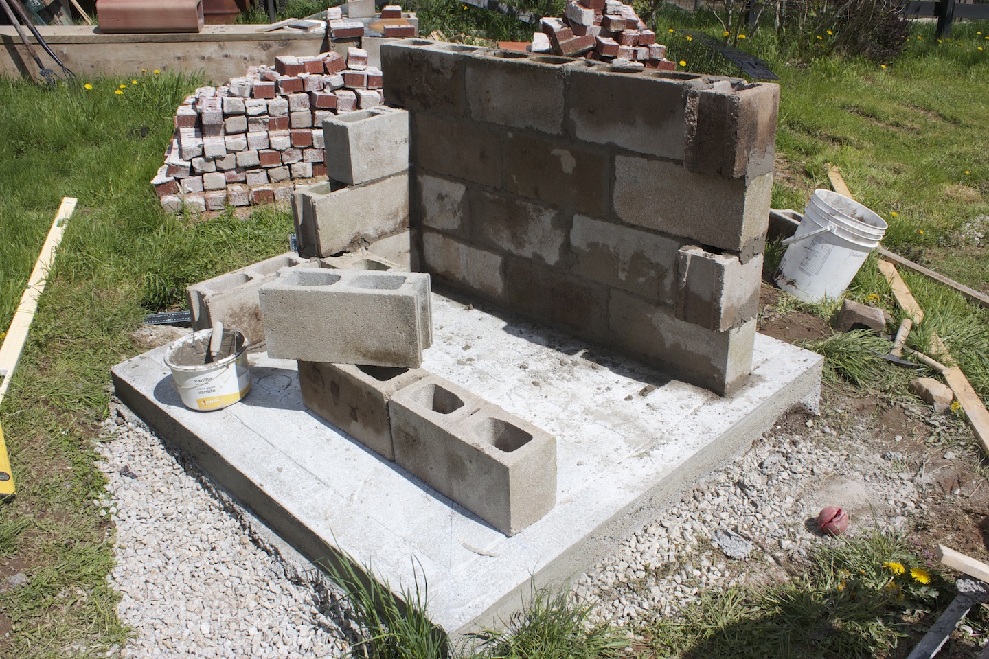

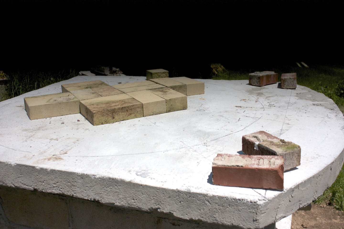

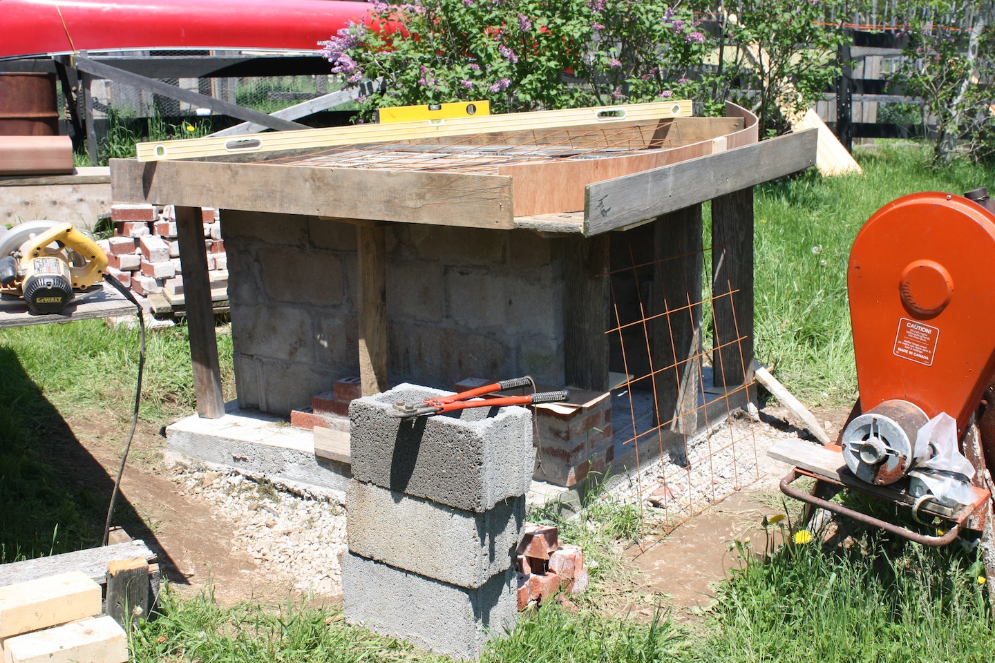

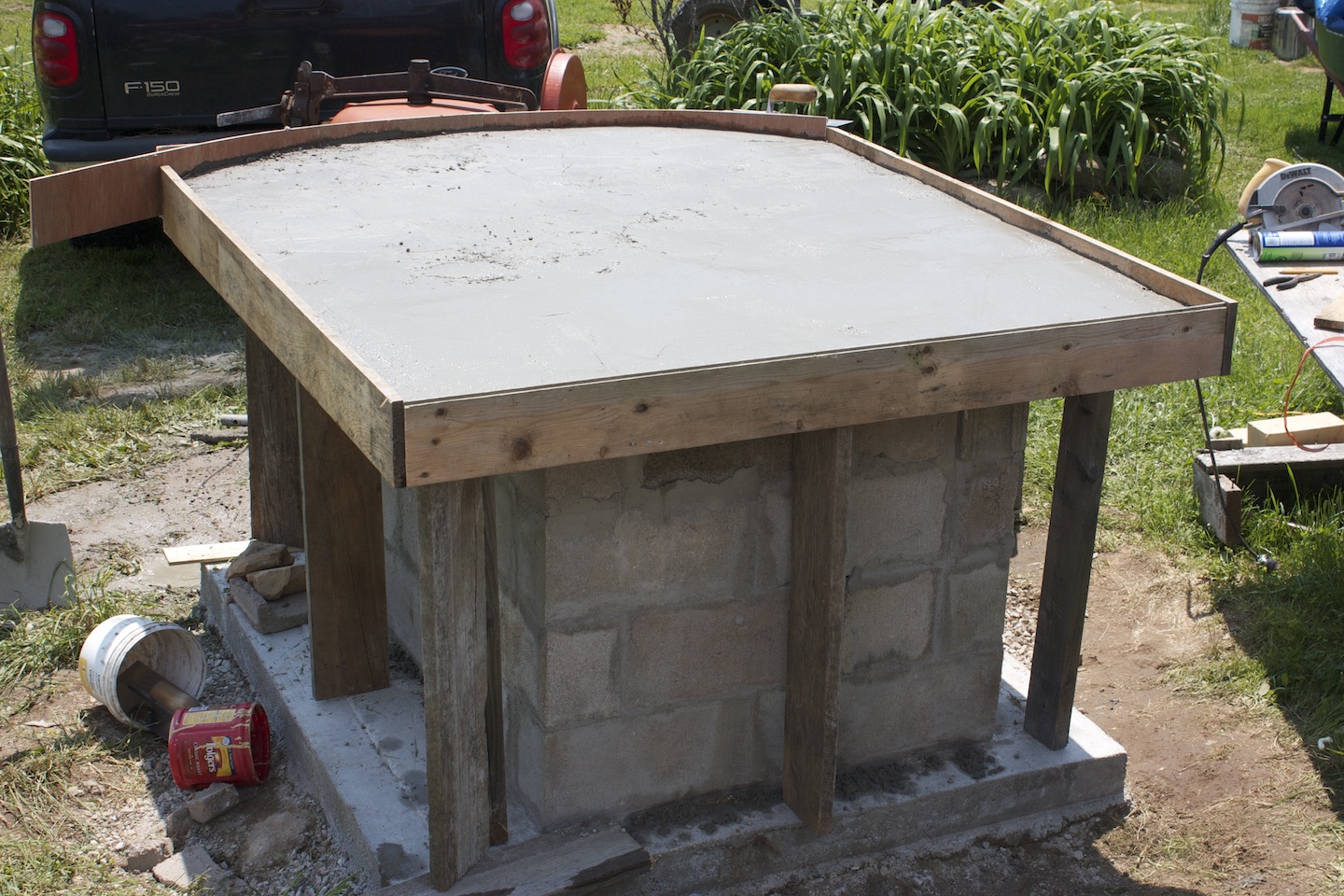

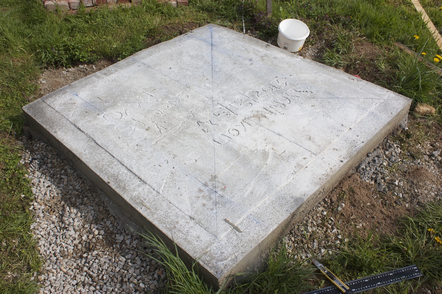

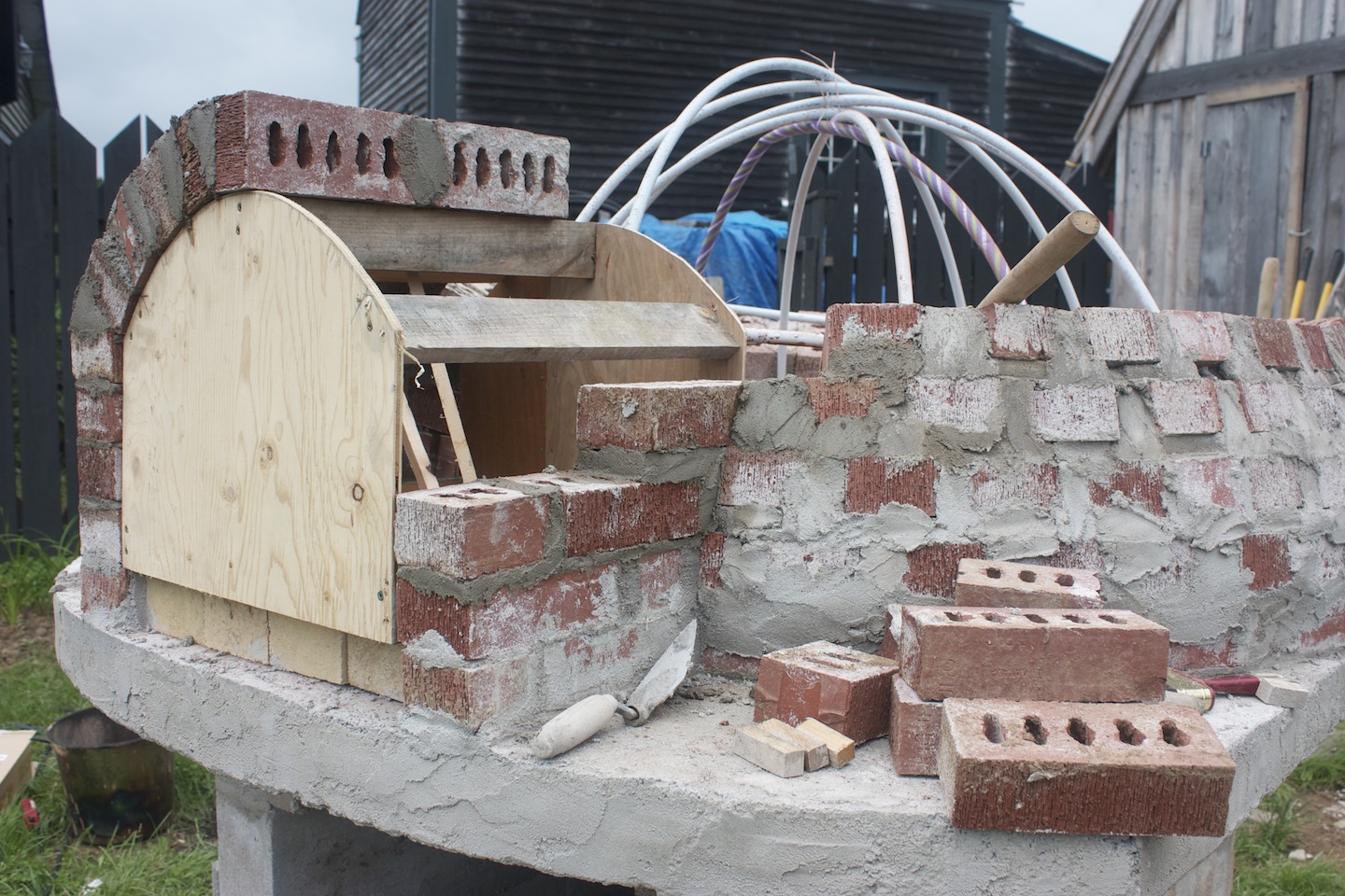

Here is a visual tour of Bake Oven build... enjoy. Still lots of detail work to complete.

Are there two openings to the oven? Trying to figure out how you would build a fire and clean up the ashes. :D:D:D

Have you started drying fires yet?

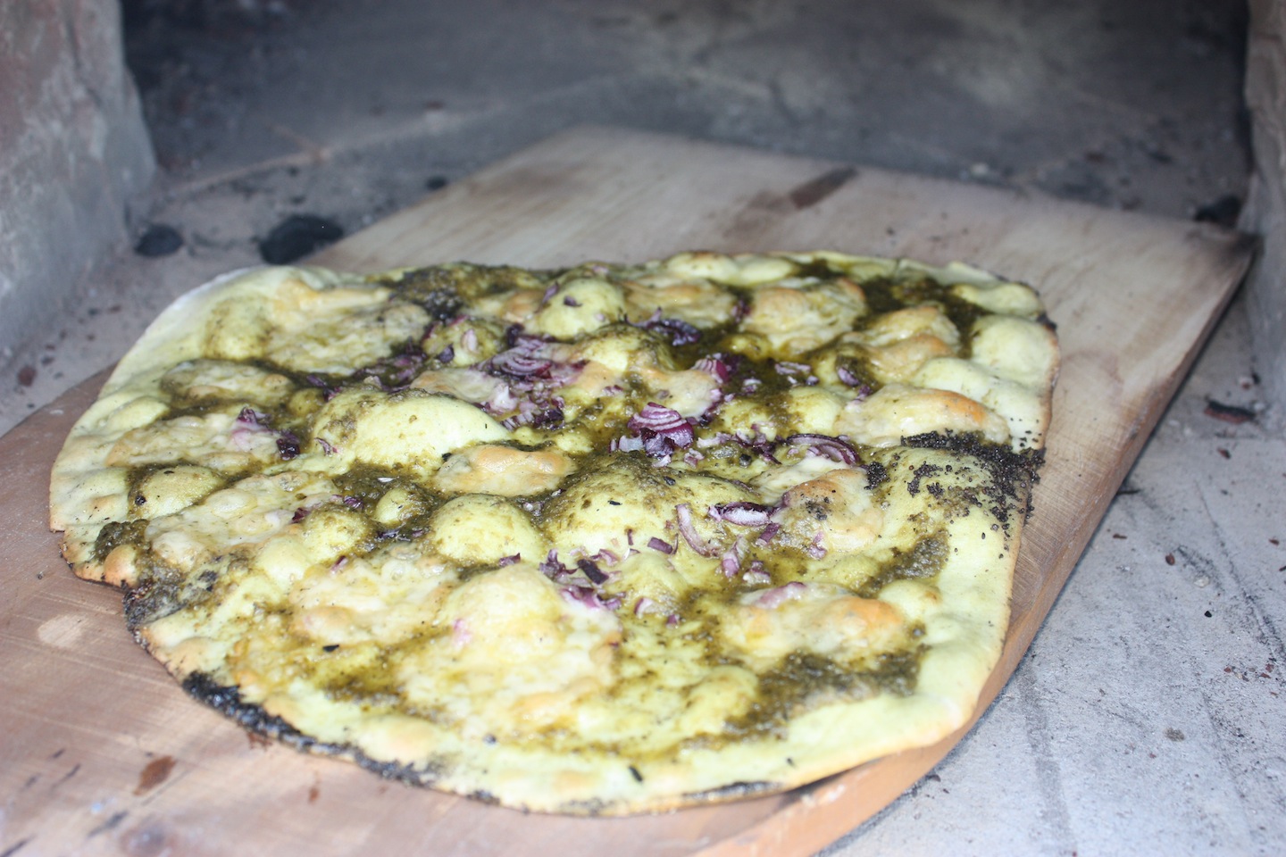

I look forward to seeing some product out of that oven. Here's some of what comes out of mine.

   / Bricks 2
Egon... you make the beer from the grain... I will be you back!
Polo... this has been a long work in progress. Did only 3 drying fires. Did our first pizza tonight as a test. 420 degree space... should have 6-700.
Your bread looks too good to eat!!!! My mom was an amazing bread maker... unfortunately I didn't pick up on her skill. I my ask my elderly neighbour to come and give me a few days or weeks of tutoring... or fly you up!
Dan, you build the fire and push the coals to the outside area of the oven. once it cools you can pull the ash out. Need to make a tool for that!
I still need to make a stainless steel peel and a door plus finish some detail work.
Thanks all...

Takes a good long time to dry them out, keep after it you'll get there. It should perform a bit better every time.
You can buy a lot of tools on line or you can make them. If I make pizza, I push some fire to the side like you do, and pull any extra coals out. I've seen some people modify a garden hoe to do this. I'll then use a 3' length of 1/2" copper tubing and blow and residual ash to the back of the oven. Remember not to suck back in after blowing:laughing:
If you decide to make or buy a pizza peel you'll wnat a metal perforated pizza peel. Google it and you'll see what I mean.
I think pizza is the toughest thing to make, most people with wood fired ovens pride themselves on being able to cook a pizza in 1 to 1.5 minutes. If you are going to do this you have to have the oven at 800 to 900 F. At that temperature your technique has to be real good, and the dough has to be made just right to keep it from burning on the bottom before the top is done.
Baking bread is easy, once you try it you'll see. I've been baking bread for a local restaraunt for about 9 months now. I bake 12 to 24 loaves of sourdough per week. Each loaf is 2 lbs. Let me know when you want to try it and I'll give you some pointers.
Good luck, everything you made looks great.
