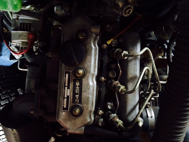

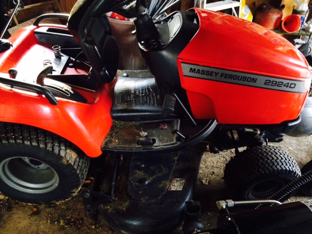

I recently purchased a Massey Ferguson 2924, I was looking at simplicity and was told this was the same tractor. Is that correct? It's a 24.5 hp Briggs diesel 2wd 60" deck
I used it twice no problems plenty of power great cut super pleased...... Then I was mowing for 15 mins it started sputtering like it wasn't getting gas. I live on a hill, it doesn't seem to matter what side I'm mowing on, or even whether it's on even ground. One it starts you have to cut off the pto to even keep it running and regardless of the throttle position it barely runs and the rpms go to zero. Then all of the sudden it surges a couple of time and a few minutes later everything comes back but it last for a few minutes. This has happen 3 times now after about 15 mins. I have tried to push the diesel primer on top of the filter when it happens but its very hard , so I assume that there is pressure there. I've been thinking of changing the fuel filter but when I took it off I was surprised it was a cartridge, but it did look white. Any sugguestions

So itappears for now the problem is resolved. I put a little diesel clean in the tank and I took the gas cap off and slammed it off the black top. Hasn't happened again yet. Keeping finger crossed and knocking on wood.

Re. your original question - post some pics of your machine - always a hit on TBN, and somebody may comment about Simplicity, from the pictures....

yeah still going strong ill get pics up soon
