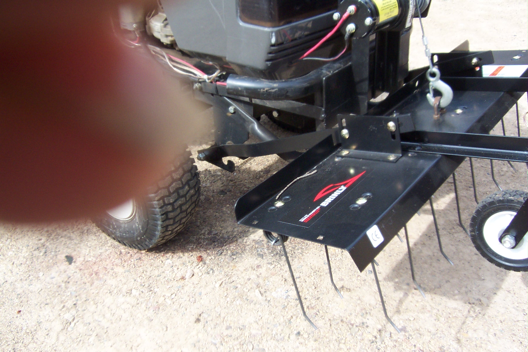

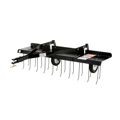

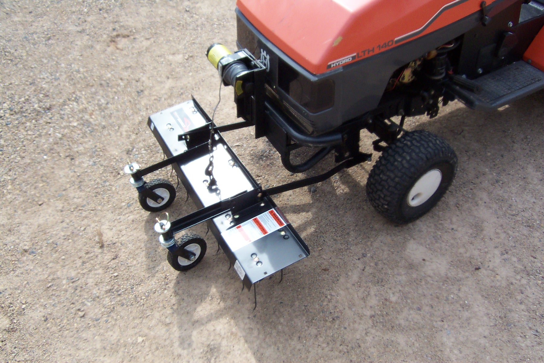

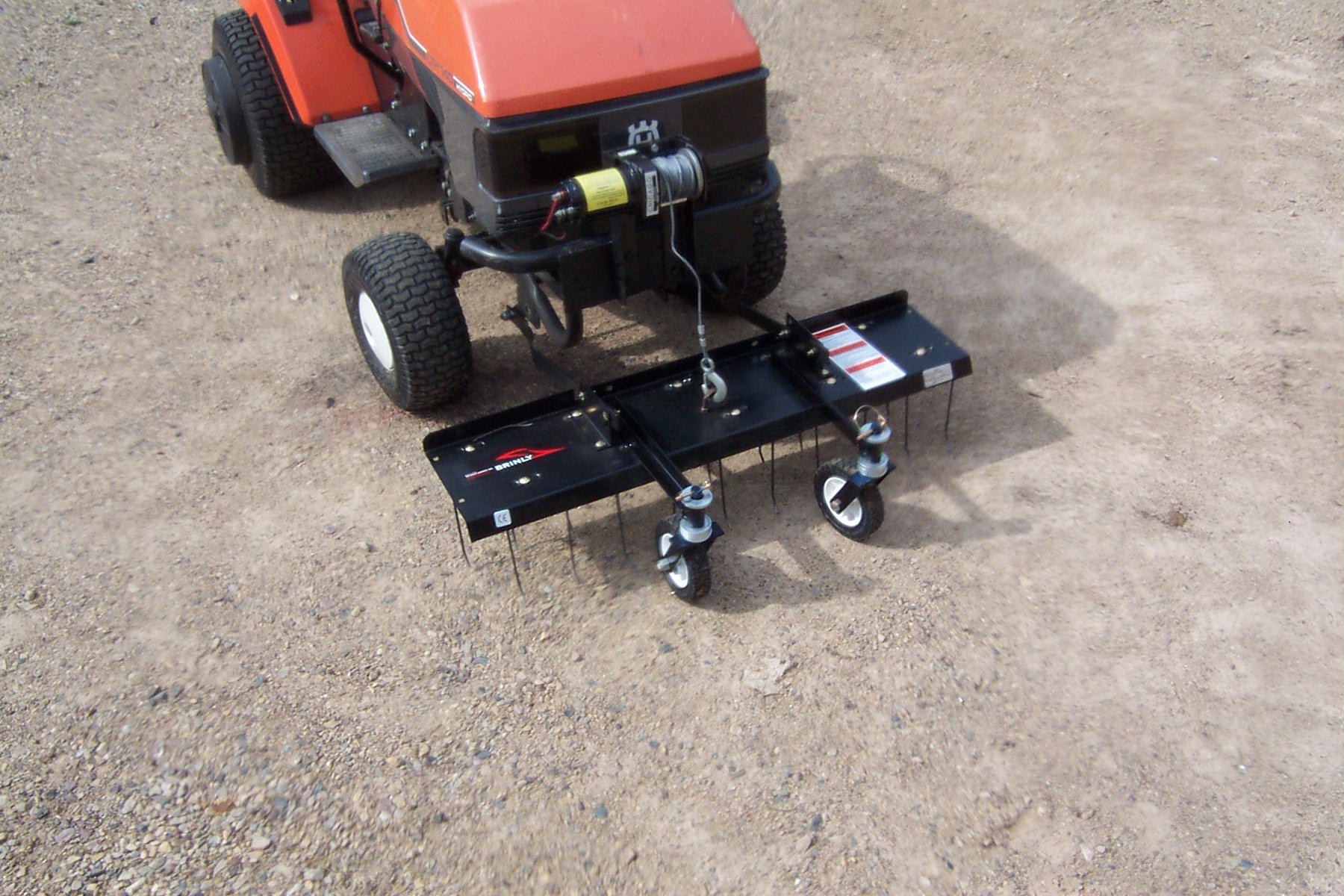

I wanted a front mount thatcher for my lawn tractor. The cheapest was for an Agri-fab at about 150.00 or higher. I decided to buy a Brinly-Hardy rear pull at 59.00 and modify it to work in the front. I was able to use most of the bars and such but I did have to make brackets so the wheels would swivel. I already had a winch on the front, so I just installed a u-bolt to raise and lower the unit.
The first picture is what it used to look like and the rest is what it looks like now.
