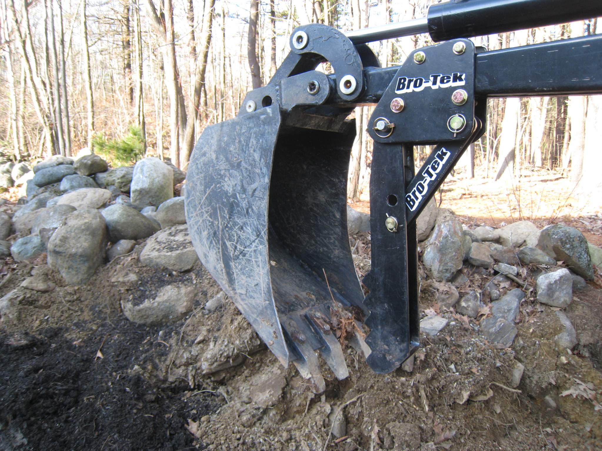

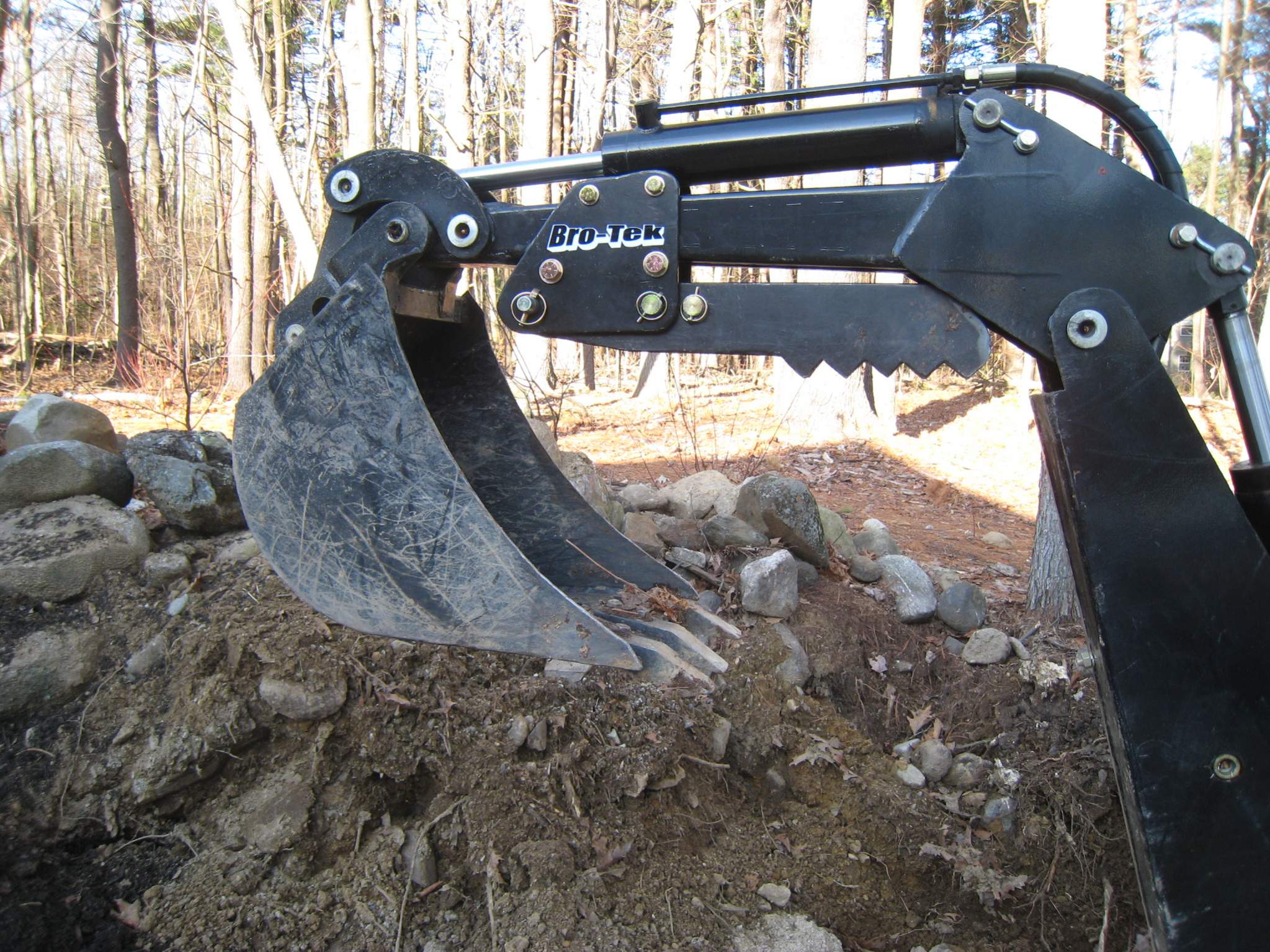

My new Bro-Tek Thumb thumb is working great.
Attached are a few pictures. The first one shows how nicely it folds up and fits under the dipper. The second one shows the high quality hardware and the third one shows how the link is adjustable for two positions.

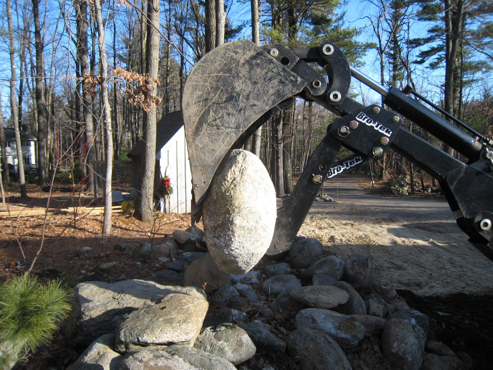

   / Bro-Tek Thumb for Chinese 7 Foot HW04X Backhoe
The thumb is becoming my best friend for cutting firewood because it easily picks up or moves the log for cutting to length. It's better than a portable sawhorse :)
Moving a stone wall is now a lot easier. It's no problem to just pick up the stones one by one and put them where I want them.

Hey, very nice Steve.
Looks like you did a nice job installing it too. Did you modify the tips of the thumb to go inside your bucket after all?

Rob -
Thanks for the compliment but it all goes to Bro-Tek because they are responsible for this neat compact design.
The working tip of the thumb is designed to fit nicely under the dipper and slip into the boom cavity when both the boom and dipper are folded up. If we shortened the thumb much more, the link would not fit inside the thumb when folded because it would interfere with the solid stiffening inside the thumb itself.
Sure we could have shortened it more so that the bucket could fully close over the thumb but then we'd need a solution for storage of the link.
