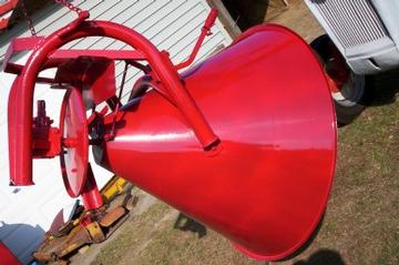

I use a cone style spreader for all my 20-70 hp tractors.. same one fits all of them fine.
Soundguy
