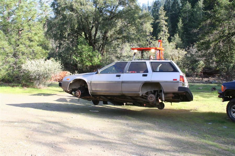

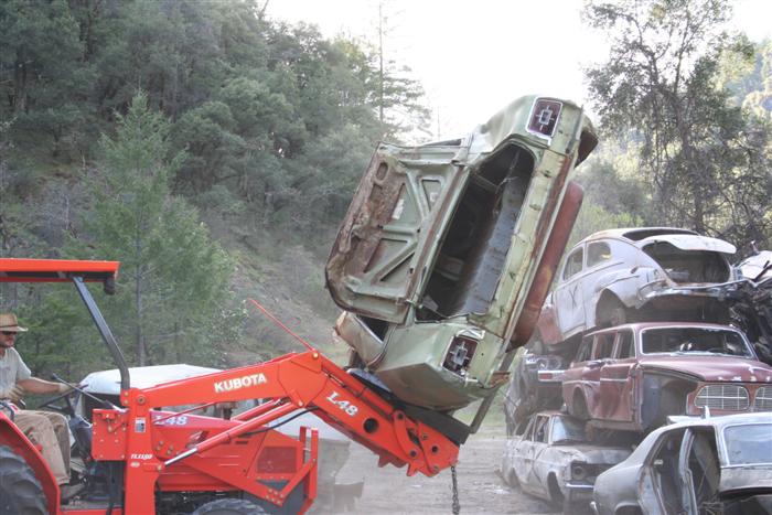

Quick Attack is the greatest thing since sliced bread! I personally use the bucket and forks numerous times throughout the day switching back and forth very easy I also have the QA BH buckets and switching is a breeze. Bucket forks are not an option! their to weak/they reduce the load capacity.
I don't think it would matter if I had the gearmore QA or Bota the design is the same Bota actually looks stronger and is braced with bigger pieces. It comes down to how you use/abuse your machine. Of course unless you have a weak machine. I even ripped a fork off my fork asembly..... now thats abuse. Forks are fun and ive stacked many of these in the past........ just some of the fun you can have.
Now a better design is to be had in all and everything.
