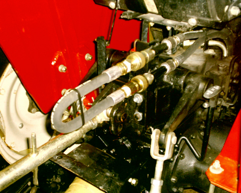

I was doing some bucket work with my 254 Jinma, and the auger on the post hole digger fetched up against something, and broke both ears off of the upper mount at the back of the tranny. Should I have them welded, or get a new rear tranny cover? If this is the better option, how many choices do I have to get the right part?

I'd be interested in a pic of the effected area.
soundguy
   / broken 3ph mount #8
Soundguy, here is what I broke and I am sure he is talking about the same thing. It is the back of the Hydro Tank. It is held on by 8 bolts and is a cast piece that has the ears or dogs that the top link mounts via a hitch pin. Here is a pic of my tractor, not broken now but had been with the auger incident, but you can see the part. It has a stop pin pressed in the backside of it which is the limit device for the 3 point lift piston and used a gasket to seal when bolted down and closed up the hydro tank. This piece also contains the drain plug for the hydro reservoir.

It may just be me.. but I'll bet that plate would have been better off being made from steel rather than CI.. unless it has some intricate machining done onthe back side.
those ears would have been alot tougher to break off ( not as brittle ).. had it been steel.. etc.
